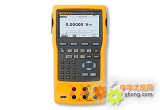

²úÆ·Ãû³Æ£º Fluke 753EL ¶à¹¦ÄÜУ׼ÒÇ/¹ý³ÌÐźÅУÑéÒÇ
ÐÍ ºÅ£º Fluke 753EL
µçÁ÷Ðźŷ¢ÉúÆ÷²âÁ¿¾«È·¶È
Ö±Á÷µçѹ
   1 Äê  2 Äê
100.000 mV        0.02%+0.005 mV  0.03%+0.005 mV
3.00000 V  0.02%+0.00005 V  0.03%+0.00005 V
30.0000 V  0.02%+0.0005 V  0.03%+0.0005 V
300.00 V  0.05%+0.05 V  0.07%+0.05 V
Ö±Á÷µçѹ
ϵÁÐ
40 ÖÁ 500 Hz
 ºÅ¾öÒé  1 Äê Äê
3.000 V  0.001 V  0.5%+0.002 V  1.0%+0.004 V
30.00 V  0.01 V  0.5%+0.02 V  1.0%+0.04 V
300.0 V  0.1 V  0.5%+0.2 V  1.0%+0.2 V
Ö±Á÷µçѹ
   1 Äê  2 Äê
30.000 mA          0.01% + 5 uA   0.015%+7 uA
110.00 mA  0.01% + 20 uA  0.015%+30 uA
µç×è
   1 Äê  2 Äê
10.000 Ω             0.05% + 50 mΩ  0.07%+70 mΩ
100.00 Ω  0.05% + 50 mΩ  0.07%+70 mΩ
1.0000 kΩ   0.05% + 500 mΩ  0.07%+0.5 Ω
10.000 kΩ  0.1% + 10 Ω  0.15%+15 Ω
ƵÂÊ
   ºÅ¾öÒé  ¾«¶È (2 Äê)
1.00 ÖÁ 110.00 Hz  0.01 Hz  0.05 Hz
110.1 ÖÁ 1100.0 Hz  0.1 Hz  0.5 Hz
1.101 ÖÁ 11.000 kHz   0.001kHz  0.005 kHz
11.01 ÖÁ 50.00 kHz  0.01 kHz  0.05 kHz
µçÁ÷Ðźŷ¢ÉúÆ÷Êä³ö¾«È·¶È
Ö±Á÷µçѹ
   1 Äê  2 Äê
100.000 mV            0.01%+0.005 mV  0.015%+0.005 mV
1.00000 V  0.01%+0.00005 V  0.015%+0.0005 V
15.0000 V  0.01%+0.0005 V  0.015%+0.0005 V
Ö±Á÷µçÁ÷
   1 Äê 2 Äê
22.000 mA (Ô´)  0.01%+ 0.003 mA  0.02%+ 0.003 mA
µ±Ç°½ÓÊÕÆ÷ (Ä£Äâ)  0.02% + 0.007 mA  0.04% + 0.007 mA
µç×è
   1 Äê  2 Äê
10.000 Ω                0.01% + 10 mΩ  0.015% + 15 mΩ
100.00 Ω  0.01% + 20 mΩ  0.015% + 30 mΩ
1.0000 kΩ  0.02% + 0.2 Ω  0.03% + 0.3 Ω
10.000 kΩ  0.02% + 3 Ω  0.03% + 5 Ω
ƵÂÊ
   2 Äê
0.1 ÖÁ 10.99 Hz  0.01 Hz
0.01 ÖÁ  10.99 Hz  0.01 Hz
11.00 ÖÁ  109.99 Hz  0.1 Hz
110.0 ÖÁ  1099.9 Hz  0.1 Hz
1.100 ÖÁ  21.999 kHz  0.002 kHz
22.000 ÖÁ  50.000 kHz
 0.005 kHz
¼¼ÊõÊý¾Ý
Êý¾Ý¼Ç¼¹¦ÄÜ
²âÁ¿¹¦ÄÜ: µçѹ¡¢µçÁ÷¡¢µç×衢ƵÂÊ¡¢Î¶ȡ¢Ñ¹Á¦
¶ÁÊýËÙÂÊ:  1, 2, 5, 10, 20, 30, »ò 60 ´Î/·ÖÖÓ
×î´ó¼Ç¼³¤¶È:    8000 ¸ö¶ÁÊý£¨¶ÔÓÚ 30 »ò 60 ´Î/·ÖÖÓ£¬Îª 7980 ¸ö£©
бÆÂ¹¦ÄÜ
Êä³ö¹¦ÄÜ:    µçѹ¡¢µçÁ÷¡¢µç×衢ƵÂÊ¡¢Î¶È
ËÙÂÊ:  4 ²½/Ãë
ÌøÕ¢¼ì²â:
Á¬ÐøÐÔ»òµçѹ£¨Êä³öµçÁ÷ʱ£¬ÎÞ·¨½øÐÐÁ¬ÐøÐÔ¼ì²â£©
»ØÂ·µçÔ´¹¦ÄÜ
µçѹ:  ¿ÉÑ¡, 26 V
¾«È·¶È:  10%, 18 V Ê±×îСֵΪ 18 V
×î´óµçÁ÷:  25 mA, ¶Ì·±£»¤
×î´óÊäÈëµçѹ:  Ö±Á÷ 50 V
²½½ø¹¦ÄÜ
Êä³ö¹¦ÄÜ
ÊÖ¶¯²½½ø   ¿ÉÑ¡²½½ø£¬Ê¹ÓüýÍ·°´Å¥½øÐиü¸Ä
×Ô¶¯²½½ø  º¯Êý¡¢Æð¶¯ÑÓʱ¡¢²½½øÖµ¡¢²½½øÊ±¼ä¡¢Ñ­»·µÈ¿ÉÍêÈ«±à³Ì
»·¾³¹æ¸ñ
µçÁ÷Ðźŷ¢ÉúÆ÷¹¤×÷ζÈ
   -10 °C ÖÁ +50 °C
´¢´æÎ¶È
   -20 °C ÖÁ +60 °C
·À³¾/·ÀË®
   ·ûºÏ IP52, IEC 529
¹¤×÷º£°Î
   Æ½¾ùº£Æ½ÃæÖ®ÉÏ 3000 Ã×£¨9842 Ó¢³ß£©
°²È«¹æ¸ñ
»ú¹¹ÈÏÖ¤
   CAN/CSA C22.2 No 1010.1-92, ASNI/ISA S82.01-1994, UL3111, ºÍ EN610-1:1993
»úеºÍͨÓùæ¸ñ
µçÁ÷Ðźŷ¢ÉúÆ÷´óС
   136 x 245 x 63 mm (5.4“ x 9.6 x 2.5)
µçÁ÷Ðźŷ¢ÉúÆ÷ÖØÁ¿
   1.2 kg (2.7 lb)
µç³Ø
ÄÚ²¿ï®Àë×Óµç³Ø×é:    7.2V, 4400mAh, 30 Wh
µç³ØÊÙÃü
   Í¨³£´óÓÚ 8 Ð¡Ê± l
¸ü»»µç³Ø
ͨ¹ý°´´¥Ê½¿ª¹Ø´ò¿ª£¬ÎÞÐè´ò¿ªÐ£×¼Æ÷£¬Ò²ÎÞÐèʹÓÃÆäËû¹¤¾ß
²à¶Ë¿ÚÁ¬½Ó
   Ñ¹Á¦Ä£¿éÁ¬½ÓÆ÷
   ½«½Ó¿ÚÓë PC ÏàÁ¬µÄ USB Á¬½ÓÆ÷
   ¿ÉÑ¡µç³Ø³äµçÆ÷/Ïû³ýÆ÷µÄÁ¬½Ó
Êý¾Ý´æ´¢ÈÝÁ¿
   1 ÖܵÄУ׼³ÌÐò½á¹û
90 Ìì¹æ¸ñ
  750EL ϵÁеıê×¼¹æ¸ñ¼ä¸ôÊÇ 1 ÄêºÍ 2 Äê¡£
   90 ÌìµäÐͲâÁ¿ºÍÊä³ö¾«È·¶È¿ÉÒÔͨ¹ýÒÔÏ·½Ê½¹ÀËã
   ½«Ò»Äê“¶ÁÊý°Ù·Ö±È»ò“Êä³ö°Ù·Ö±È¹æ¸ñ³ýÒÔ 2¡£
   ×îµÍ¹æ¸ñ±íʾΪ“ÂúÁ¿³Ì°Ù·Ö±È»òÕß Á¬Ðø“¼ÆÊý»ò“Å·Ä·Öµ¡£
