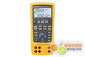

²úÆ·Ãû³Æ£º Fluke 726 ¸ß¾«¶È¶à¹¦Äܹý³ÌУ׼Æ÷
ÐÍ ºÅ£º Fluke 726
²âÁ¿¾«¶È
Ö±Á÷µçѹ
30.000 V  0.01%+ 2 counts£¨Éϲ¿ÏÔʾÆÁ£©
30.000 V  0.01%+ 2 counts£¨Ï²¿ÏÔʾÆÁ£©
100.00 mV  0.01%+ 2 counts
-10.00 mV ÖÁ 75.00 mV  0.025 % + 1 count£¨Í¨¹ý TC Á¬½ÓÆ÷£©
Ö±Á÷µçÁ÷
24.000 mA  0.01%+ 2 counts
µç×è
0.0 ÖÁ 4000.0 Ω  +/- 0.015%
ƵÂÊ
2.0 ÖÁ 1000.0 CPM  0.05 % + 0.1 count
1.0 ÖÁ 1000.0 Hz  0.05 % + 0.1 Hz
1.0 ÖÁ 15.0 kHz  0.05 % + 0.1 kHz
10.0 ÖÁ 15.0 kHz  0.05 % + 1 count
ÁéÃô¶È  1 V ·åÖµ-·åÖµ-×îСֵ
ѹÁ¦
׼ȷ¶È  Á¿³ÌµÄ 0.025%£¬Ê¹Óà 29 ¸öѹÁ¦Ä£¿éÖеÄÈκÎÒ»¸ö¡£
   £¨ÓйØÏêϸ¼¼ÊõÖ¸±ê£¬Çë²ÎÔÄÑ¡Åä¼þºÍ¸½¼þÖеÄѹÁ¦Ä£¿é£©
   ÌṩÁËÓÃÓÚ²îѹ¡¢±íѹ¡¢Õæ¿ÕѹÁ¦¡¢¾ø¶ÔѹÁ¦¡¢Ë«Ñ¹ºÍ¸ßѹµÄÄ£¿é¡£
Êä³ö׼ȷ¶È
Ö±Á÷µçѹ
100.00 mV  0.01% + 2 counts
10.000 V  0.01% + 2 counts
Ö±Á÷µçÁ÷
24.000 mA£¨Êä³ö£©  0.01%+ 2 counts
24.000 mA£¨Ä£Ä⣩  0.01%+ 2 counts
µç×è
Á¿³Ì  5 ÖÁ 400 Ω
   5 ÖÁ 400 Ω
   400 ÖÁ 1500 Ω
   1500 ÖÁ 4000 Ω
׼ȷ¶È  ¶ÁÊý°Ù·Ö±È + µ×Êý
   0.015% + 0.1 Ω
   0.015% + 0.05 Ω
   0.015% + 0.5 Ω
   0.015% + 0.5 Ω
¼¤ÀøµçÁ÷  0.1 ÖÁ 0.5mA
   0.5 ÖÁ 3mA
   0.05 ÖÁ 0.8 mA
   0.05 ÖÁ 0.4 mA
ƵÂÊ
2.0 ÖÁ 1000.0 CPM  0.05%
1.0 ÖÁ 1100.0 Hz  0.05%
1.00 ÖÁ 10.00 kHz  0.25%
10.0 ÖÁ 15.0 kHz  0.5%
²¨ÐÎ:
 5 V p-p ·½²¨£¬-0.1 V Æ«ÒÆ
RTDºÍÈȵçż
²âÁ¿ºÍÊä³ö׼ȷ¶È:
Cu10  1.8 °C
NI-120  0.15 °C
PT-100 (385)  0.25 °C
PT-100 (392)  0.15 °C
PT-100 (391-JIS)  0.25 °C
PT-200 (385)  0.75 °C
PT-500 (385)  0.35 °C
PT-1000 (385)  0.15 °C
·Ö±æÂÊ:  0.01 °C
J:  0.4 °C
K:  0.5 °C
T:  0.4 °C
E:  0.4 °C
R:  1.4 °C
S:  1.4 °C
B:  1.4 °C
L:  0.45 °C
U:  0.45 °C
N:  0.6 °C
XK:  0.4 °C
BP:  1.1 °C
·Ö±æÂÊ  J, K, T, E, L, N, U: 0.1 °C, 0.1 °F B, R, S: 1 °C, 1 °F
¼¼ÊõÖ¸±ê
б²¨ÐźÅ
Êä³öº¯Êý:  µçѹ¡¢µçÁ÷¡¢µç×衢ƵÂÊ¡¢Î¶È
бÆÂ  ÂýбÆÂ¡¢¿ìбÆÂ¡¢25% ½×ԾбÆÂ
»ØÂ·µçÔ´
µçѹ:  24 V
׼ȷ¶È:  10%
×î´óµçÁ÷:  22 mA£¬¶Ì·±£»¤
½×Ô¾ÐźÅ
½×Ô¾  Á¿³ÌµÄ 25%¡¢100%
»·¾³²ÎÊý:
¹¤×÷ζÈ
   -10 °C ÖÁ +55 °C
´¢´æÎ¶È
   -20 °C ÖÁ +71 °C
ÔËÐк£°Î¸ß¶È
   3000 m
°²È«¼¼Êõ²ÎÊý
»ú¹¹ÈÏÖ¤
   EN 61010-1:1993, ANSI/ISA S82.01-1994; CAN/CSA C22.2 No 1010.1:1992
»úеºÍÒ»°ã²ÎÊý
³ß´ç
   200mm x 96mm x 47mm (7.9 in x 3.8 in x 1.9 in)
ÖØÁ¿
   650 g (23 oz.)
µç³Ø
   4 ½Ú AA ¼îÐÔµç³Ø
µç³ØµÄ¸ü»»
   ·ÖÌåʽµç³Ø²Ö¸Ç£¬²»±ØÆÆ»µÐ£×¼ÃÜ·â¼´¿Éװж
²àÃæÁ¬½Ó¶Ë¿Ú
   Ñ¹Á¦Ä£¿éÁ¬½ÓÆ÷£¬»¹¿ÉÓÃÓÚÔ¶³Ìʵʱ±à³Ì
