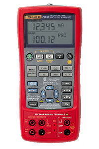

²úÆ·Ãû³Æ£º 725Ex ±¾°²ÐͶ๦Äܹý³ÌУ׼Æ÷/УÑéÒÇ
ÐÍ ºÅ£º 725Ex ±¾°²ÐÍ
œyÁ¿¾«¶È
Ö±Á÷늉º
30.000 V  0.02%+ 2 Î»Ôª (upper display)
10.000 V  0.02%+ 2 Î»Ôª (lower display)
90.00 mV  0.02%+ 2 λԪ
-10.00 mV ÖÁ 75.00 mV  0.025 % + 1 Î»Ôª (via TC connector)
Ö±Á÷ëŠÁ÷
24.000 mA  0.02%+ 2 λԪ
ëŠ×è
0.0 ÖÁ 400.0 Ω  0.1Ω (4¾€), 0.15Ω (2¾€ºÍ3¾€)
401 ÖÁ 1500 Ω  0.5Ω (4¾€), 1Ω (2¾€ºÍ3¾€)
1500 ÖÁ 3200 Ω  1Ω (4¾€), 1.5Ω (2¾€ºÍ3¾€)
îlÂÊ
2.0 ÖÁ 1000.0 CPM  0.05 % + 1 λԪ
1.0 ÖÁ 1100.0 Hz  0.05 % + 1 λԪ
1.00 ÖÁ 10.00 kHz  0.05 % + 1 λԪ
ì`Ãô¶È  1 V peak-to-peak-minimum
‰ºÁ¦
œÊ´_¶È  from 0.025% of range using any of 8 intrinsic safe pressure modules.
   (for detailed specifications refer to pressure modules in options and accessories)
   Modules available for differential, gauge, vacuum, absolute, dual and high pressure.
Ý”³öœÊ´_¶È
Ö±Á÷늉º
100.00 mV  0.02%+2 λԪ
10.000 V  0.02%+2 λԪ
Ö±Á÷ëŠÁ÷
24.000 mA (Ý”³ö)  0.02%+ 2 λԪ
24.000 mA (Simulate)  0.02%+ 2 λԪ
ëŠ×è
15.0 ÖÁ 400.0 Ω  0.15 Ω (exc. current 0.15 ÖÁ 0.5 mA), 0.1 Ω (exc. current 0.5 to 2 mA)
401 ÖÁ 1500 Ω  0.5 Ω(excitation current 0.05 ÖÁ 0.8 mA)
1500 ÖÁ 3200 Ω  1 Ω(excitation current 0.05 ÖÁ 0.4 mA)
îlÂÊ
2.0 ÖÁ 1000.0 CPM  0.05%
1.0 ÖÁ 1100.0 Hz  0.05%
1.00 ÖÁ 10.00 kHz  0.25%
²¨ÐÎ:  5 V p-p ·½²¨, -0.1 V offset
RTDºÍŸáëŠÅ¼
œyÁ¿¾«´_¶È:
NI-120  0.2 °C
PT-100 (385)  0.33 °C
PT-100 (393)  0.3 °C
PT-100 (JIS)  0.3 °C
PT-200 (385)  0.2 °C
PT-500 (385)  0.3 °C
PT-1000 (385)  0.2 °C
½âÎö¶È:  0.1 °C
J:  0.7 °C
K:  0.8 °C
T:  0.8 °C
E:  0.7 °C
R:  1.8 °C
S:  1.5 °C
B:  1.4 °C
L:  0.7 °C
U:  0.75 °C
N:  0.9 °C
½âÎö¶È  J, K, T, E, L, N, U: 0.1 °C, 0.1 °F B, R, S: 1 °C, 1 °F
XK  0.6°C
BP  1.2°C
Ý”³öœÊ´_¶È:
NI-120  0.2 °C
PT-100 (393)  0.3 °C
PT-100 (JIS)  0.3 °C
PT-200 (385)  0.2 °C
PT-500 (385)  0.3 °C
½âÎö¶È:  0.1 °C
×¢:  Accuracy stated for 4-wire measurement.
J:  0.7 °C
K:  0.8 °C
T:  0.8 °C
E:  0.7 °C
R:  1.4 °C
S:  1.5 °C
B:  1.4 °C
L:  0.7 °C
U:  0.75 °C
N:  0.9 °C
½âÎö¶È  J, K, T, E, L, N, U: 0.1 °C, B, R, S: 1 °C
XK  0.6°C
BP  1.2°C
¼¼ÐgÖ¸˜Ë
б²¨ÐÅÌ–
Ý”³ö¹¦ÄÜ:  Voltage, current, resistance, frequency, temperature
Ramps  Slow ramp, Fast ramp, 25% step-ramp
ޒ·ëŠÔ´
Voltage:  12 V
Accuracy:  10%
Maximum current:  22 mA, short circuit protected
ëAÜSÐÅÌ–
²½ßM  25% of range, 100% of range
°²È«¼¼Ðg…¢”µ
