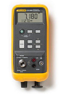

²úÆ·Ãû³Æ£º Fluke 718 ϵÁÐѹÁ¦Ð£×¼Æ÷| ѹÁ¦Ð£ÑéÒÇ
ÐÍ ºÅ£º Fluke 718
¼¼ÊõÖ¸±ê
ѹÁ¦Ð£ÑéÒDZê×¼
718 ϵÁÐ
²âÁ¿Ñ¹Á¦  £¨ÄÚÖô«¸ÐÆ÷£©
׼ȷ¶È  0.025% Âú¶È
¹¦ÄÜ  ¹éÁã¡¢×îСֵ/×î´óÖµ¡¢±£³Ö¡¢×èÄá
×¢:   ½öÏÞ¸ÉÔï¡¢·Ç¸¯Ê´ÐÔ¿ÕÆø
718 1G
Á¿³Ì:  -1 PSI ÖÁ +1 PSI£¬-68.9 mbar ÖÁ 68.9 mbar£¨-6.89 kPa ÖÁ 6.89 kPa£©
·Ö±æÂÊ:  0.0001 PSI£¬0.001 mbar£¬0.0001 kPa
¹ýѹ:  5 X Âú¶È
¹¦ÄÜ:  ¹éÁã¡¢×îСֵ¡¢×î´óÖµ¡¢±£³Ö¡¢×èÄá
718 30G
Á¿³Ì:  -12 PSI ÖÁ 30 PSI£¬£¨-850 mbar ÖÁ 2 bar£¬-85 ÖÁ 206.84 kPa£©
·Ö±æÂÊ:  0.001 PSI£¬0.1 mbar£¬0.01 kPa
¹ýѹ:  5 X Âú¶È
718 100G
Á¿³Ì:  -12 PSI ÖÁ 100 PSI£¬£¨-850 mbar ÖÁ 7 bar£¬-85 ÖÁ 689.48 kPa£©
·Ö±æÂÊ:  0.01 PSI£¬0.1 mbar£¬0.01 kPa
¹ýѹ:  2 X Âú¶È
718 300G
Á¿³Ì:  -12 PSI ÖÁ 300 PSI£¬£¨-850 mbar ÖÁ 20 bar£¬-85 ÖÁ 2068.42 kPa£©
·Ö±æÂÊ:  0.01 PSI£¬1 mbar£¬0.1 kPa
¹ýѹ:  375 PSI 25 bar
²ÉÓà 700 ϵÁÐѹÁ¦Ä£¿éµÄ Fluke 718 Ñ¹Á¦Ð£ÑéÒÇϵÁÐ
Á¿³Ì:  29 ¿îѹÁ¦Ä£¿é£¬0 – 1 in H20 ÖÁ 10,000 PSI£¬2.5 mbar ÖÁ 700 bar¡£ ¹ýѹ±£»¤·ûºÏѹÁ¦Ä£¿é¼¼ÊõÖ¸±ê
·Ö±æÂÊ:  ·ûºÏѹÁ¦Ä£¿é¼¼ÊõÖ¸±ê
׼ȷ¶È:  ×î¸ß 0.025 % Âú¶È£¬·ûºÏѹÁ¦Ä£¿é¼¼ÊõÖ¸±ê
   ×¢: ½éÖʼæÈÝÐÔ·ûºÏ·ûºÏѹÁ¦Ä£¿é¼¼ÊõÖ¸±ê
²ÉÓÃÄÚÖÃ±ÃµÄ Fluke 718 Ñ¹Á¦Ð£ÑéÒÇϵÁÐ
Á¿³Ì:  -12 PSI »ò -850 mbar ÖÁÂú¶È Ö§³ÖѹÁ¦µ¥Î»: psi, in H20 (4 °C), in H20 (20 °C), cm H20 (4 °C), cm H20 (20 °C), bar, mbar, kPa, inHg, mmHg, kg/cm
»ØÂ·µçÔ´:  Á¿³Ì: 24 V dc
   ×¼È·¶È: +/- 10 %
   ×¢: Çý¶¯£»µç³Ø >6.8V ʱΪ 20 mA£¬1000 Ω£»µç³Ø 5.8 ÖÁ 6.8 V ʱΪ 700 Ω
ºÁ°²²âÁ¿:  Á¿³Ì: 0 mA ÖÁ 24 mA
   ·Ö±æÂÊ: 0.001 mA
   ×¼È·¶È: 0.015 % + 1 λÊý
Ò»°ã¼¼Êõ²ÎÊý
×î´óµçѹ
   30 ·ü: ·Ç²Ù×÷
ѹÁ¦Ð£ÑéÒÇζÈ
   -40 °C ÖÁ 60 °C
¹¤×÷ζÈ
   -10 °C ÖÁ 55° C
Ïà¶Ôʪ¶È
   95 %£¨10 °C ÖÁ 30 °C£©£»75 %£¨30 °C ÖÁ 40 °C£©£»45 %£¨40 °C ÖÁ 50 °C£©£»35 %£¨50 °C ÖÁ 55 °C£©
ÔËÐк£°Î¸ß¶È
   ×î¸ß 3,000 m
¿¹³å»÷ÐÔ
   1 Ã×Âä²î²âÊÔ
¿¹ÕñÐÔ
   Ëæ»ú£¬2 g£¬5 Hz – 500 Hz
°²È«
   CSA C22.2 No. 1010.1: 1992
EMC
   EN50082-1: 1992 ºÍ EN55022: 1994 Class B
ѹÁ¦Ð£ÑéÒdzߴç
   216 mm x 94 mm x 66 mm
ѹÁ¦Ð£ÑéÒÇÖØÁ¿
   992 g (35 oz)
µçÄÜ£¬µç³ØÊÙÃü
   9V ANSI/NEDA 1604A »ò IEC 6LR619V ¼îÐÔµç³Ø£»718 ϵÁдøÁ½½Úµç³Ø
ѹÁ¦Ð£ÑéÒÇµç³ØÊÙÃü
   4 ÖÁ 20 Сʱ£¨µäÐÍ£©£¬È¡¾öÓÚËùÓõŦÄÜ
±£ÐÞÆÚ
   ÈýÄ꣨Fluke 718 ÖеÄѹÁ¦±Ã±£ÐÞÒ»Ä꣩
ÏÔʾ
   Òº¾§ÏÔʾÆÁ£¬5 λÊý£¬Ñ¹Á¦ºÍµçÁ÷ͬ²½ÏÔʾ
