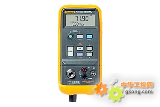

²úÆ·Ãû³Æ£º Fluke 719 ±ãЯʽ×Ô¶¯Ñ¹Á¦Ð£×¼Æ÷
ÐÍ ºÅ£º Fluke 719
Ò»°ã¼¼Êõ²ÎÊý
ѹÁ¦Ð£×¼Æ÷´¢´æÎ¶È
   -30 °C ÖÁ 60 °C
¹¤×÷ζÈ
   -10 °C ÖÁ 55 °C
Ïà¶Ôʪ¶È
   95 %£¨-10 °C ÖÁ 30 °C£©
   75 %£¨30 °C ÖÁ 40 °C£©
   45 %£¨40 °C ÖÁ 50 °C£©
   35 %£¨50 °C ÖÁ 55 °C£©
³å»÷
   1 Ã××¹Âä²âÊÔ
°²È«ÐÔ
   CSA C22.2 No. 1010.1:1992
EMC
   EN50082-1:1992 ºÍ EN55022:1994 Class B
ѹÁ¦Ð£×¼Æ÷³ß´ç (¸ßx¿íx³¤)
   60 mm x 87 mm x 210 mm
   (2.19 in x 3.41 in x 8.28 in)
ѹÁ¦Ð£×¼Æ÷ÖØÁ¿
   912 g (2 lb)
µç³Ø
   Á½½Ú 9 V ¼îÐÔµç³Ø
µç³ØÊÙÃü
   12 Сʱ£¨12 mA Á÷Èë 500 Ω¸ºÔØ£©£¬ Á¿³ÌΪ 689KPa (100 psi) ¿É½øÐÐ 200 ´ÎÆø±ÃÑ­»·£¬Á¿³ÌΪ 207KPa (30 psi) ¿É½øÐÐ 500 ´ÎÆø±ÃÑ­»·
±£ÐÞÆÚ
   Ñ¹Á¦Ð£×¼Æ÷ÈýÄê£¬Æø±ÃÒ»Äê
¼¼Êõ²ÎÊý
Fluke-719 30G ±ãЯʽ×Ô¶¯Ñ¹Á¦Ð£×¼Æ÷
Á¿³Ì  -83KPa(-12 psi) ÖÁ 248KPa(36 psi)£¬-850 mbar ÖÁ 2.4 bar
·Ö±æÂÊ  0.007KPa(0.001 psi)£¬0.1 mbar
¾«È·¶È  0.025 % Á¿³Ì£¬6 ¸öÔÂ
   0.035 % Á¿³Ì£¬1Äê
Fluke-719 100G ±ãЯʽ×Ô¶¯Ñ¹Á¦Ð£×¼Æ÷
Á¿³Ì  -83KPa(-12psi) ÖÁ 827KPa(120 psi)£¬-850 mbar ÖÁ 8 bar
·Ö±æÂÊ  0.07KPa(0.01 psi)£¬1 mbar
   0.035 % Á¿³Ì£¬1Äê
mA
Á¿³Ì  0 ÖÁ 24 mA
·Ö±æÂÊ  0.001 mA
¾«È·¶È  0.015 % ¶ÁÊý + 2¸ö×Ö
±¸×¢  ×î´ó¸ºÔØ1000 Ω£¬HART ģʽÏÂΪ750 Ω
»·Â·µçÔ´
Á¿³Ì  24 V dc
·Ö±æÂÊ  ÎÞ
¾«È·¶È  ± 10 %
±Ã¼¼Êõ²ÎÊý
×î¸ßÉú³ÉѹÁ¦
   120 PSI (8 BAR)£¨100 PSI ÐÍ£©
±ÃËÍ
   207KPa £¨30psi£©Ê±ÉÙÓÚ15Ãë*
   689KPa £¨100psi£©Ê±ÉÙÓÚ45Ãë*
   *£¨´ø 1 Ã× 1/8 in ²âÊÔÈí¹Ü£©
Á½´Î¼ìÐÞÖ®¼äµÄ±ÃÑ­»·´ÎÊý
   5000
×ܵıÃÊÙÃü
   20,000 ´ÎУ׼ѭ»·
