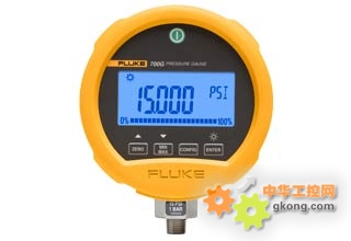

²úÆ·Ãû³Æ£º Fluke 700G ϵÁбãЯʽ¾«È·Ñ¹Á¦Ð£Ñé/У׼ÒÇ
ÐÍ ºÅ£º Fluke 700G
Fluke 700GϵÁÐѹÁ¦Ð£Ñé/У׼Òǹæ¸ñ
ÐͺÅ
Á¿³Ì
·Ö±æÂÊ
׼ȷ¶È
±¬ÁÑѹÁ¦
700G04
-14 ÖÁ 15 psi
-0.97 ÖÁ 1 bar
0.001 psi 0.0001 bar
ÕýѹÁ¦ ±0.05 % Âú¿Ì¶È
Õæ¿Õ ±0.1 % Âú¿Ì¶È
500 psi 34 bar
700G05
-14 ÖÁ 30 psi
-0.97 ÖÁ 2 bar
500 psi 34 bar
700G06
-12 ÖÁ 100 psi
-0.83 ÖÁ 6.9 bar
0.01 psi 0.0001 bar
1000 psi 69 bar
700G27
-12 ÖÁ 300 psi
-0.83 ÖÁ 20 bar
0.01 psi 0.001 bar
2000 psi 138 bar
700G07
-12 ÖÁ 500 psi
-0.83 ÖÁ 34 bar
0.01 psi 0.001 bar
2000 psi 138 bar
700G08
-14 ÖÁ 1000 psi
-0.97 ÖÁ 69 bar
0.1 psi 0.001 bar
10000 psi 690 bar
700G29
-14 ÖÁ 3000 psi
-0.97 ÖÁ 200 bar
0.1 psi 0.01 bar
10000 psi 690 bar
700G30
-14 ÖÁ 5000 psi
-0.97 ÖÁ 340 bar
0.1 psi 0.01 bar
10000 psi 690 bar
700G31
-14 ÖÁ 10000 psi
-0.97 ÖÁ 690
1 psi
0.01 bar
15000 psi 1035
ѹÁ¦Ð£Ñé/У׼ÒÇ»úе¹æ¸ñ
³ß´ç (HxWxD) 12.7 cm x 11.4 cm x 3.7 cm (5 in x 4.5 in x 1.5 in)
ѹÁ¦Á¬½Ó  ¼ in NPT Ñô½ÓÍ·£¬£¨Ìṩ 1/4 in NPT ÖÁ ¼ ISO ÊÊÅäÆ÷£©
Íâ¿Ç ÖýÌú ZNAL
ÖØÁ¿  0.56 kg, 1.22 lbs ´øÍâÌ×
ÏÔʾÆÁ  5-1/2 룬16.53 mm (0.65 in) ¸ß 20 ¶ÎÖù״ͼ£¬0 ÖÁ 100 %
µçÔ´ Èý½Ú AA ¼îÐÔµç³Ø
µç³ØÊÙÃü 1,500 СʱÎÞ±³¹â£¨³ÖÐøµãÁÁ£©£¬2,000 СʱµÍ²ÉÑùËÙ¶È
