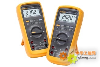

²úÆ·Ãû³Æ£º Fluke 27-II/28-II ¹¤ÒµÍòÓñí
ÐÍ ºÅ£º Fluke 27-II/28-II
׼ȷ¶È¼¼ÊõÖ¸±ê
DC µçѹ
Á¿³Ì  0.1 mV ÖÁ 1000 V
׼ȷ¶È  27-II:0.1 % +1
 28-II:0.05 % + 1
AC µçѹ
׼ȷ¶È  27-II: 0.5 % +3
 28-II: 0.7 % +4
DC µçÁ÷
Á¿³Ì  0.1 μA ÖÁ 10 A
׼ȷ¶È  27-II: 0.2 % + 4
 28-II: 0.2 % + 4
AC µçÁ÷
Á¿³Ì  0.1 μA ÖÁ10 A
׼ȷ¶È  27-II: 1.5 % + 2
 28-II: 1.0 % + 2
µç×è
Á¿³Ì  0.1 Ω ÖÁ 50 MΩ
ÏÔʾµãÊý
27-II  6000
28-II  6000/19,999
µçÈÝ
   1 nF ÖÁ 9999 μF
ƵÂÊ
   0.5 Hz ÖÁ 199.99 kHz
ζÈ
   27-II: N/A
 28-II: -200 °C ÖÁ +1090 °C
µÍͨÂ˲¨Æ÷£¨ VSD ²âÁ¿£©
   27-II: N/A
 28-II: Yes
ºÏ¹æ
   CAT IV 600 V , CAT III 1000V
IP µÈ¼¶
27-II:  IP 67
28-II:  IP 67
µçÔ´
   3 ½Ú AA µç³Ø
µç³ØÊÙÃü
   800 Сʱ
³£¹æ¼¼ÊõÖ¸±ê
ÏÔʾ
Ìõͼ / ±³¹â   ÊÇ / ÊÇ
Êý¾Ý´æ´¢
·åֵ˲ʱ²¶»ñ  250 μS (28 II)
×îСֵ / ×î´óÖµ / ƽ¾ùÖµ  ÊÇ
¶ÁÊý±£Áô  ÊÇ
ÆäËü¹¦ÄÜ
Ïà¹Ø¶ÁÊý£¨Á㣩  ÊÇ
µç³ØÀàÐÍ  3 ½Ú AA µç³Ø
±£Ð޺ͷÀ»¤
°²È«µÈ¼¶  CAT IV 600 V/CAT III 1000 V
Íⲿ·À»¤  Ï𽺻¤Ì×
ÂäÌå²âÊÔ  10 Ó¢³ßÂäÌå²âÊÔ
·À³¾ / ·ÀË®  ÊÇ£¬·ûºÏ IP 67 ¹æ¸ñ
±£ÐÞ  ÓÐÏÞÊÙÃü
³ß´ç£¨¸ßx¿íx³¤£©£¬º¬»¤Ì×  6.35 x 10.0 x 19.81 ÀåÃ×£¨2.5 x 3.93 x 7.8 Ó¢´ç£©
ÖØÁ¿£¨º¬»¤Ì×£©  698.5 ¿Ë£¨1.54 °õ£©
