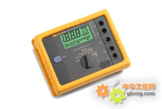

²úÆ·Ãû³Æ£º Fluke 1623-2 GEO ½ÓµØ²âÊÔÒÇ
ÐÍ ºÅ£º Fluke 1623-2 GEO
Ïêϸ¼¼ÊõÖ¸±ê
ͨÓÃ
ÏÔʾÆÁ£º1999 λҺ¾§ÏÔʾ ²ÉÓÃÌØÊâ·ûºÅÏÔʾ£¬Êýλ¸ß 25 mm£¬Ó«¹âµÆ±³¹âÔ´
Óû§½çÃæ ͨ¹ý TURN£¨Ðýת£©ºÍ START£¨Æô¶¯£©µ¥¼üÉè¼ÆÊµÏÖ¼´Ê±²âÁ¿¡£Î¨Ò»²Ù×÷Ôª¼þΪÐýת¿ª¹ØºÍ START£¨Æô¶¯£©°´Å¥¡£
¼á¹Ì¡¢·ÀË®¡¢·À³¾ ÒÇÆ÷רΪÑÏ¿ÁµÄ»·¾³Ìõ¼þ¶øÉè¼Æ£¨Ï𽺱£»¤¸Ç£¬IP56£©
´æ´¢Æ÷ ͨ¹ý USB ¶Ë¿Ú¿É·ÃÎÊÄÚ²¿´æ´¢Æ÷´æ´¢µÄ¶à´ï 1500 Ìõ¼Ç¼
ζȷ¶Î§
¹¤×÷ÎÂ¶È -10 °C ÖÁ 50 °C£¨14 °F ÖÁ 122 °F£©
´æ·ÅÎÂ¶È -30 °C ÖÁ 60 °C£¨-22 °F ÖÁ 140 °F£©
ζÈϵÊý ± ¶ÁÊýµÄ 0.1 % /°C <18 °C >28 °C
¹ÌÓÐÎó²î Çë²ÎÕÕ»ù׼ζȷ¶Î§£¬Ò»Äê±£Ö¤
²Ù×÷Îó²î Çë²ÎÕÕ¹¤×÷ζȷ¶Î§£¬Ò»Äê±£Ö¤
ÆøºòµÈ¼¶ C1 (IEC 654-1)£¬-5 °C ÖÁ +45 °C£¨23° ÖÁ +115° F£©£¬5 % ÖÁ 95 % RH
·À»¤ÀàÐÍ °´ÕÕ EN60529£¬¿ÇÌå·À»¤µÈ¼¶Îª IP56£»µç³Ø¸Ç·À»¤µÈ¼¶Îª IP40
°²È«ÐÔ ²ÉÓÃË«ÖØºÍ/»ò¼ÓÇ¿¾øÔµ±£»¤¡£¶ÔµØ×î´ó50 V¡£IEC61010-1: 300V CAT II£¬ÎÛȾµÈ¼¶ 2
EMC£¨·øÉ俹ÈÅÐÔ£© IEC61326-1£º±ãЯʽ
ÖÊÁ¿Ìåϵ °´ÕÕ DIN ISO 9001 ±ê×¼¿ª·¢¡¢Éè¼ÆºÍÉú²ú
Íⲿµçѹ ×î´óÍⲿµçѹ = 24 V£¨Ö±Á÷ºÍ½»Á÷ < 400 Hz£©£¬½ûÖ¹²âÁ¿¸ü¸ßÖµ
ÍⲿµçѹÒÖÖÆ±È >120 dB (162/3¡¢50¡¢60 ºÍ 400 Hz)
²âÁ¿Ê±¼ä ͨ³£Îª 6 Ãë
×î´ó¹ýÔØ 250 Vrms£¨ÊôÓÚÎóÓã©
¸¨ÖúµçÔ´ 6 x 1.5 V ¼îÐÔµç³Ø (AA LR6)
µç³ØÊÙÃü·¶Î§ ͨ³£´óÓÚ 3000 ´Î²âÁ¿
³ß´ç£¨¿í x ¸ß x É 250 mm x 133 mm x 187 mm (9.75 in x 5.25 in x 7.35 in)
ÖØÁ¿ 1.1 kg (2.43 lb)£¨º¬µç³Ø£©
7.6 kg (16.8 lb)£¨Ð¯´øÏäÖк¬¸½¼þºÍµç³Ø£©
RA Èý¼«½ÓµØµç×è²âÁ¿ (IEC 1557-5)
¿ª¹ØµµÎ» A Èý¼«
·Ö±æÂÊ 0.001 Ω ÖÁ 10 Ω
²âÁ¿·¶Î§ 0.020 Ω ÖÁ 19.99 kΩ
¾«¶È ±£¨¶ÁÊýµÄ 2 % + 3 λÊý£©
²Ù×÷Îó²î ±£¨¶ÁÊýµÄ 5 % + 3 λÊý£©
²âÁ¿Ô­Àí£ºµçÁ÷ºÍµçѹ²âÁ¿
²âÁ¿µçѹ Vm = 48 V£¨½»Á÷£©
¶Ì·µçÁ÷ > 50 mA
²âÁ¿ÆµÂÊ 128 Hz
̽Õëµç×è (R S) ×î´ó 100 kΩ
¸¨Öú½ÓµØµç¼«µç×è (R H) ×î´ó 100 kΩ
H ºÍ R µÄ¸½¼ÓÎó²îS H[kΩ]•••R S[kΩ]/R A[Ω]•••0.2 %
ʹÓÃÎó²îָʾÆ÷¼à²â R S ºÍ R H¡£
×Ô¶¯Á¿³ÌÑ¡Ôñ¡£
Èç¹ûͨ¹ýµçÁ÷ǯµÄµçÁ÷¹ýµÍ£¬Ôò²»»áÖ´ÐвâÁ¿¡£
A Ëļ«½ÓµØµç×è²âÁ¿ (IEC 1557-5)
¿ª¹ØµµÎ» A Ëļ«
¶Ì·µçÁ÷ > 50 mA
²âÁ¿ÆµÂÊ 128 Hz
̽Õëµç×è (R S +ES) ×î´ó 100 kΩ
×Ô¶¯Á¿³ÌÑ¡Ôñ¡£
ʹÓõçÁ÷ǯµÄ RA Èý¼«Ñ¡ÔñÐԽӵصç×è²âÁ¿£¨R A Ê¹ÓÃǯ¿Ú£©
¿ª¹ØµµÎ» A Èý¼«£¨Ê¹ÓÃǯ¿Ú£©
¾«¶È ±£¨¶ÁÊýµÄ 7 % + 3 λÊý£©
²Ù×÷Îó²î ±£¨¶ÁÊýµÄ 10 % + 5 λÊý£©
²âÁ¿Ô­Àí£ºµçÁ÷/µçѹ²âÁ¿£¨ÓÃÍâ½ÓµçÁ÷ǯ£©
¶Ì·µçÁ÷ > 50 mA
²âÁ¿ÆµÂÊ 128 Hz
×Ô¶¯Á¿³ÌÑ¡Ôñ¡£
ʹÓõçÁ÷ǯµÄ RA Ëļ«Ñ¡ÔñÐԽӵصç×è²âÁ¿£¨R A Ê¹ÓÃǯ¿Ú£©
¿ª¹ØµµÎ» A Ëļ«£¨Ê¹ÓÃǯ¿Ú£©
¶Ì·µçÁ÷ > 50 mA
²âÁ¿ÆµÂÊ 128 Hz
×Ô¶¯Á¿³ÌÑ¡Ôñ¡£
ÎÞ×®½ÓµØ»ØÂ·²âÁ¿£¨2 ¸öǯ¿Ú£©
¿ª¹ØµµÎ» A Ëļ«£¨2 ¸öǯ¿Ú£©
²âÁ¿Ô­Àí£ºÊ¹ÓÃÁ½¸öµçÁ÷»¥¸ÐÆ÷¶Ô±ÕºÏ»·Â·Öеĵç×è½øÐÐÎÞ×®²âÁ¿
²âÁ¿ÆµÂÊ 128 Hz
ÔëÉùµçÁ÷ (I EXT) ×î´óI EXT = 10 A£¨½»Á÷£©(R A < 20 Ω)
×î´óI EXT = 2 A£¨½»Á÷£©(R A > 20 Ω)
×Ô¶¯Á¿³ÌÑ¡Ôñ¡£
½öµ±°´ÕÕÖ¸¶¨µÄ×îС¾àÀë½áºÏʹÓÃÍÆ¼öµÄµçÁ÷ǯ½øÐвâÁ¿Ê±£¬ÓйØÎÞ×®½ÓµØ»ØÂ·²âÁ¿µÄÐÅÏ¢²ÅÓÐЧ¡£
