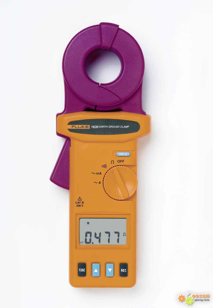

Öлª¹¤¿ØÍø ¡ú ¹¤¿Ø²úÆ· ¡ú Fluke 1630 ½ÓµØµç×èǯÐͲâÊÔÒÇ
²úÆ·Ãû³Æ£º Fluke 1630 ½ÓµØµç×èǯÐͲâÊÔÒÇ
ÐÍ ºÅ£º Fluke 1630
Æ· ÅÆ£º 80
³£¹æ¼¼ÊõÖ¸±ê
²Ù×÷Îó²î
   ²Î¿¼²Ù×÷ζȷ¶Î§£¬Á½Äêµ£±£
´æ·Åζȷ¶Î§
   -20°C ÖÁ 60°C£¨-4°F ÖÁ 140°F£©
²Î¿¼Î¶ȷ¶Î§
   23°C ± 5°C (73°F ± 9°F)
´æ´¢Êª¶È
   <75 % Rh
²Ù×÷ʪ¶È
   <85% Rh
ÏÔʾ
   999 Êý×Ö LC ÏÔʾÆÁ£¬´øÓÐÌØÊâ·ûºÅ
   IP30£¬·ûºÏ IEC 529/EN 60529
°²È«
   300 V£¬CAT III 2 ¼¶ÎÛȾ IEC 61010-1 ºÍ IEC 61010-2-032
ÖØÁ¿
   750 ¿Ë£¨1.165 °õ£©
µ¼Ï߳ߴç
   Ô¼ 35 ºÁÃ×£¨1.38 Ó¢´ç£©
³ß´ç£¨³¤ x ¿í x ¸ß£©
   276 ºÁÃ× x 100 ºÁÃ× x 47 ºÁÃ×£¨10.8 Ó¢´ç x 3.9 Ó¢´ç x 1.9 Ó¢´ç£©
·ùÉä
   IEC 1000 4-2£¬IEC 61326-I£¨B Àࣩ
µç´Å·À¸ÉÈÅ
   IEC 61000-4-2£¬8 kV£¨¿ÕÆø£©±ê×¼ A
   IEC 61000-4-3£¬3 V/m ÐÔÄܱê×¼ A
Á¿³ÌÑ¡Ôñ
   ×Ô¶¯
¹ýÔØÖ¸Ê¾Æ÷
   ÆÁÉÏÏÔʾ“OL×ÖÑù
²âÁ¿Ê±¼ä
   0.5 Ãë
²âÁ¿ÆµÂÊ
   3.333 kHz
µç³ØÀàÐÍ
   9 V ¼îÐÔµç³Ø£¨IEC 6 LR 61 ÐÍ£©
µç³ØÊÙÃü
   ≥ 8 Сʱ£¨Á¬Ðø¹¤×÷£©
¹¦ºÄ
   40 mA
µç³ØµÍµçÁ¿Ö¸Ê¾
   ÏÔʾ·ûºÅ
½ÓµØ»ØÂ·µç×裨×Ô¶¯µ÷ÕûÁ¿³Ì£©
Á¿³Ì
   ×¼È·¶È
£¨± µç×è¶ÁÊýµÄ %£©
0.025 - 0.250 Ω
   ± 1.5 % ¶ÁÊý ± 0.02 Ω
0.250 - 9.999 Ω
   ± 1.5 % ¶ÁÊý ± 05 Ω
10.00 - 99.99 Ω
   ± 2.0 % ¶ÁÊý ± 0.3 Ω
100.0 - 199.9 Ω
   ± 3.0 % ¶ÁÊý ± 1.0 Ω
200.0 - 400.0 Ω
   ± 5.0 % ¶ÁÊý ± 5 Ω
400.0 - 600.0 Ω
   ± 10 % ¶ÁÊý ± 10 Ω
600.0 - 1500 Ω
   ± 20 %
   »ØÂ·µç×裨ÎÞ¸ÐÓ¦£©£¬Íⲿ´Å³¡ < 50A/m£¬Íⲿµç³¡ < 1 V/m£¬µ¼Ïß¾ÓÖС£
