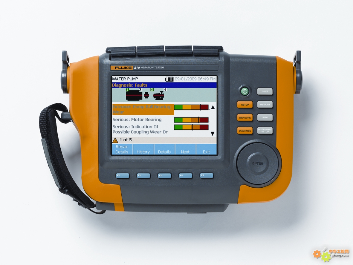

²úÆ·Ãû³Æ£º Fluke 810 Õñ¶¯Õï¶Ï·ÖÎöÒÇ|²âÕñÒÇ
ÐÍ ºÅ£º Fluke 810
Æ· ÅÆ£º 80
Õï¶Ï¼¼Êõ²ÎÊý
±ê×¼¹ÊÕÏ
  ²»Æ½ºâ¡¢Ëɶ¯¡¢²»¶ÔÖкÍÖá³Ð¹ÊÕÏ
Õñ¶¯Õï¶ÏÒÇ¿ÉÒÔ·ÖÎö µç»ú¡¢·ç»ú¡¢¹Ä·ç»ú¡¢Æ¤´øºÍÁ´´«¶¯»ú¹¹¡¢±äËÙÏä¡¢ÁªÖáÆ÷¡¢ÀëÐıᢻîÈû±Ã¡¢»¬Æ¬±Ã¡¢Ðý½°±Ã¡¢Âݸ˱á¢ÂÝÎÆ/³ÝÂÖ/͹ÂÖÐýת±Ã¡¢»îÈûʽѹËõ»ú¡¢ÀëÐÄʽѹËõ»ú¡¢ÂÝÐýʽѹËõ»ú¡¢Ö±ÇýÉ豸¡¢Ö÷Öá
Õñ¶¯Õï¶ÏÒÇ/Õñ¶¯·ÖÎöÒÇתËÙ·¶Î§
  200 rpm to 12000 rpm
ÏêϸÕï¶ÏÄÚÈÝ Ò×¶®µÄ½áÂÛ¡¢¹ÊÕÏÑÏÖØÐÔ£¨Çá΢¡¢Öеȡ¢ÑÏÖØ¡¢¼«ÑÏÖØ£©¡¢Î¬ÐÞÏêÇé¡¢ÌØÕ÷Æ×·å¡¢ÆµÆ×
µçÆø¼¼Êõ²ÎÊý
Á¿³Ì±ä»»
  ×Ô¶¯
A/D ת»»Æ÷
  4 ͨµÀ£¬24 λ
¿ÉÓôø¿í
  2 Hz ÖÁ 20 kHz
³éÑù
  51.2 Hz
Êý×ÖÐźŴ¦Àí¹¦ÄÜ ×Ô¶¯ÅäÖõĿ¹»ìµþÂ˲¨Æ÷¡¢¸ßͨÂ˲¨Æ÷¡¢³éÑù¡¢Öصþ¡¢¼Ó´°¡¢FFT ºÍƽ¾ù
Õñ¶¯Õï¶ÏÒDzÉÑùÂÊ 2.5 kHz ÖÁ 50 kHz
¶¯Ì¬·¶Î§
  128 dB
ÐÅÔë±È
  100 dB
FFT ·Ö±æÂÊ
  800 Ïß
ƵÆ×´°¿Ú
  ººÄþ´° (Hanning)
ƵÂʵ¥Î»
  Hz, orders, cpm
·ùÖµµ¥Î»
  in/s£¬mm/s£¬VdB£¨ÃÀ¹ú£©£¬VdB*£¨Å·ÖÞ£©
·ÇÒ×ʧÐÔ´æ´¢Æ÷
  SD ΢ÐÍ´æ´¢¿¨£¬2 GB ÄÚ´æ + Óû§À©Õ¹´æ´¢²Û£¨ÓÃÓÚ¸½¼Ó´æ´¢£©
Ò»°ã¼¼Êõ²ÎÊý
Õñ¶¯Õï¶ÏÒdzߴ磨¸ß x Éî x ¿í£©
  18.56 cm x 7.00 cm x 26.72 cm (7.30 in x 2.76 in x 10.52 in)
Õñ¶¯Õï¶ÏÒÇÖØÁ¿£¨°üÀ¨µç³Ø£©
  1.9 kg (4.2 lb)
ÏÔʾÆÁ
  ¼ VGA, 320 × 240 Color (5.7 inch diagonal) TFT LCD with LED backlight
ÊäÈë/Êä³öÁ¬½Ó
  ÈýÖá´«¸ÐÆ÷Á¬½Ó: 4 Õë M12 Á¬½ÓÆ÷
µ¥Öá´«¸ÐÆ÷Á¬½Ó: BNC Á¬½ÓÆ÷
תËÙ¼ÆÁ¬½Ó: Î¢ÐÍ DIN 6 ÕëÁ¬½ÓÆ÷
PC Á¬½Ó: Î¢ÐÍ "B"USB (2.0) Á¬½ÓÆ÷
Õñ¶¯Õï¶ÏÒÇµç³Ø
  µç³ØÀàÐÍ: ï®Àë×Óµç³Ø£¬14.8 V, 2.55 Ah
µç³Ø³äµçʱ¼ä: 3 Сʱ
µç³Ø·Åµçʱ¼ä: 8 Сʱ£¨Õý³£Ìõ¼þÏ£©
½»Á÷ÊÊÅäÆ÷
  ÊäÈëµçѹ: 100 Vac ÖÁ 240 Vac
ÊäÈëÆµÂÊ: 50/60 Hz
²Ù×÷ϵͳ
  WinCE 6.0 Core
Ö§³ÖµÄÓïÑÔ
  Ó¢Óï¡¢·¨Óï¡¢µÂÓï¡¢Òâ´óÀûÓï¡¢ÈÕÓï¡¢ÆÏÌÑÑÀÓï¡¢¼òÌåÖÐÎÄ¡¢Î÷°àÑÀÓï
±£ÐÞÆÚ
  3 Äê
»·¾³²ÎÊý
Õñ¶¯Õï¶ÏÒǹ¤×÷ζÈ
  0 °C ÖÁ 50 °C (32 °F ÖÁ 122 °F)
´¢´æÎ¶È
  -20 °C ÖÁ 60 °C (-4 °F ÖÁ 140 °F)
Õñ¶¯Õï¶ÏÒǹ¤×÷ʪ¶È
  10 % ÖÁ 95 % RH£¨ÎÞÀäÄý£©
»ú¹¹ÈÏÖ¤
  CHINA RoHS, CSA, CE, C TICK, WEEE
µç´Å¼æÈÝÐÔ
  EN 61326-1:2006£¬EN 61010:1:2001 µÚ 2 °æ.
´«¸ÐÆ÷¼¼Êõ²ÎÊý
´«¸ÐÆ÷ÀàÐÍ
  ¼ÓËٶȼÆ
ÁéÃô¶È
  100 mV/g (± 5 %, 25 °C)
¼ÓËÙ¶È·¶Î§
  80 g ·åÖµ
·ù¶È·ÇÏßÐÔ¶È
1 %
ƵÂÊÏìÓ¦
  Z: 2 - 7,000 Hz ± 3dB
X, Y: 2 - 5,000 Hz ± 3dB
µçÔ´ÒªÇó (IEPE) 18 V dc ÖÁ 30 V dc, 2 mA ÖÁ 10 mA
Æ«ÖÃÊä³öµçѹ
12 V dc
½ÓµØ
Íâ¿Ç½ÓµØ
´«¸ÐÔª¼þÉè¼Æ
PZT ÌÕ´É/¼ôÇÐʽ
Íâ¿Ç²ÄÁÏ
316L ²»Ðâ¸Ö
°²×°
10-32 ÄÚÁù½ÇÍ·ÂÝË¿£¬2 ¼«Ï¡ÍÁ´ÅÌ壨48 °õÀ­Á¦£©
Êä³öÁ¬½ÓÆ÷
4 Õ룬M122
Æ¥Åä
M12 - F4D
·ÇÒ×ʧÐÔ´æ´¢Æ÷
TEDS 1451.4 ¼æÈÝ
Õñ¶¯ÏÞÖµ
500 g ·åÖµk
³å»÷ÏÞÖµ
5000 g ·åÖµ
µç´ÅÁéÃô¶È£¬µÈЧ g
100 μg/¸ß˹
ÃÜ·â
ÆøÃÜÃÜ·â
ζȷ¶Î§
-50 °C ÖÁ 120 °C (-58 °F ÖÁ 248 °F) ± 7 %
±£ÐÞÆÚ
Ò»Äê
תËټƼ¼Êõ²ÎÊý
³ß´ç£¨Éîx¿í£©
  2.86 cm x 12.19 cm (1.125 in x 4.80 in)
ÖØÁ¿
  96 g (3.4 oz)£¬°üÀ¨µçÀÂ
µçÔ´ ÓÉ 810 Õñ¶¯Õï¶ÏÒǹ©µç
¼ì²â
  Class 2 ¼¤¹â¶þ¼«¹Ü
·¶Î§
  6.0 to 99,999 rpm
׼ȷ¶È
  6.0 to 5999.9 rpm: ± 0.01 % ºÍ ± 1 ×Ö
5999.9 to 99999 rpm: ± 0.05 % ºÍ ± 1 ×Ö
·Ö±æÂÊ
  0.1 rpm
ÓÐЧ·¶Î§
  1 cm ÖÁ 100 cm (0.4 in ÖÁ 39.27 in)
ÏìӦʱ¼ä
  1 second (> 60 rpm)
¿ØÖÆ
  ²âÁ¿ on/off ͸Ã÷°´Å¥
½Ó¿Ú
  6 Õë Mini DIN
µçÀ³¤¶È
  50 cm (19.586 in)
±£ÐÞÆÚ
  Ò»Äê
תËټƸ½¼þ
  ·´¹â´ø: 1.5 cm x 52.5 cm (0.59 in × 20.67 in)
Viewer PC Èí¼þ
×îµÍÓ²¼þÒªÇó
  1 GB RAM
²Ù×÷ϵͳҪÇó
  Windows XP, Vista
