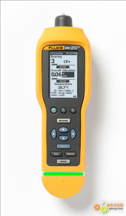

²úÆ·Ãû³Æ£º Fluke 805 Õñ¶¯ÁÒ¶È£¨µã¼ì£©ÒÇ
ÐÍ ºÅ£º Fluke 805
Æ· ÅÆ£º 80
Õñ¶¯ÁÒ¶È£¨µã¼ì£©ÒÇ
µÍƵ·¶Î§£¨Í¨Æµ²âÁ¿£© 10 Hz ÖÁ 1000 Hz
¸ßƵ·¶Î§£¨CF+ ²âÁ¿£© 4000 Hz ÖÁ 20000 Hz
ÑÏÖØ¶ÈµÈ¼¶ Á¼ºÃ¡¢Ò»°ã¡¢²»ÂúÒâ¡¢²»¿É½ÓÊÜ
Õñ¶¯ÏÞÖµ 50 g ·åÖµ (100 g ×î´ó·åÖµ)
A/D ת»» 16 ±ÈÌØ
ÐÅÔë±È 80 dB
²ÉÑùÂÊ
        µÍƵ
        ¸ßƵ
20000 Hz
80000 Hz
ʵʱʱÖÓ±¸·Ý Å¥¿Ûµç³Ø
´«¸ÐÆ÷
ÁéÃô¶È 100 mV g ± 10%
²âÁ¿Öµ·¶Î§ 0.01 g ÖÁ 50 g
¸ßƵ·¶Î§ 4000 Hz ÖÁ 20000 Hz
·Ö±æÂÊ 0.01 g
׼ȷ¶È ÔÚ 100 Hz ± ²âÁ¿Öµ 5% ·¶Î§ÄÚ
Õñ·ùµ¥Î»
¼ÓËÙ¶È g, m/sec²
ËÙ¶È in/s, mm/s
Î»ÒÆ mils, mm
ºìÍâ²âÎÂÒÇ£¨Î¶ȲâÁ¿£©
·¶Î§ -20 °C ÖÁ 200 °C£¨-4 °F ÖÁ 392 °F£©
׼ȷ¶È ±2 °C (4 °F)
½¹¾à ¹Ì¶¨£¬´óÔ¼ 3.8 cm (1.5″)
Íⲿ´«¸ÐÆ÷
×¢Ò⣺¸£Â»¿ËÖ§³Öµ«²»ÌṩÍⲿ´«¸ÐÆ÷
ƵÂÊ·¶Î§ 10 Hz ÖÁ 1000 Hz
Æ«Öõçѹ£¨ÖÁµçÔ´£© 20 V dc ÖÁ 22 V dc
Æ«ÖõçÁ÷£¨ÖÁµçÔ´£© ×î´óÖµ 5 mA
ÄÚ²¿Èí¼þ
Íⲿ½Ó¿Ú USB 2.0£¨È«ËÙ£©Í¨Ñ¶½Ó¿Ú
Êý¾ÝÈÝÁ¿ ÄÚÖÃÉÁ´æÉϵÄÊý¾Ý¿âÖÐ
Éý¼¶ ͨ¹ý USB ²å¿×½øÐÐ
´æ´¢Æ÷ ¿É´æ´¢¸ß´ï 3500 Ìõ²âÁ¿½á¹û
·øÉä
¾²µç·Åµç£ºâ§·¢ ±ê×¼ EN 61000-4-2
µç´Å¸ÉÈÅ ±ê×¼ EN 61000-4-3
·øÉä ±ê×¼ CISPR 11 ¼¶±ð A
»·¾³
¹¤×÷ÎÂ¶È -20 °C ÖÁ 50 °C£¨-4 °F ÖÁ 122 °F£©
´æ·ÅÎÂ¶È -30 °C ÖÁ 80 °C£¨-22 °F ÖÁ 176 °F£©
²Ù×÷ʪ¶È 10% ÖÁ 95%£¬Ïà¶Ôʪ¶È
£¨ÎÞÀäÄý£©
²Ù×÷/´æ´¢¸ß¶È 3048 m (10000 ft) º£°Î¸ß¶È
IP µÈ¼¶ IP54
Õñ¶¯ÏÞÖµ 500g ·åÖµ
µøÂ·²âÊÔ 1 Ã×
Ò»°ã¹æ¸ñ
µç³ØÀàÐÍ AA £¨Á½½Ú£©¼îÐÔ»ò 2 V dc ï®µç³Ø
µç³ØÊÙÃü 8 Сʱ
³ß´ç£¨³¤ x ¿í x ¸ß£© 24.1 cm x 7.1 cm x 5.8 cm
(9.5 in x 2.8 in x 2.3 in)
ÖØÁ¿ 0.40 kg (0.89 lb)
²å¿× USB mini-B 7-pin¡¢Á¢ÌåÉùÒôƵÊä³ö²å¿×£¨3.5 mm ÒôƵ²åÍ·£©¡¢Íⲿ´«¸ÐÆ÷²å¿×£¨SMB ½ÓÍ·£©
