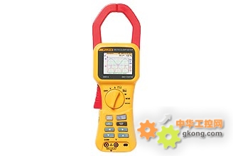

²úÆ·Ãû³Æ£º Fluke 345ÊÖ³Öʽг²¨Ç¯±í
ÐÍ ºÅ£º Fluke 345
Æ· ÅÆ£º 80
ÏÔʾ
²Êɫ͸ÊÓÐÍÒº¾§ÏÔʾÆÁ£¬320 x 240 ÏñËØ£¨70 ºÁÃ×¶Ô½ÇÏߣ©£¬2 ¼¶±³¹â
µçÔ´
   µç³ØÀàÐÍ:1.5 V AA ¼îÐÔµç³Ø£¬MN 1500 »ò IEC LR6 x 6
µç³ØÊÙÃü£¨µäÐÍ£©
   > 10 Сʱ£¨È«¿ª±³¹â£©
   > 12 Сʱ£¨ÓÐÏÞ±³¹â£©
½»Á÷µçת½ÓºÐ BE345
ÊäÈë  110/230 V 50/60 Hz
Êä³ö  15 V dc£¬300 mA
»·¾³Ìõ¼þ£¨½öÏÞÊÒÄÚʹÓã©
²Î¿¼Ìõ¼þ
   ËùÓÐ׼ȷ¶È¾ùÊÇÔÚ 23°C ± 1°C (73.4°F ± 1.8°F) µÄ»·¾³ÖвâµÃµÄ
²Ù×÷ζÈ
   0°C ÖÁ 50°C£¨32°F ÖÁ 122°F£©
µçÁ÷µÄζÈϵÊý
   ≤ ± 0.15 % ¶ÁÊý/°C
µçѹµÄζÈϵÊý
   ≤ ± 0.15 % ¶ÁÊý/°C
×î¸ßÏà¶Ôʪ¶È
   Î¶Ȳ»³¬¹ý 31°C (87°F) ʱΪ 80 %£¬40°C (104°F) ʱÏßÐÔ¼õСµ½ 50 %
×î¸ß²Ù×÷º£°Î¸ß¶È
   2000 m
µçÆø°²È«
   IEC 61010-1 600 V CAT IV£¬Ë«ÖØ»òÔöÇ¿Ð;øÔµ£¬2 ¼¶ÎÛȾ·À»¤
   ·À»¤µÈ¼¶ IP40£»EN60529
×î¸ß°²È«¹¤×÷µçѹ
µçÁ÷²âÁ¿  ·Ç¾øÔµµ¼ÌåºÍ½ÓµØÏßÖ®¼ä: 600 V ac rms »ò dc
µçѹ²âÁ¿  ÊäÈë¶Ë×ӺͽӵØÏßÖ®¼ä: 600 V ac rms »ò dc£»Àø´ÅÏàλµçѹ֮¼ä£¨Èý½ÇÐ͵çÔ´ÅäÖã© 825 V
EMC
·ùÉä
   IEC/EN 61326-1:1997 A Àà
µç´Å·À¸ÉÈÅ
   IEC/EN 61326-1:1997 ¸½Â¼ C£¬ÐÔÄܱê×¼ B
»úе¼¼ÊõÖ¸±ê
³ß´ç£¨³¤ x ¿í x ¸ß£©
   300 ºÁÃ× x 98 ºÁÃ× x 52 ºÁÃ×£¨12 Ó¢´ç x 3.75 Ó¢´ç x 2 Ó¢´ç£©
ÖØÁ¿£¨°üÀ¨µç³Ø£©
   820 ¿Ë/1.8 °õ
ǯ¿Ú
   60 ºÁÃ×
ǯ¿ÚÈÝÁ¿
   58 ºÁÃ×£¨Ö±¾¶£©
Çå½à
   ¿ÉÒÔʹÓýþÓÐÒì±û´¼µÄÈí²¼ÇåÏ´É豸¡£ ÇëÎðʹÓÃÑÐÄ¥¼Á»òÆäËûÈܼÁ¡£
µçÆøÊý¾Ý
µçÁ÷²âÁ¿ (dc, dc rms, ac rms)
Á¿³Ì
   0 ÖÁ 2000 A dc »ò 1400 ac rms
×Ô¶¯Á¿³Ìµ÷Õû¹¦ÄÜ
   40 A / 400 A / 2000 A
·Ö±æÂÊ
   10 mA£¨40 A Á¿³Ì£©
   100 mA£¨400 A Á¿³Ì£©
   1 A£¨2000 A Á¿³Ì£©
׼ȷ¶È: dc ºÍ dc rms
I > 10 A:  ± 1.5 % ¶ÁÊý ± 5 λÊý×Ö
I < 10 A:  ± 0.2 A
׼ȷ¶È: AVG
I > 10 A:  ± 3 % ¶ÁÊý ± 5 λÊý×Ö
I < 10 A:   ± 0.5 A
׼ȷ¶È: Pk
I > 10 A:  ± 5 % ¶ÁÊý ± 5 λÊý×Ö
I < 10 A:  ± 0.5 A
׼ȷ¶È: AHr
I > 10 A:  ± 2 % ¶ÁÊý ± 5 λÊý×Ö
I < 10 A:  ± 0.5 AHr
׼ȷ¶È: CF£¨·åֵϵÊý£©
1.1 ≤ CF < 3:  ± 3 % ¶ÁÊý ± 5 λÊý×Ö
3 ≤ CF < 5:   ± 5 % ¶ÁÊý ± 5 λÊý×Ö
·Ö±æÂÊ:   0.01
׼ȷ¶È: RPL£¨²¨¶¯£©
2 % ≤ RPL < 100 %:  ± 3 % ¶ÁÊý ± 5 λÊý×Ö
100 % ≤ RPL < 600 %:  ± 5 % ¶ÁÊý ± 5 λÊý×Ö
·Ö±æÂÊ:  0.1 %
Idc > 5 A£¬Iac > 2 A
µçѹ²âÁ¿ (dc, dc rms, ac rms)
Á¿³Ì
   0 ÖÁ 825 V dc »ò ac rms
×Ô¶¯Á¿³Ìµ÷Õû¹¦ÄÜ
   4 V / 40 V / 400 V / 750 V
·Ö±æÂÊ
   1 mV£¨4 V Á¿³Ì£©
   10 mV£¨40 V Á¿³Ì£©
   100 mV£¨400 V Á¿³Ì£©
   1 V£¨750 V Á¿³Ì£©
׼ȷ¶È: dc ºÍ dc rms
V > 1 V:  ± 1 % ¶ÁÊý ± 5 λÊý×Ö
V < 1 V:  ± 0.02 V
׼ȷ¶È: AVG
V > 1 V:  ± 3 % ¶ÁÊý ± 5 λÊý×Ö
V < 1 V:  ± 0.03 V
׼ȷ¶È: Pk
V > 1 V:  ± 5 % ¶ÁÊý ± 5 λÊý×Ö
V < 1 V:  ± 0.03 V
׼ȷ¶È: CF£¨·åֵϵÊý£©
·Ö±æÂÊ:  0.01
׼ȷ¶È: RPL£¨²¨¶¯£©
·Ö±æÂÊ:  0.1 %
Vdc > 0.5 V£¬Vac > 0.2 V
   ¾ùΪֱÁ÷²âÁ¿£¬15 Hz ÖÁ 1 kHz
×î´ó¹ýÔØ 1,000 V rms
µçѹ rms ÊÇÕæÓÐЧֵ²âÁ¿ (ac + dc)
г²¨
THD£¨×Üг²¨Ê§Õ棩
1 % ≤ THD < 100 %:  ± 3 % ¶ÁÊý ± 5 λÊý×Ö
100 % ≤ THD < 600 %:  ± 5 % ¶ÁÊý ± 5 λÊý×Ö
·Ö±æÂÊ:  0.1 %
DF£¨Ê§ÕæÏµÊý£©
1 % ≤ DF < 100 %:  ± 3 % ¶ÁÊý ± 5 λÊý×Ö
·Ö±æÂÊ:  0.1 %
H02 ≤ Vharm < H13:  ± 5 % ± 2 λÊý×Ö
H13 ≤ Vharm ≤ H30:  ± 10 % ± 2 λÊý×Ö
   ËùÓвâÁ¿×î¶à´ïµÚ 30 ¸öг²¨£¨µÚ 40 ¸öг²¨ÊÊÓÃÓÚ 15 Hz ÖÁ 22 Hz£©
»ù²¨ÆµÂÊ·¶Î§: F0 15 Hz ÖÁ 22 Hz ºÍ 45 Hz ÖÁ 65 Hz
Vacrms > 1V
¹¦ÂʲâÁ¿£¨µ¥ÏàºÍÈýÏࣩ(dc, dc rms, ac rms)
Á¿³Ì
   0 ÖÁ 1650 kW dc »ò 1200 kW ac
×Ô¶¯Á¿³Ìµ÷Õû¹¦ÄÜ
   4 kW£¬40 kW£¬400 kW£¬1650 kW
·Ö±æÂÊ
   1 W£¨4 kW Á¿³Ì£©
   10 W£¨40 kW Á¿³Ì£©
   100 W£¨400 kW Á¿³Ì£©
   1 kW£¨1200 kW Á¿³Ì£©
׼ȷ¶È
   2.5 % ¶ÁÊý ± 5 λÊý×Ö
   W1Ø < 2 kW ± 0.08 kW
   W3Ø < 4 kW ± 0.25 kW
VA ²âÁ¿£¨µ¥ÏàºÍÈýÏࣩ(dc, dc rms, ac rms)
Á¿³Ì
   0 ÖÁ 1650 kVA dc »ò 1200 kVA ac
×Ô¶¯Á¿³Ìµ÷Õû¹¦ÄÜ
   4 kVA£¬40 kVA£¬400 kVA£¬1650 kVA
·Ö±æÂÊ
   1 VA£¨4 kVA Á¿³Ì£©
   10 VA£¨40 kVA Á¿³Ì£©
   100 VA£¨400 kVA Á¿³Ì£©
   1 kVA£¨1200 kVA Á¿³Ì£©
׼ȷ¶È
VA > 2 kVA:  2.5 % ¶ÁÊý ± 5 λÊý×Ö
VA < 2 kVA:  ± 0.08 kVA
VAR ²âÁ¿£¨µ¥ÏàºÍÈýÏࣩ
Á¿³Ì
   0 ÖÁ 1250 kVAR
×Ô¶¯Á¿³Ìµ÷Õû¹¦ÄÜ
   4 kVAR£¬40 kVAR£¬400 kVAR£¬1200 kVAR
·Ö±æÂÊ
   1 VAR£¨4 kVAR Á¿³Ì£©
   10 VAR£¨40 kVAR Á¿³Ì£©
   100 VAR£¨400 kVAR Á¿³Ì£©
   1 kVAR£¨1200 kVAR Á¿³Ì£©
׼ȷ¶È
VAR > 4 kVAR:  ± 2.5 % ¶ÁÊý ± 5 λÊý×Ö
VAR < 4 kVAR:  ± 0.25 kVAR
¹¦ÂÊϵÊý·¶Î§
   0.3 < PF < 0.99
¹¦ÂÊϵÊý£¨µ¥ÏàºÍÈýÏࣩ
Á¿³Ì
   0.3£¨µçÈÝÐÔ£©ÖÁ 1.0 ºÍ 1.0 ÖÁ 0.3£¨¸ÐÓ¦ÐÔ£©£¨72.5°£¨µçÈÝÐÔ£©ÖÁ 0° ºÍ 0° ÖÁ 72.5°£¨¸ÐÓ¦ÐÔ£©£©
·Ö±æÂÊ
   0.001
׼ȷ¶È
   ± 3°
ƵÂÊ·¶Î§
   15 Hz ÖÁ 1 kHz
Æ«ÒÆ¹¦ÂÊϵÊý£¨µ¥ÏàºÍÈýÏࣩ
Á¿³Ì
·Ö±æÂÊ
   0.001
׼ȷ¶È
   ± 3°
ƵÂÊ·¶Î§
ǧÍßСʱ (kWHr)
Á¿³Ì
   40,000 kWHr
×Ô¶¯Á¿³Ìµ÷Õû¹¦ÄÜ
   4 kWHr£¬40 kWHr£¬400 kWHr£¬4,000 kWHr£¬40,000 kWHr
·Ö±æÂÊ
   1 WHr£¨4 kWHr Á¿³Ì£©
   10 WHr£¨40 kWHr Á¿³Ì£©
   100 WHr£¨400 kWHr Á¿³Ì£©
   1 kWHr£¨4,000 kWHr Á¿³Ì£©
   10 kWHr£¨40,000 kWHr Á¿³Ì£©
׼ȷ¶È
kWHr > 2 kWHr:  ± 3 % ± 5 λÊý×Ö
kWHr < 2 kWHr:  ± 0.08 kWHr
ËùÓй¦ÂÊ/VA/VAR/PF ²âÁ¿
ƵÂÊ·¶Î§:  Ö±Á÷£¬15 Hz ÖÁ 1 kHz
µçÁ÷·¶Î§:  10 A ÖÁ 1400 A rms
µçѹ·¶Î§:  1 V ÖÁ 825 V rms
×î´óÊäÈë:  825 V rms/1400 A rms
×î´ó¹ýÔØ:  1000 V rms/10,000 A£»¾ùΪֱÁ÷²âÁ¿£¬15 Hz ÖÁ 1 kHz¡£ ×î´ó¹ýÔØ 10,000 A »òÕæÓÐЧֵ x ƵÂÊ < 400,000
ƵÂʲâÁ¿£¨µçÁ÷»òµçѹԴ£©
Á¿³Ì
   15 Hz ÖÁ 1 kHz
·Ö±æÂÊ
   0.1 Hz
׼ȷ¶È
   15 ÖÁ 22 Hz ± 0.5 % ¶ÁÊý
   40 ÖÁ 70 Hz ± 0.5 % ¶ÁÊý
   15 ÖÁ 1000 Hz ± 1 % ¶ÁÊý
µçÁ÷·¶Î§
   10 A ÖÁ 1400 A rms
µçѹ·¶Î§
   1 V ÖÁ 825 V rms
·¶Î§¹¦ÄÜ
µçÁ÷²âÁ¿
Á¿³Ì:  10 A / 20 A / 40 A / 100 A / 200 A / 400 A / 1000 A / 2000 A
·Ö±æÂÊ:  1 A£¨40 A Á¿³Ì£©
10 A£¨400 A Á¿³Ì£©
50 A£¨2000 A Á¿³Ì£©
׼ȷ¶È:  ± 3 % ¶ÁÊý ± 1 ÏñËØ
×î´ó¹ýÔØ:  10,000 A
µçѹ²âÁ¿
Á¿³Ì:  4 V / 10 V / 20 V / 40 V / 100 V / 200 V / 400 V / 1000 V
·Ö±æÂÊ:  100 mV£¨4 V Á¿³Ì£©
1 V£¨40 V Á¿³Ì£©
10 V£¨400 V Á¿³Ì£©
31.25 V£¨1000 V Á¿³Ì£©
׼ȷ¶È:  ± 2 % ¶ÁÊý ± 1 ÏñËØ
ƵÂÊ·¶Î§:  Ö±Á÷£¬15 Hz ÖÁ 600 kHz
ʱ»ù
   2.5 ms£¬5 ms£¬10 ms£¬25 ms£¬50 ms/div
Ë¢ÐÂÂÊ
   0.5 Ãë
×î¸ß²ÉÑùÂÊ
   15.625 kHz
Ó¿ÈëµçÁ÷¹¦ÄÜ
Á¿³Ì
   40 A¡¢400 A ºÍ 2000 A
·Ö±æÂÊ
   10 mA£¨40 A Á¿³Ì£©
   1 A£¨2000 A Á¿³Ì£©
׼ȷ¶È
I > 10 A:  ± 5 % ¶ÁÊý ± 1 ÏñËØ
I < 10 A:  ± 0.5 A
×î´ó¹ýÔØ
   µçÁ÷ rms ÎªÕæÓÐЧֵ²âÁ¿ (ac + dc)
²¶»ñʱ¼ä
   1 s¡¢3 s¡¢10 s¡¢30 s¡¢100 s ºÍ 300 s
×î¸ß²ÉÑùÂÊ
   15.625 kHz
½Ó¿Ú
   Á¬½Ó PC µÄ USB ½Ó¿Ú
   ÓÃÓÚÏÂÔØ¡¢·ÖÎöºÍ±¨¸æµÄµçÄܼǼÈí¼þ
   ÓÃÓÚ°²×°Ð¹̼þ°æ±¾µÄ 345 Éý¼¶ÊµÓóÌÐò
¼Ç¼´æ´¢Æ÷
¼ÇÂ¼ÇøÓò
   Èý¸öÇøÓò£¬¿ÉÒÔµ¥¶ÀʹÓûòºÏ²¢³ÉÒ»¸ö½Ï´óÇøÓò
ƽ¾ùÖÜÆÚ
   1 s¡¢2 s¡¢5 s¡¢10 s¡¢30 s¡¢1 min¡¢5 min¡¢10 min ¡¢15 min ºÍ×Ô¶¨Òå
