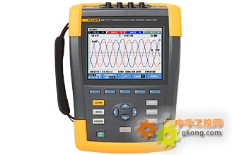

²úÆ·Ãû³Æ£º Fluke 435 II ϵÁÐÈýÏàµçÄÜÖÊÁ¿·ÖÎöÒÇ
ÐÍ ºÅ£º Fluke 435 II
Æ· ÅÆ£º 80
Fluke 435 II ϵÁÐÈýÏàµçÄÜÖÊÁ¿·ÖÎöÒDzúÆ·¼¼ÊõÖ¸±ê
  ģʽ Á¿³Ì ·Ö±æÂÊ ¾«¶È
·üÌØ
Vrms£¨½»Á÷ + Ö±Á÷ 435-II 1 V ÖÁ 1000 V Ïàµçѹ 0.01 V ± 0.1% ¶î¶¨µçѹ****
Vpk   1 Vpk ÖÁ 1400 Vpk 1 V 5% ¶î¶¨µçѹ
µçѹ·åÖµÒòÊý (CF)   1.0 > 2.8 0.01 ± 5 %
Vrms½ 435-II   0.1 V ± 0.2% ¶î¶¨µçѹ
Vfund 435-II   0.1 V ± 0.1% ¶î¶¨µçѹ
µçÁ÷£¨¾«¶È²»°üÀ¨µçÁ÷ǯ¾«¶È)
Amps£¨½»Á÷ + Ö±Á÷£© i430-Flex 1x  5 A ÖÁ 6000 A 1 A ± 0.5% ± 5 ¸ö¼ÆÊýµã
i430-Flex 10x 0.5 A ÖÁ 600 A 0.1 A ± 0.5% ± 5 ¸ö¼ÆÊýµã
1mV/A 1x 5 A ÖÁ 2000 A 1A ± 0.5% ± 5 ¸ö¼ÆÊýµã
1mV/A 10x 0.5 A ÖÁ 200 A£¨½ö½»Á÷µç£© 0.1 A ± 0.5% ± 5 ¸ö¼ÆÊýµã
Apk i430-Flex  8400 Apk  1 Arms ± 5 %
1mV/A 5500 Apk 1 Arms ± 5 %
µçÁ÷·åÖµÒòÊý (CF)   1 ÖÁ 10 0.01 ± 5 %
Amps½ i430-Flex 1x  5 A ÖÁ 6000 A  1 A  ± 1% ± 10 ¸ö¼ÆÊýµã
i430-Flex 10x 0.5 A ÖÁ 600 A 0.1 A  ± 1% ± 10 ¸ö¼ÆÊýµã
1mV/A 1x   5 A ÖÁ 2000 A  1A  ± 1% ± 10 ¸ö¼ÆÊýµã
1mV/A 10x 0.5 A ÖÁ 200 A£¨½ö½»Á÷µç£© 0.1 A ± 1% ± 10 ¸ö¼ÆÊýµã
Afund i430-Flex 1x  5 A ÖÁ 6000 A 1A ± 0.5% ± 5 ¸ö¼ÆÊýµã
Hz
Hz Fluke 435 @ 50 Hz ¶î¶¨ 42.500 Hz ÖÁ 57.500 Hz 0.001 Hz ± 0.001 Hz
Fluke 435 @ 60 Hz ¶î¶¨  51.000 Hz ÖÁ 69.000 Hz 0.001 Hz ± 0.001 Hz
µçÔ´
ÍßÌØ
(VA£¬var)
i430-Flex  ×î´ó 6000 MW 0.1 W ÖÁ 1 MW ± 1% ± 10 ¸ö¼ÆÊýµã
1 mV/A ×î´ó 2000 MW 0.1 W ÖÁ 1 MW ± 1% ± 10 ¸ö¼ÆÊýµã
¹¦ÂÊÒòÊý
(Cos j/DPF)
  0 ÖÁ 1 0.001 ± 0.1% @ ¶î¶¨¸ºÔØ×´Ì¬
ÄÜÁ¿
kWh
(kVAh£¬kvarh)
i430-Flex 10x È¡¾öÓÚµçÁ÷ǯ±ä±ÈºÍ¶î¶¨µçѹ ± 1% ± 10 ¸ö¼ÆÊýµã
ÄÜÁ¿Ëðʧ i430-Flex 10x È¡¾öÓÚµçÁ÷ǯ±ä±ÈºÍ¶î¶¨µçѹ ± 1% ± 10 λÊý ²»º¬Ïßµç×辫¶È
г²¨
г²¨´ÎÊý (n)   Ö±Á÷£¬1 ÖÁ 50 ´Î·Ö×飺 г²¨·Ö×飬¸ù¾Ý IEC 61000-4-7 ¶ø¶¨
¼äг²¨´ÎÊý (n)   ¹Ø±Õ£¬1 ÖÁ 50 ´Î·Ö×飺 г²¨ºÍ¼äг²¨×Ó×飬¸ù¾Ý IEC 61000-4-7 ¶ø¶¨
µçѹ (V) %f 0.0 % ÖÁ 100 % 0.10% ± 0.1% ± n x 0.1 %
%r 0.0 % ÖÁ 100 % 0.10% ± 0.1% ± n x 0.4 %
¾ø¶Ô 0.0 ÖÁ 1000 V 0.1 V ± 5% *
THD 0.0 % ÖÁ 100 % 0.10% ± 2.5%
µçÁ÷ (A) %f 0.0 % ÖÁ 100 % 0.10% ± 0.1% ± n x 0.1%
¾ø¶Ô 0.0 ÖÁ 600 A 0.1 A ± 5% ± 5 ¸ö¼ÆÊýµã
THD 0.0 % ÖÁ 100 % 0.10% ± 2. 5%
¹¦ÂÊ %f »ò %r  0.0 % ÖÁ 100 % 0.10% ± n x 2%
¾ø¶Ô È¡¾öÓÚµçÁ÷ǯ±ä±ÈºÍ¶î¶¨µçѹ  ± 5% ± n x 2 % ± 10 ¸ö¼ÆÊýµã
THD 0.0 % ÖÁ 100 %   0.10% ± 5%
Ïà½Ç   -360° ÖÁ +0° ± n x 1°
ÉÁ±ä
Plt¡¢Pst¡¢Pst(1min) Pinst   0.00 ÖÁ 20.00 0.01 ± 5 %
²»Æ½ºâ
µçѹ % 0.0 % ÖÁ 20.0 % 0.10% ± 0.1 %
µçÁ÷ % 0.0 % ÖÁ 20.0 % 0.10% ± 1 %
µçÔ´ÐźÅ
µçÔ´ÐźŠ  ÔÚÁ½¸ö¶ÀÁ¢µÄƵÂÊÏ£¬ãÐÖµ¡¢ÏÞÖµºÍ¿ØÖÆÐźųÖÐøÊ±¼ä¿É±à³Ì
ÐÅºÅÆµÂÊ   60 Hz ÖÁ 3000 Hz 0.1 Hz
Ïà¶Ô V%   0 % ÖÁ 100 % 0.10% ± 0.4 %
±¾ø¶Ô V3s
(3 ÃëÆ½¾ùÖµ)
  0.0 V ÖÁ 1000 V 0.1 V ± 5 % ¶î¶¨µçѹ
