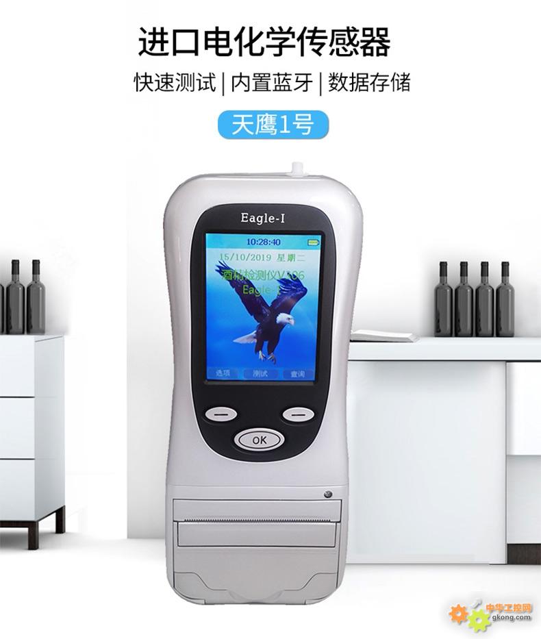

²úÆ·Ãû³Æ£º ÌìÓ¥1ºÅ¾Æ¾«Å¨¶È¼ì²âÒÇ
ÐÍ ºÅ£º ÌìÓ¥1ºÅ
ÌìÓ¥1ºÅ¾Æ¾«Å¨¶È¼ì²âÒǸÐлÄúÑ¡ÔñÌìÓ¥1ºÅȼÁÏµç³ØÐͺô³öÆøÌ徯¾«º¬Á¿¿ìËÙ¼ì²âÒÇ¡£Äú¿ÉÒÔͨ¹ýÔĶÁ±¾ÊÖ²á£¬È«ÃæµØÁ˽âÌìÓ¥1ºÅ¾Æ¾«¼ì²âÒǵÄʹÓ÷½·¨£¬ÁìÂÔÆäÍêÉÆµÄ¹¦Äܺͼò½àµÄ²Ù×÷¡£
Ò»¡¢²úÆ·ÌØµã£º
1¡¢Ö÷»ú²ÉÓøßÐÔÄÜ32λǶÈëʽ´¦ÀíÆ÷£¬´¦ÀíÄÜÁ¦Ç¿´ó£»
2¡¢²ÉÓø߿ɿ¿ÐÔ½ø¿ÚȼÁÏµç³ØÐ;ƾ«´«¸ÐÆ÷£¬¸Ã´«¸ÐÆ÷Ö»Óë¾Æ¾«Æð·´Ó¦£¬ÇÒʹÓÃÊÙÃü³¤£»
3¡¢×¨ÀûÆøÂ·Éè¼Æ£¬²âÊÔ׼ȷ£¬¿É¿¿ÐԺ㬾ßÓÐÖ÷¶¯²âÊÔÓë±»¶¯¿ìËÙ¼ì²â¹¦ÄÜ£»
4¡¢¿É²ÉÓÃרҵÀ®°ÈÐδµ×죨²»Óôµ¹Ü£©£¬Ò»ÃëÖÓ¿ìËÙÅŲ飬Á¬Ðø¶¨ÐÔ¼ì²â£»
5¡¢´µ¹Ü²ÉÓ÷Àµ¹ÎüÉè¼Æ£¬¿É360¶ÈÐýת£»
6¡¢2.8Ó¢´ç´óÆÁÄ»320×240µãÕó²ÊÉ«LCDÏÔʾ£¬È«ÖÐÎIJÙ×÷½çÃæ£»
7¡¢¼ò½ÝµÄÈý¼ü²Ù×÷£¬¿ÉÖ»ÓÃÒ»¼üÍê³ÉÕû¸ö²âÊÔ¹ý³Ì¡£È«³Ìָʾ´µÆø¹ý³Ì£¬Ö±¹Û£»
8¡¢²âÁ¿½á¹û·Å´óÏÔʾ£¬×Ô¶¯±³¾°ÑÕÉ«±ä»¯¹¦ÄÜ£»
9¡¢¿É´¥ÃþÆÁÊäÈë³µÅÆºÅ£¬¼Ýʻ֤ºÅ£¬Ö´·¨¾¯²ìºÅ£»
10¡¢ÄÚÖÃÀ¶ÑÀ£¬¿Éͨ¹ýPDA»ò±Ê¼Ç±¾²Ù¿Ø£»
12¡¢¿É´¢´æ12000Ìõ²âÊԼǼ£¬¿ÉËæÊ±²éѯ¼°´òÓ¡£¬È«²¿¼Ç¼¿É±¸·Ýµ½ºǫ́¼ÆËã»ú½øÐÐͳ¼Æ·ÖÎö£»
