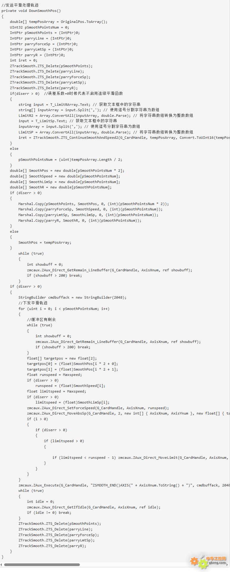

C#使用ZTrackSmooth库的连续平滑函数
03
在cad导出小线段数组后,可以通过ZTrackSmooth.dll库中提供的ZTS_ContinueSmoothAndSpeed函数进行运动前瞻规划,它的作用主要是通过给定参数用样条方式去连续平滑轨迹,并且在拐弯点和曲线段合理降速。
其中pDataPoints是传入的cad导出的小线段数组,通过设定对应参数后会
pSmoothPoints :平滑过后的坐标点集
parryLmtSp:输出每个店限速(mm/s),对应每条线段,用movelimit运行,<=0就不用设置// parryForceSp:输出的每段force_speed运行速度
然后根据输出结果按照流程使用对应函数下发给控制器执行。

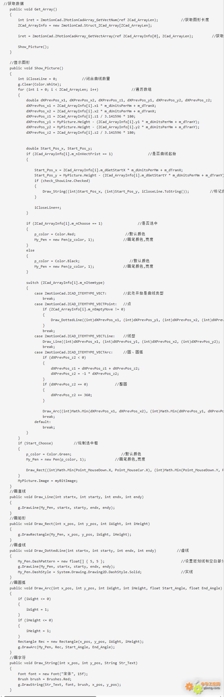

03 CAD导入图形
//CAD图形导入
private void BTN_IMPORT_Click(object sender, EventArgs e)
    if (G_CadHandle == (IntPtr)0)
        if (ZmotionCad.ZMotionCadArray_OpenEth("127.0.0.1", out G_CadHandle) != 0)
            MessageBox.Show("控制器连接失败");
            return;
    OpenFileDialog openFileDialog1 = new OpenFileDialog();
    openFileDialog1.InitialDirectory = "\\";
    openFileDialog1.Filter = "DXF File(*.dxf)|*.dxf|PLT File(*.PLT)|*.PLT|AI File(*.AI)|*.AI|DST File(*.DST)|*.DST";
    openFileDialog1.RestoreDirectory = true;
    openFileDialog1.FilterIndex = 1;
    if (openFileDialog1.ShowDialog() == DialogResult.OK)            //打开配置文件
        strFilePath = openFileDialog1.FileName;
        int iret = ZmotionCad.ZMotionCadArray_ImportVectGraph(strFilePath, 1024, 1, m_refDistance);
        iret = ZmotionCad.ZMotionCadArray_GetVectNum(ref ZCad_ArrayLen);           //导入数据
        ZCad_ArrayInfo = new ZmotionCad.Struct_ZCad_Array[ZCad_ArrayLen];
        iret = ZmotionCad.ZMotionCadArray_GetVectArray(ref ZCad_ArrayInfo[0], ZCad_ArrayLen);         //获取图形数据
        iret = ZmotionCad.ZMotionCadArray_IfCloseVect(false);             //是否只处理封闭轨迹
        //合并相连线
        iret = ZmotionCad.ZMotionCadArray_MergeSeg(0.5, If_Choose);
        Get_Array();
        float Image_Left, Image_bottom, Image_Width, Image_Height;
        Image_Left = 0;
        Image_bottom = 0;
        Image_Width = 0;
        Image_Height = 0;
        iret = ZmotionCad.ZMotionCadArray_GetRange(ref Image_Left, ref Image_bottom, ref Image_Width, ref Image_Height, 0.05);
        if (Image_Width < 0.0001 && Image_Height < 0.0001)
            Image_Left = (float)0.0;
            Image_bottom = (float)0.0;
            Image_Width = (float)100.0;
            Image_Height = (float)100.0;
        double ObjectPixHeight, ObjectPixWidth;
        if (Image_Width * PicHeight <= Image_Height * PicWidth)
            ObjectPixHeight = PicHeight;
            ObjectPixWidth = ObjectPixHeight * Image_Width / Image_Height;
        else
            ObjectPixWidth = PicWidth;
            ObjectPixHeight = ObjectPixWidth * Image_Height / Image_Width;
        //缩放比例
        double dScale = 0.0;
        dScale = ObjectPixHeight / Image_Height;
        m_dUnitsPerMm = dScale * 1;
        //偏移
        m_dTranX = (MyPicture.Width - ObjectPixWidth) / 2 - Image_Left * dScale;
        m_dTranY = (MyPicture.Height - ObjectPixHeight) / 2 - Image_bottom * dScale;
        Show_Picture();
        If_ImportArray = true;
04 绘制图形
05 点击启动,进行控制器前瞻参数设置
private void BTN_RUN_Click(object sender, EventArgs e)
    if (If_ImportArray == false)
        MessageBox.Show("未导入加载图形");
        return;
    Maxspeed = Convert.ToSingle(T_Speed.Text);
    Accel = Convert.ToSingle(T_Accel.Text);
    Decel = Convert.ToSingle(T_Decel.Text);
    Sramp = Convert.ToSingle(T_Sramp.Text);
    Lspeed = Convert.ToSingle(T_LSpeed.Text);
    Corner_Mode = Convert.ToInt32(T_CornerMode.Text);
    LimitR = Convert.ToSingle(T_LimitR.Text);
    Limitminspeed = Convert.ToSingle(T_MinSpeed.Text);
    Zsmooth = Convert.ToSingle(T_Zsmooth.Text);
    DecelAngle = Convert.ToSingle(T_DecelAngle.Text);
    StopAngle = Convert.ToSingle(T_StopAngle.Text);
    diserr = Convert.ToSingle(T_diserr.Text);
    SplineDis = Convert.ToSingle(T_SplineDis.Text);
    cornerAccel = Convert.ToSingle(T_CornerAcc.Text);
    HighJerk = Convert.ToSingle(T_HighJerk.Text);
    FitErr = Convert.ToDouble(T_FitErr.Text);
    AxisXnum = Convert.ToInt16(T_AxisXNum.Text);
    AxisYnum = Convert.ToInt16(T_AxisYNum.Text);
    //初始化参数
    zmcaux.ZAux_Direct_SetSpeed(G_CardHandle, AxisXnum, Maxspeed);
    zmcaux.ZAux_Direct_SetAccel(G_CardHandle, AxisXnum, Accel);
    zmcaux.ZAux_Direct_SetDecel(G_CardHandle, AxisXnum, Decel);
    zmcaux.ZAux_Direct_SetSramp(G_CardHandle, AxisXnum, Sramp);
    zmcaux.ZAux_Direct_SetLspeed(G_CardHandle, AxisXnum, Lspeed);
    zmcaux.ZAux_Direct_SetMerge(G_CardHandle, AxisXnum, 1);
    zmcaux.ZAux_Direct_SetCornerMode(G_CardHandle, AxisXnum, Corner_Mode);
    zmcaux.ZAux_Direct_SetFullSpRadius(G_CardHandle, AxisXnum, LimitR);
    StringBuilder cmdbuffack = new StringBuilder(2048);
    zmcaux.ZAux_Execute(G_CardHandle, "SPLIMIT_RADIUS("+ AxisXnum.ToString() +") = " + Limitminspeed.ToString(), cmdbuffack, 2048);

07 对提取出的CAD轨迹数组使用连续平滑函数,并下发给控制器执行
