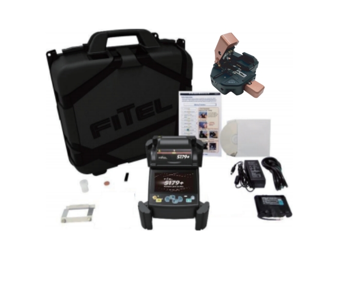

¹ÅºÓS179+¹âÏËÈÛ½Ó»úÐÔÄÜÓÅÊÆ£º
¼á¹ÌÄÍÓõĻúÉíÉè¼Æ
ÈÛ½Ó6Ã룬¼ÓÈÈ9Ã룬¿ÉÈÛ½ÓSOCÍ·
¼òµ¥ÖÇÄܵIJÙ×÷£¬Ð¿îS327¹âÏËÇи£¬¿ÉÇиî65000´ÎÒÔÉÏ
¿É¸ù¾Ý¹âÏËÇиî½Ç¶ÈÓÅ»¯·Åµç²ÎÊý£¬¿É¸ù¾ÝÈÛ½Ó½á¹û×Ô¶¯µ÷Õû·ÅµçÇ¿¶È
Éý¼¶ÈÛ½ÓËðºÄ¹ÀË㹦ÄÜ£¬¸Ä½øÈÛ½ÓËðºÄ¹ÀËãµÄ׼ȷÐÔ
¿ìËÙ·½±ãµÄά»¤¹¦ÄÜ£¬¿É²ðж´óVÐͲۣ¬±ãÓÚά»¤ºÍÇåÀí
´¥ÆÁ+°´¼üË«²Ù×÷ģʽ£¬»·ÈÆÊ½ÕÕÃ÷£¬¿ÉÓëÊÖ»ú»¥Áª.
¹¦ÄÜ
  • ´¥ÃþÆÁ£º4.3Ó¢´ç¿íÒº¾§ÏÔʾÆÁ
  • ÕÕÃ÷µÆ£º3¸öÉÏÃæ + 1¸öÏÂÃæµÄLED
  • ¿É²ðжVÐβۣº±ãÓÚά»¤ºÍ¾µÍ·Çå½à
  • NFC£ºÍ¨¹ýÖÇÄÜÊÖ»úËø¶¨ºÍ½âËø½ÓÍ·£¨½öÊÊÓÃÓÚAndroidÊÖ»ú°æ±¾4.1»ò¸ü¸ß°æ±¾£©
  • WiFiÍøÂ磺Çиî»úÓëÖÇÄÜÊÖ»úÖ®¼äµÄͨÐÅ
  • ¸ßËÙ£º6ÃëÆ´½Óʱ¼äºÍ9Ãë¼ÓÈÈʱ¼ä
¹ÅºÓS179+¹âÏËÈÛ½Ó»ú¼¼Êõ¹æ¸ñ
ÊÊÓùâÏËÀàÐÍ
SM (ITU-T G.652, G.657A1 and G.657A2), MM (ITU-T G.651),DSF (ITU-T G.653), Cut-off Shifted Fiber (ITU-T G.654, Large Area type), NZDS (ITU-T G.655),
BIF/UBIF (Bend Insensitive Fiber ITU-T G.657B3) SM / MM / DS / NZDS/BIF/UBIF
°ü²ãÖ±¾¶
80-150um
Í¿¸²²ãÖ±¾¶
100 –3000um
¹âÏËÇи¶È
5 – 16mm
ƽ¾ùÈÛ½ÓËðºÄ
SM: 0.01 dB, MM: 0.01 dB, DSF£º0.03 dB, NZD 0.04dB,
ÈÛ½Óʱ¼ä
6Ãë
¼ÓÈÈʱ¼ä
9Ãë
µç¼«Ê¹ÓÃÊÙÃü
5000´Î
ÈÛ½Ó³ÌÐò
300¸ö
×Ô¶¯ÈÛ½Ó¹¦ÄÜ
ÓÐ
¼ÓÈȳÌÐò
100¸ö
×Ô¶¯¼ÓÈȹ¦ÄÜ
¾ßÓÐ×Ô¶¯¼ÓÈÈ¿ªÊ¼¹¦ÄÜ
ÈÈËõ¹ÜÀàÐÍ
20/40/60mm
¹âÏ˼оßÀàÐÍ
¹Ì¶¨Í¨Óüо߻òרÓùâÏ˼оß
À­Á¦²âÊÔ
1.96N
»Ø²¨ËðºÄ
70 dB»òÒÔÉÏ
Ë¥¼õÈÛ½Ó
Ë¥¼õÈÛ½Ó·¶Î§0.1db—15db
ͼÏñ·Å´ó±¶Êý
104±¶£¬278±¶£¬556±¶   104X, 278X,556X
ÈÛ½ÓÊý¾Ý´æ´¢
20,000×é
ͼÏñ´æ´¢
×Ô¶¯´æ´¢100ÕÅÈÛ½ÓͼÏñ
³ß´ç
139(W)*209(D)*114(H)mm(²»°üÀ¨Ï𽺷ÀÕðµæ),
179(W)*246(D)*131(H)mm(°üÀ¨Ï𽺷ÀÕðµæ)
ÖØÁ¿
1.7kg£¨²»º¬µç³Ø£©£¬2.0kg£¨º¬µç³Ø£©
ÏÔʾÆ÷
4.3Ó¢´ç²ÊɫҺ¾§´¥ÃþÏÔʾÆÁ
ÍÆ½ø£¨Âí´ïÀ­Á¦£©
8N£¨Éè¼ÆÖµ£©
Êý¾ÝÊä³ö
USB2.0¸ßËÙÊý¾Ý½Ó¿Ú£¬Í¬Ê±Ö§³ÖÊÓÆµ´«Êä USB ver. 2.0 miniB x 1 , Standard A x 1 port
·À·ç
15m/s
²Ù×÷ζÈ
-10 µ½ 50°C
´æ´¢Î¶È
-40µ½60°C
ʪ¶È
0 µ½ 95% RH (ÎÞÀäÄý)
º£°Î
0µ½5000m
µçÔ´
½»Á÷100 ÖÁ240v£¨50/60HZ£©, Ö±Á÷11ÖÁ24v
µç³ØµçÁ¿
Ò»´Î³äµç¿ÉÍê³É230оÈ۽ӺͼÓÈÈ
¹ÅºÓS179+¹âÏËÈÛ½Ó»ú±ê×¼ÅäÖãº
ÏîÄ¿Ãû³Æ    ÐͺŠ   ÊýÁ¿
Ö÷»ú    S179+    1̨
¹âÏËÇи S327 1̨
Я´øÏä    HCC-05    1¸ö
±¸Óõ缫    ELR-01    1¶Ô
½»Á÷ÊÊÅäÆ÷    S979    1¿é
½»Á÷µçÔ´Ïß    -----    1Ìõ
µç¼«Çå½àÄ¥¾ß    D5111    1Ƭ
Çå½àË¢    VGC-01    1°Ñ
ï®µç³Ø    S947    1¿é
¿ìËÙÖ¸ÄÏ    FTS-B526    1±¾
