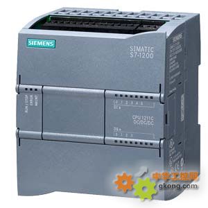

SIMATIC S7-1200, CPU 1211C, COMPACT CPU, AC/DC/RELAY, ONBOARD I/O: 6 DI 24V DC; 4 DO RELAY 2A; 2 AI 0 - 10V DC, POWER SUPPLY: AC 85 - 264 V AC AT 47 - 63 HZ, PROGRAM/DATA MEMORY: 30 KB
6ES7211-1BE31-0XB0市场价供应
