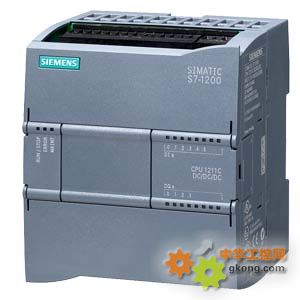

6ES7212-1HE31-0XB0 市场价供应
6ES7212-1HE31-0XB0
SIMATIC S7-1200, CPU 1212C, COMPACT CPU, DC/DC/RLY, ONBOARD I/O: 8 DI 24V DC; 6 DO RELAY 2A; 2 AI 0 - 10V DC, POWER SUPPLY: AC 20.4 - 28.8 V DC, PROGRAM/DATA MEMORY: 50 KB
产品详细描述介绍:
