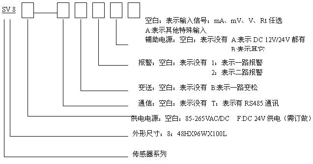

Ò»¡¢ÐͺÅ˵Ã÷
¶þ¡¢ÐͺÅÖÖÀà
ÐͺÅ
±¨¾¯·½Ê½
¸ôÀë±äËÍ
¸ôÀëͨѶ
SV8-1A
һ·±¨¾¯
ÎÞ
ÎÞ
SV8-2A
¶þ·±¨¾¯
ÎÞ
ÎÞ
SV8-B1A
һ·±¨¾¯
4-20mA
ÎÞ
SV8-B2A
¶þ·±¨¾¯
4-20mA
ÎÞ
SV8-TB1A
һ·±¨¾¯
4-20mA
RS485ͨѶ
SV8-TB2A
¶þ·±¨¾¯
4-20mA
RS485ͨѶ
