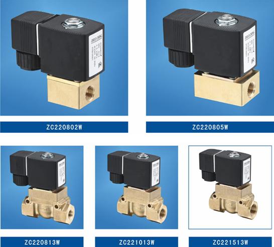

                ¶þλ¶þͨ¸ßεç´Å·§
ͼÐηûºÅ
²úƷ˵Ã÷
¸ßεç´Å·§²ÉÓûîÈûʽ½á¹¹£¬Ä͸ßÎÂÃÜ·â¼þ¼°ÏßȦ£¬Ê¹ÓÃÊÙÃü³¤£¬¹¤×÷ζÈ×î¸ß¿É´ï180¡æ£¬ÊÊÓýéÖÊÈ磨ÕôÆû£¬ÈÈË®£¬ÈÈ¿ÕÆøµÈ£©¡£¹ã·ºÓ¦ÓÃÓÚÇåÏ´É豸£¬³ø·¿¹¤³Ì£¬ÒÔϹæ¸ñ²¿·Ö¿É¶¨ÖÆ·À±¬¡¢³£¿ª¡¢¶¨Ê±¡¢ÌØÊâ¹æ¸ñ¿É¶¨×ö¡£

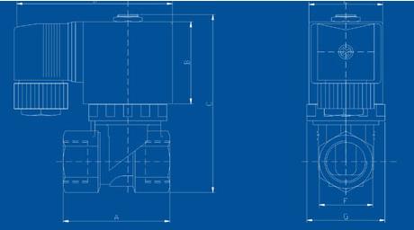

³ß´çͼ
³ß´ç
ÐͺÅ
A
B
C
D
E
F
G
ZC220601-W
32
40
67
78
36
32
34
ZC220602-W
ZC220803-W
46
ZC220804-W
ZC220805-W
ZC220813-W
71
100
93
22
ZC221013-W
ZC221513-W
ZC222020-W
92
126
126
41
62
ZC222525-W
118
127
127
36
73
