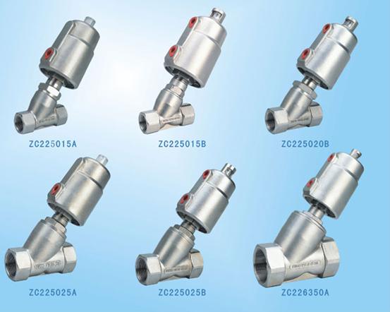

²úÆ·Ãû³Æ£º ¶þλ¶þͨ»îÈûÊ½Æø¿Ø½Ç×ù·§
ÐÍ ºÅ£º
²úƷ˵Ã÷
È«²»Ðâ¸Ö½Ç×ù·§µÄ·§Ìå¼°Óë½éÖʽӴ¥²¿·ÖµÄ²ÄÁÏλ316£¨ASTM CF8M£©¡£Æø¶¯Í·²ÄÖÊΪ304£¨ASTM CF8£©£»Ö÷Òª¹æ¸ñ³ß´ç´ÓDN10ÖÁDN50£¬Á¬½ÓÐÎʽÓйÜÂÝÎÆ£¨Ó¢±ê/ÃÀ±ê£©ºÍº¸½Ó¿Ú£¨DIN11850.2¡¢DIN11850.3¡¢ISO2037µÈ£©£»Æø¶¯Í·¹æ¸ñÓÐ41¡¢50¡¢63¡¢90mm£¨¸×¾¶£©¡£¹ã·ºÊÊÓÃÓÚÆ¡¾Æ¡¢ÒûÁÏ¡¢·Ä֯ӡȾ¡¢ÖÆÒ©Ò½ÁÆÉ豸¡¢Ê³Æ·¼Ó¹¤¡¢¡¢Ï𽺻úе¡¢Ïû¶¾Ãð¾úÉ豸¡¢Ë®´¦ÀíÉ豸¡¢ÒºÌå¹à×°É豸µÈ¡£ÒÔϹæ¸ñA´ú±íµ¥Æø¿Ø£¬B´ú±íË«Æø¿Ø£¬H´ú±íº¸½Óʽ¶©»õʱÇë×¢Ã÷¡£
¼¼Êõ¹æ¸ñ
ÐͺÅ
½Ó¿ÚG
Ö´ÐÐÆ÷
¿ØÖÆÑ¹Á¦Mpa
ѹÁ¦Mpa
¹«³ÆÍ¨¾¶¡é
½éÖÊζÈ
KVÖµM3/H
ZC224010A
G3/8¡±
40
0.3¡«0.8
0¡«1.6
13
-10¡«180¡æ
4.7
ZC225010A
G3/8¡±
13
4.7
ZC225015A
G1/2¡±
40
13
4.7
ZC225020A
G3/4¡±
18
9.5
ZC225025A
G1¡±
24
18.1
ZC226325A
G1¡±
63
24
18.1
ZC226332A
G11/4¡±
63
31
23.2
ZC226340A
G1/21¡±
63
35
32.8
ZC226350A
G2¡±
63
45
52.8
ZC229050A
G2¡±
90
45
52.8
