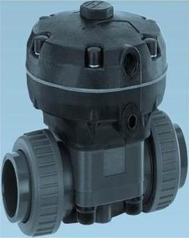

²úÆ·Ãû³Æ£º
667Æø¶¯ËÜÁϸôĤ·§
ÐÍ ºÅ£º
667
667
Æø¶¯ËÜÁϸôĤ·§
¹¤×÷Ìõ¼þ
ÊÊÓÃÓÚÈκζèÐÔ»ò¸¯Ê´ÐÔÆøÌå»òÒºÌ壬ȡ¾öÓÚ·§Ìå²ÄÖʺ͸ôĤ²ÄÖʵÄÕýÈ·Ñ¡Ôñ
×î¸ß¹¤×÷ζÈ
²ÎÕÕËÜÁϲÄÖʼ¼ÊõÐÅÏ¢
¿ØÖÆÑ¹Á¦
×î´óÔÊÐí¿ØÖÆÑ¹Á¦ 6bar
×î´óÔÊÐí¿ØÖÆ
½éÖÊζÈ
40¡æ
ͨ¾¶
15-80mm
¹¤×÷ѹÁ¦
0-10bar
KvÖµ
5.6-120 m³/h
ÖØÁ¿
1.0-9.6kg
·§Ìå²ÄÖÊ
PVC-U ABS PP PVDF ÄÚ³ÄPPH×ÔÈ»ÐÍ ÄÚ³ÄPPH»ÒÉ«RAL7032
·§Ìå½á¹¹
Á¬½Ó·½Ê½
¶ÔÕ´/¶Ôº¸ DIN ±ê×¼ Ó¢ÖÆ±ê×¼
ºìÍâÏß¶Ôº¸ DIN 8077 ϵÁÐ4
¶Ôº¸
WNF/BCF
ÂÝÎÆ
¹«ÖÆDIN Ó¢ÖÆ
³Ð²å¹Üº¸½Ó±ê×¼DIN 16962 T 13ϵÁÐ4
¸ôĤ²ÄÖÊ
¶¡ÇçÏð½ºNBR ·úÏð½ºFPM ÒÒ±ûÏð½ºEPDM TFM/EPDM¸ÄÁ¼ÐÍPTFE
¿ØÖÆ·½Ê½
ÓÉ¿ØÖƽéÖʹرգ¬Óɵ¯»Éµ¯Á¦¿ªÆô£¨Í¨¾¶15-50£©£»ÓÉ¿ØÖÆÑ¹Á¦¹Ø±Õ£¬
Óɹ¤×÷ѹÁ¦¿ªÆô£¨Í¨¾¶65-80£©
