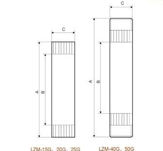

ÍâÐͳߴç
ÐͺÅ
ÍâÐͳߴç
A
B
C
LZM-15G
210
180
32
LZM-20G
278
236
45
LZM-25G
265
235
51
LZM-40G
306
236
51
LZM-50G
380
270
75
