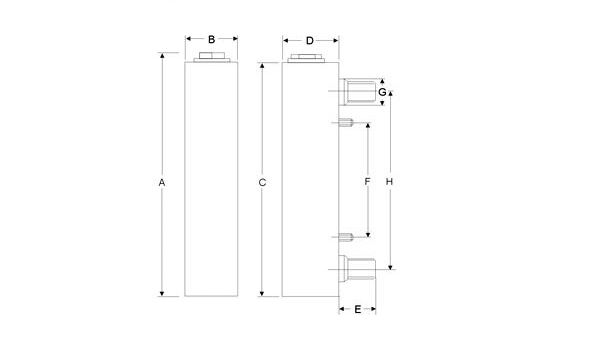

ÍâÐͳߴç
ÐͺÅ
ÍâÐͳߴç
A
B
C
D
E
F
G
H
LZM-15
216
32
206
37
36
100
28
165
LZM-20
233
39
220
44
42
100
37
165
LZM-25
253
44
240
31
100
37
175
