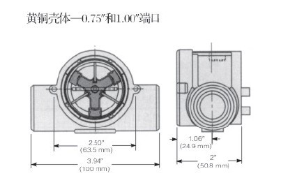

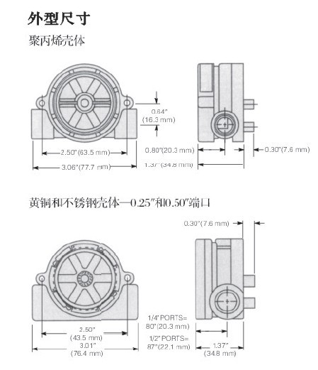

¹¤×÷Ô­Àí£º
1¡¢ µ±ÒºÌåÁ÷¹ýת×ÓÁ÷Á¿´«¸ÐÆ÷µÄʱºò£¬×ª×Ó½«ÒÔÓëÁ÷Á¿³Ç±ÈÀýµÄËÙ¶Èת¶¯¡£
2¡¢ ×ª×ÓÐÍÁ÷Á¿Ö¸Ê¾¼Æ°²×°Ê±£¬¿É½«ÈÎÒâÒ»¶Ë×÷ΪÁ÷ÌåÈë¿Ú¡£µ±Á÷Á¿ÖµºÜµÍʱ£¬×îºÃʹ³öÈë¿ÛλÓÚת×ÓµÄÉÏ·½£¬²¢Ë®Æ½°²×°¡£
¶¨¹ºÖ¸ÄÏ
¶ÔÓÚ±ê×¼ÅäÖ㬸ù¾Ý¿ÇÌå²ÄÖʺͶ˿ڳߴçÈ·¶¨²¿¼þºÅ¡£
¿ÇÌå²ÄÁÏ
¶Ë¿Ú³ß´çNPT
Á÷Á¿·¶Î§£­GPM
²¿¼þºÅ
µÍ·¶Î§£¨¾«¶È£©
±ê×¼·¶Î§£¨¾«¶È£©
¾Û±ûÏ©
0.25"
0.1¡«1.0
0.5¡«5.0
155420
0.50"
1.5¡«12.0
4.0¡«20.0
155480
»ÆÍ­
0.25"
0.1¡«1.0
0.5¡«5.0
142541
0.50"
1.5¡«12.0
4.0¡«20.0
142542
0.75"
5.0¡«30.0
180392
1.00"
8.0¡«60.0
181681
²»Ðâ¸Ö
9/16"-18
0.1¡«1.0
0.5¡«5.0
174596
0.50"
1.5¡«12.0
4.0¡«20.0
173138
0.75"
5.0¡«30.0
181682
1.00"
8.0¡«60.0
181683
