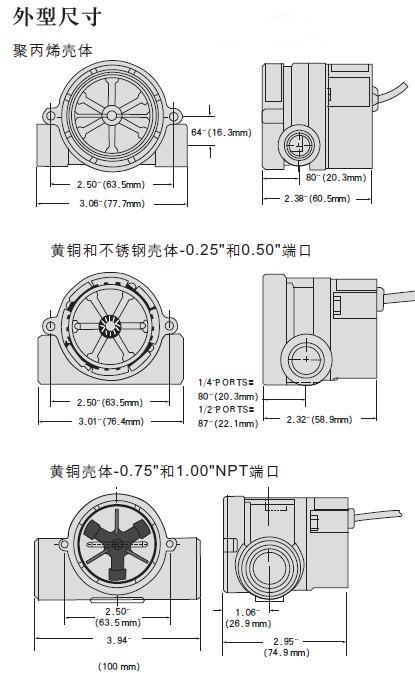

ÐÔÄܲÎÊý
º¸½Ó²ÄÖÊ
¿ÇÌå
»ÆÍ­¡¢316²»Ðâ¸Ö»ò¾Û±ûÏ©£¨Ë®½âÎȶ¨£¬²£Á§Ç¿»¯£©
ת×ÓÖá
ÌÕ´É
ת×Ó
PPSºÏ³ÉÎºÚÉ«
¾µÍ·
Poylsulfone
OÐÍȦ
Viton£¨·ú»¯Ï𽺣©£¨ºÏ½ð¿ÇÌ壩£»¶¡ëæÏ𽺣¨¾Û±ûÏ©¿ÇÌ壩
µÍÁ÷Á¿ÊÊÅäÆ÷
²£Á§Ç¿»¯¾Û±ûÏ©
×î¸ß¹¤×÷ѹÁ¦
Í­»ò²»Ðâ¸Ö¿ÇÌå
200 Psig@70¨H,100Psi Max@212¨H
¾Û±ûÏ©¿ÇÌå
100 Psig@70¨H,40Psi Max@180¨H
×î¸ß¹¤×÷ζÈ
Í­»òÕß²»Ðâ¸Ö¿ÇÌå
¾Û±ûÏ©¿ÇÌå
£­20¡«212¨H£¨£­29¡«100¡ãC£©
£­20¡«180¨H£¨£­29¡«82¡ãC£©
µçÆ÷²¿·Ö¹¤×÷ζÈ
»·¾³Î¶È150¨H£¨65¡ãC£©
Õ³¶È
200SSU
ÊäÈëµçÔ´
24VDC,¡À10%
Êä³öÐźÅ
0¡«10VDC@1mA£¬MAX
¾«¶È
²Î¼ûÏÂÒ³±í¸ñ
ÎüÈëµçÁ÷
25mA£¬MAX
Êä³öµçÁ÷
70mA,Max
ƵÂÊÊä³ö·¶Î§
15Hz(µÍÁ÷Á¿)¡«225£¨¸ßÁ÷Á¿£©
µçÆøÁ¬½Ó
22AWG PVC»¤Ì×£¬24"µçÀ£¬É«±ê´úÂ룺ºì£½£«VDC,ºÚ£½½ÓµØ£¬°×£½ÐźÅÊä³ö
¶¨¹ºÖ¸ÄÏ
¶ÔÓÚ±ê×¼ÅäÖ㬸ù¾Ý¿ÇÌå²ÄÖʺͶ˿ڳߴçÈ·¶¨²¿¼þºÅ¡£
¿ÇÌå²ÄÁÏ
¶Ë¿Ú³ß´çNPT
Á÷Á¿·¶Î§£­GPM
µÍ·¶Î§£¨¾«¶È£©
²¿¼þºÅ
±ê×¼·¶Î§£¨¾«¶È£©
²¿¼þºÅ
¾Û±ûÏ©
0.25"
0.1¡«1.0(¡À7%)
170290
0.5¡«5.0(¡À7%)
170280
0.50"
1.5¡«12.0(¡À7%)
170291
4.0¡«20.0(¡À15%)
170281
»ÆÍ­
0.25"
0.1¡«1.0(¡À7%)
170292
0.5¡«5.0(¡À7%)
170282
0.50"
1.5¡«12.0(¡À7%)
170293
4.0¡«20.0(¡À15%)
170283
0.75"
5.0¡«30.0(¡À10%)
180407
1.00"
8.0¡«60.0(¡À15%)
182098
²»Ðâ¸Ö
9/16"-18
0.1¡«1.0(¡À7%)
170295
0.5¡«5.0(¡À7%)
170285
0.50"
1.5¡«12.0(¡À7%)
170296
4.0¡«20.0(¡À15%)
170286
0.75"
5.0¡«30.0(¡À10%)
182097
1.00"
8.0¡«60.0(¡À15%)
182099
