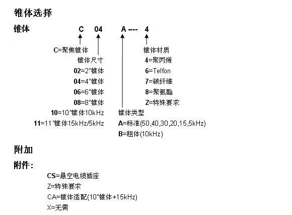

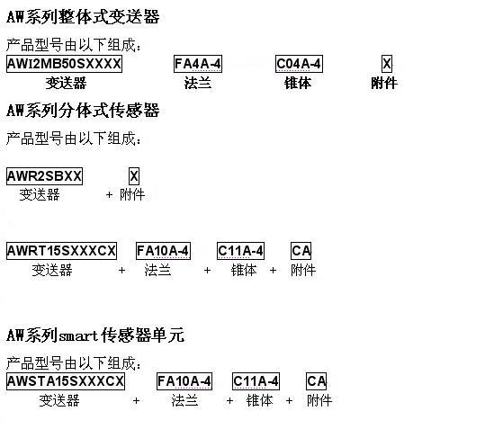

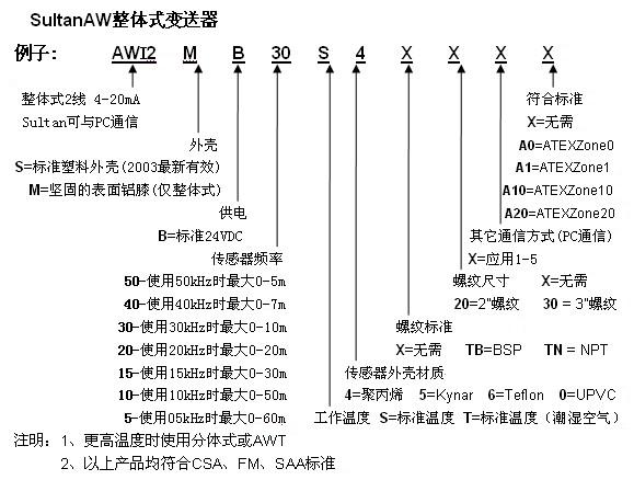

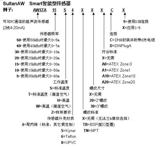

             SULTAN2ϵÁзǽӴ¥Ê½³¬Éù²¨Îïλ¼Æ
¡ô¹ÌÌå/ÒºÌåÎïλ ²âÁ¿·¶Î§¿É´ï192Ã×
¡ô¹©µç·½Ê½£º     2Ïß»ØÂ·¹©µç.
¡ôͨÓô«¸ÐÆ÷ÊäÈë:
                 50kHz, 40kHz, 30kHz, 20kHz, 15kHz, 10kHz, 5kHz.
¡ôÖÊÁ¿ÈÏÖ¤:
                 CE, ATEX, SAA, FM, CSA
¡ôGSM/CDMA¹¦ÄÜ
¡ôͨÐÅ·½Ê½:      GOSHAWK, HART
       SULTAN2ϵÁг¬Éù²¨Îïλ¼Æ¾ßÓÐÖÚ¶àÏÔ¶øÒ×¼ûµÄÓÅÊÆ¡£²¢ÇÒÓжàÖÖ¿ÉÑ¡µÄ´«¸ÐÆ÷¡£ÊÊÒËÓÚ²âÁ¿¿é×´£¬·Ûĩ״£¬Õ³³íÐÔ¼°´Ì¼¤ÐÔµÄÎïÁÏ£¬´«¸ÐÆ÷Óë±»²âÎïÁÏÖ®¼äÎÞÖ±½Ó½Ó´¥¡£ÔÊÐíÒÔ2Ïß·½Ê½¹©µç£¨12V - 30VDC£©¡£

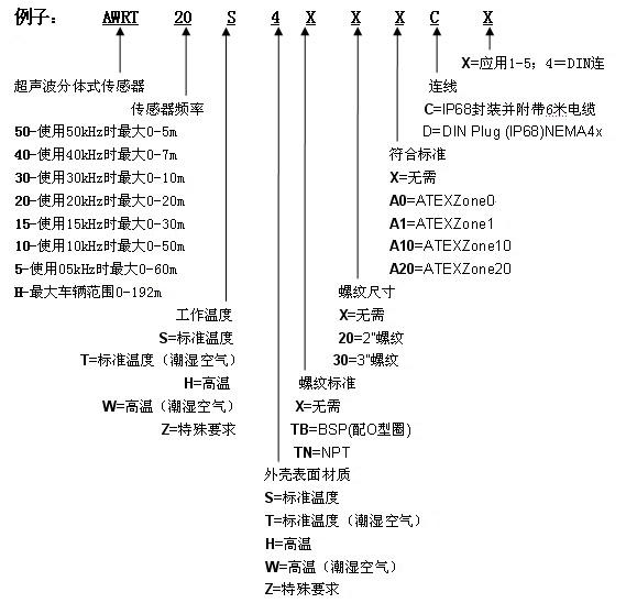

¼¼Êõ²ÎÊý
ƵÂÊ
5kHz, 10kHz, 15kHz, 20kHz, 30kHz, 40kHz, 50kHz
¹¤×÷µçѹ
12 - 30Vdc £¨ÎƲ¨µçѹ²»¸ßÓÚ100mV£©
¹¦ÂÊ
<10w @ 24Vdc
Ä£ÄâÁ¿Êä³ö
4 -20mA £¨750ohms User supply 24Vdc£©
ͨÐÅ
GOSHAWK, HART
Ã¤Çø
50kHz = 0.25 m £¨10"£©    40kHz = 0.30m £¨12"£©
30kHz = 0.35 m £¨14"£©    20kHz = 0.45m £¨17"£©
15kHz = 0.60m £¨24"£©     10kHz = 1.0m £¨39"£©
05kHz = 1.5m £¨59"£©
×î´ó²âÁ¿·¶Î§
5m £¨16ft£© 50kHz ÒºÌå     7m £¨22ft£© 40kHz ÒºÌå
10m £¨33ft£© 30kHz ÒºÌå 5m £¨16ft£© ¹ÌÌå
20m £¨65ft£© 20kHz ÒºÌå/Äཬ, 10m £¨33ft£© ¹ÌÌå
30m £¨98ft£© 15kHz ÒºÌå/Äཬ, 20m £¨65ft£© ¹ÌÌå
50m £¨165ft£© 10kHz ÒºÌå/Äཬ/·Û/¹ÌÌå
60m £¨196ft£© 5kHz ÒºÌå/Äཬ/·Û/¹ÌÌå
192m £¨392ft£© ²Î¿´ Sultan 234H £¨¸ßÄÜÁ¿ÐÍ£©
·Ö±æÂÊ
1mm £¨0.04 in£© 50kHz/40kHz/30kHz/20kHz
4mm £¨0.20 in£© 15kHz/10kHz/5kHz

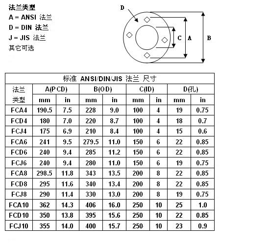

°²×°
ANSI, JIS or DIN ·¨À¼
4 in/100mm or 10 in/250mm
2in or 3in BSP ÂÝÎÆ / NPT ÂÝÎÆ
