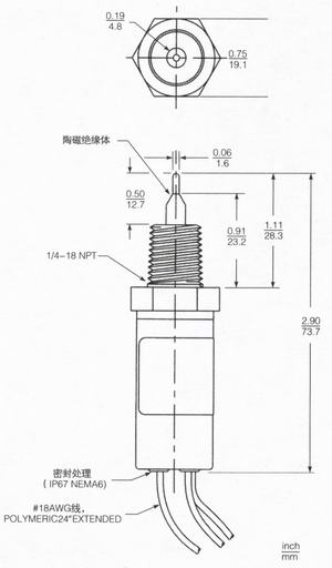

³ß´çͼ

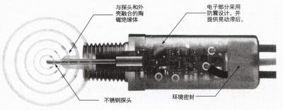

¹¤×÷Ô­Àí
       Gems Silver BulletҺλ´«¸ÐÆ÷ÊÇÒ»ÖÖÓÃÀ´Ì½²âÓÐÎ޵絼ҺµÄ¹Ì̬װÖá£Ã¿¸ö´«¸ÐÆ÷¶¼´øÓÐÒ»Ì廯µÄ¸ßÎÂÐ͵ç×ÓÏß·¡£Õâ¸öµç·ÔÚ²»Ðâ¸ÖÕëÉÏÊ©¼Ó½»±äµçѹ¡£Èç¹ûÓ͵絼Һ£¬Ôòµç·µ¼Í¨£¬´Ó¶ø¸Ä±ä¾§Ìå¹ÜµÄÊä³ö¡£Êä³öµÄÑ¡ÏîÓкܶàÖÖ£¬¿ÉÒÔÓÃÀ´Çý¶¯¼ÌµçÆ÷£¬Ö¸Ê¾µÆ»ò·¢¹â¶þ¼«¹Ü£¬Ò²¿ÉÒÔ¼æÈÝCMOS/TTLÂß¼­µç·£¬PLC»ò΢´¦ÀíÆ÷µÈ

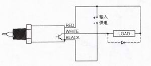

½ÓÏßͼ
