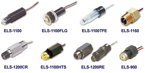

²úÆ·Ãû³Æ£º ELS-1100HT¹âµçҺλ¿ª¹Ø
ÐÍ ºÅ£º ELS-1100HT
      ¸ÃϵÁÐÄ͸ßβúÆ·£¨HT£©ÓÉÒ»ÖÖ¸ßÐÔÄܵÄsoplastËÜÁÏÖÆ³É£¬Ìå»ýÉÔ´óÓÚELS-1100.ÕâÀà²úÆ·²»µ«»¯Ñ§Îȶ¨ÐÔÇ¿£¬»¹ÄܳÐÊܸߴï212¨HµÄÒºÌåζȡ£½Ó¿Ú²ÉÓÃ3/8"NPT£¬ÇÒHTSϵÁвúÆ·ÊÇGemsËùÓйâµç¿ª¹ØÖÐ×î¶ÌСµÄÒ»¿î£¬½öÓÐ1/2"³¤¡£
