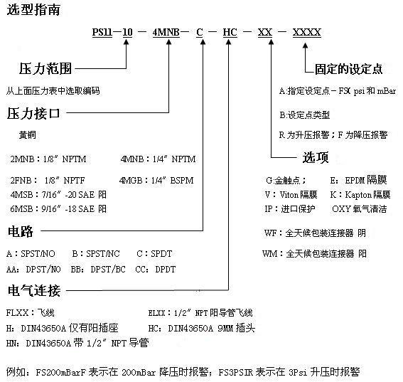

ѹÁ¦Á¿³Ì±í
ѹÁ¦Á¿³Ì±àÂë
ѹÁ¦·¶Î§
ƽ¾ùËÀÇø
10
 0.55¡«3.5psi£¨37.9¡«241.3mbar£©
0.07¡«0.2psi£¨5¡«15mbar£©
20
3¡«12psi£¨206.8¡«827.4mbar£©
0.3¡«0.6psi£¨20¡«45mbar£©
³ß´çͼ
×¢ÊÍ£º
1¡¢  ÆäËûÁ¬½ÓÆ÷¿ÉÑ¡£¬ÇëÓ빤³§ÁªÏµ¡£
2¡¢  DIN²åÍ·±ØÐëΪ£­C SPDT»ØÂ·
3¡¢  18¡åÊDZê×¼³¤¶È£¬¿ÉÒÔ¶¨ÖÆÌØÊâµÄµçÀ³¤¶È£¨×48¡å£©ÀýÈ磺FL18»òÕßFLS30
4¡¢ Èë¿Ú±£»¤ÒªÈ·¶¨É趨µã£­FS¡£
5¡¢ É趨µã±ØÐëÔÚÑ¡ÔñµÄѹÁ¦·¶Î§ÄÚ¡£
