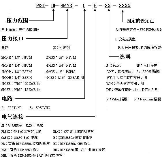

³ß´çͼ:
Ñ¡ÐÍÖ¸ÄÏ
ÀýÈ磺FS0.5BarF±íʾÔÚ0.5¹¥»÷½µÑ¹Ê±±¨¾¯£»FS3PSIR±íʾÔÚ5psiÉýѹʱ±¨¾¯
×¢ÊÍ£º
1¡¢  ÆäËûÁ¬½ÓÆ÷¿ÉÑ¡£¬ÇëÓ빤³§ÁªÏµ¡£
2¡¢  ÒªÇó£­10A»ò£­GÑ¡Ôñ
3¡¢  18¡åÊDZê×¼³¤¶È£¬¿ÉÒÔ¶¨ÖÆÌØÊâµÄµçÀ³¤¶È£¨×48¡å£©ÀýÈ磺FL18»òÕßFLS30
4¡¢  18¡åÊDZê×¼¡£ÌØÊâµÄµçÀ³¤¶È¿ÉÑ¡£¨×48¡å£©¡£ÀýÈ磺£­EL18»òEL30
5¡¢  36¡å×îС£¬¿ÉÒÔÑ¡ÔñµçÀ³¤¶È¡£ÀýÈ磺CAB36»òCAB120.
6¡¢  DIN²åÍ·±ØÐëΪ£­C SPDT»ØÂ·
7¡¢  Ñ¡Ï10A£¬£­G»òRD²»ÄÜͬʱѡÔñ¡£
8¡¢ ÒªÇó£­FL,FLS»ò-CABµçÆø¶Ë×Ó£¬IP±£»¤±ØÐëÑ¡Ôñ¹Ì¶¨µÄÉ趨µã£­FS¡£
9¡¢ É趨µã±ØÐëÔÚµÚÒ»²½Ñ¡ÔñµÄѹÁ¦·¶Î§ÄÚ¡£
