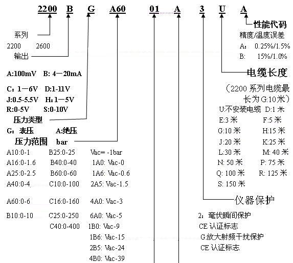

Öлª¹¤¿ØÍø ¡ú ¹¤¿Ø²úÆ· ¡ú 2200&2600ѹÁ¦±äËÍÆ÷
²úÆ·Ãû³Æ£º 2200&2600ѹÁ¦±äËÍÆ÷
ÐÍ ºÅ£º 2200&2600
                                 2200&2600ѹÁ¦±äËÍÆ÷
¡ô¿ÉÌṩ±íѹ¡¢¾øÑ¹¡¢Õæ¿ÕºÍ¸´ºÏѹÁ¦µÈ¸÷ÖÖÐͺÅ
¡ôͶÈëʽ¡¢Í¨ÓÃÐÍ¡¢³åÏ´ÐÍÍâ¿Ç
¡ô²ÉÓÃCVD´«¸ÐÔª¼þÌṩ¸ßÎȶ¨ÐÔ
¡ô¿ÉÌṩºÁ·ü¡¢µçѹºÍµçÁ÷Êä³ö¸÷ÖÖÐͺÅ
      2200CϵÁкÍ2600ϵÁвúÆ·¸»ÓÐÎȶ¨ÐÔ¡¢¾«È·ÐÔ£¬²¢ÓжàÖÖÍâ¿Ç¿É¹©Ñ¡Ôñ¡£2600ϵÁÐΪÂú×ãDZˮºÍ¹¤ÒµÓ¦ÓÃÐèÇóÌṩȫº¸½Ó²»Ðâ¸Öºó¶Ë£¬À©Õ¹ÁË·â×°Ñ¡Ôñ¡£2200ϵÁкÍ2600ϵÁоù²ÉÓþ­Êµ¼ùÖ¤Ã÷Ϊ¿É¿¿µÄCVD´«¸Ð¼¼Êõ£¬²¢ÅäÓÐASIC(ÌØ¶¨ÓÃ;¼¯³Éµç·)£¨·Å´ó×°Ö㩺ÍÄ£¿é·â×°£¬Ê¹´«¸ÐÆ÷Éú²úÏßÄÜÊÊÓ¦¸÷ÖÖÓ¦Ó㬲¢¶ÔÌØÊâÒªÇóÒ×½øÐе÷½Ú¶ø²»ËðÉË´«¸ÐÆ÷µÄ¸ßÐÔÄÜ¡£

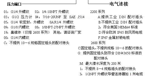

µçÆøÁ¬½Ó´úÂë
½ÓÏß´úÂë
µçÁ÷Êä³ö4£­20mA
µçѹÊä³ö
½ÓµØ
ÊäÈ룫
¹«ÓÃ
Êä³ö£«
½ÓµØ
A,B,G¹¤ÒµDIN
²å½Å
1
2
4
1
2
3
4
C 10£­6¿¨¿Ú
²å½Å
A
B
E
A
C
B
E
D µçÀÂ
R
BK
ÆÁ±ÎÏß
R
BK
W
ÆÁ±ÎÏß
F IP67µçÀÂ
R
BK
ÆÁ±ÎÏß
R
BK
W
ÆÁ±ÎÏß
1 8£­4¿¨¿Ú
²å½Å
A
B
D
A
C
B
D
3 µ¼¹ÜÓëµçÀÂ
R
BK
ÆÁ±ÎÏß
R
BK
W
ÆÁ±ÎÏß
M ͶÈëʽIP68ÖÁ200Ã×
R
BL
ÆÁ±ÎÏß
R
W
Y
ÆÁ±ÎÏß
R£½ºìÉ«£¬BL=À¶É«£¬BK=ºÚÉ«£¬W=°×É«£¬G=ÂÌÉ«£¬Y=»ÆÉ«
½ÓÏß´úÂë
µçÁ÷Êä³ö4£­20mA
ÊäÈ룫
Êä³ö£«
Êä³ö£­
ÊäÈ룭
A,B,G¹¤ÒµDIN
²å½Å
1
2
3
E
C 10£­6¿¨¿Ú
²å½Å
A
B
C
D
D µçÀÂ
R
Y
BL
G
F IP67µçÀÂ
R
Y
BL
G
1 8£­4¿¨¿Ú
²å½Å
A
B
C
D
3 µ¼¹ÜÓëµçÀÂ
R
W
G
BK
M ͶÈëʽIP68ÖÁ200Ã×
R
W
G
BK
