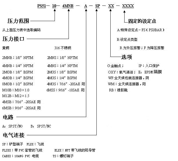

ѹÁ¦±í
ѹÁ¦Á¿³Ì±àÂë
ѹÁ¦·¶Î§
15
50£­150Psi£¨3.45£­10.3bar£©
20
150£­300Psi£¨10.3£­20.7bar£©
Ñ¡ÐÍÖ¸ÄÏ
ÀýÈ磺FS5BarF±íʾÔÚ0.5bar½µÑ¹Ê±±¨¾¯£»FS20PSIR±íʾÔÚ20psiÉýѹʱ±¨¾¯
×¢ÊÍ£º
1¡¢  ÆäËûÁ¬½ÓÆ÷¿ÉÑ¡£¬ÇëÓ빤³§ÁªÏµ¡£
2¡¢  18¡åÊDZê×¼³¤¶È£¬¿ÉÒÔ¶¨ÖÆÌØÊâµÄµçÀ³¤¶È£¨×48¡å£©ÀýÈ磺FL18»òÕßFLS30
3¡¢  36¡å×îС£¬¿ÉÒÔÑ¡ÔñµçÀ³¤¶È¡£ÀýÈ磺CAB36»òCAB120.
4¡¢  IPÑ¡Ïî½öÊÊÓÃÓÚ£­FL,-FLS»òCABµçÆøÁ¬½Ó
5¡¢ É趨µã±ØÐëÔÚÑ¡ÔñµÄѹÁ¦·¶Î§ÄÚ¡£
