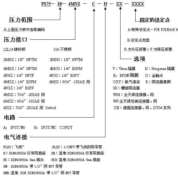

Ñ¡ÐÍÖ¸ÄÏ
ÀýÈ磺FS1BarF±íʾÔÚ1bar½µÑ¹Ê±±¨¾¯£»FS20PSIR±íʾÔÚ20psiÉýѹʱ±¨¾¯
×¢ÊÍ£º
1¡¢  ¶àÖÖ°²×°·½Ê½¿ÉÑ¡£¬ÇëÓ빤³§ÁªÏµ¡£
2¡¢  ÒªÇóFL»òELµçÆøÁ¬½Ó
3¡¢  18¡åÊDZê×¼³¤¶È£¬¿ÉÒÔ¶¨ÖÆÌØÊâµÄµçÀ³¤¶È£¨×48¡å£©ÀýÈ磺FL18»òÕßFLS30
4¡¢  18¡åÊDZê×¼³¤¶È£¬¿ÉÒÔ¶¨ÖÆÌØÊâµÄµçÀ³¤¶È£¨×48¡å£©ÀýÈ磺EL18»òÕßELS30
5¡¢  36¡å×îСֵ£¬¿ÉÒÔÑ¡ÔñµçÀ³¤¶È¡£ÀýÈ磺CAB36»òCAB120.
6¡¢  DINÁ¬½ÓÆ÷±ØÐëÊÇ£­C SPDTµç·ѡÔñ¡£
7¡¢  ÒªÇó²»Ðâ¸ÖѹÁ¦½Ó¿Ú.
8¡¢É趨µã±ØÐëÔÚÑ¡ÔñµÄѹÁ¦·¶Î§ÄÚ¡£
