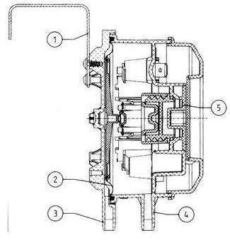

½á¹¹Í¼
1¡¢¹Ì¶¨¼Ü  2¡¢¸ôĤ  3¡¢P1Á¬½Ó½Ï¸ßѹÁ¦»ò½ÏµÍÕæ¿Õ
4¡¢P2Á¬½Ó½ÏµÍѹÁ¦»ò½Ï¸ßÕæ¿Õ5¡¢É趨¿Ì»­
