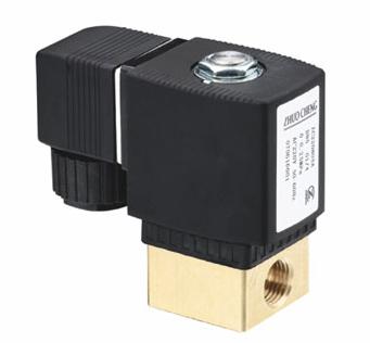

²úÆ·Ãû³Æ£º ¶þλ¶þֱͨ¶¯µç´Å·§
ÐÍ ºÅ£º ZC
              ¶þλ¶þͨ£¬¶þλÈýֱͨ¶¯½ô´ÕÐ͵ç´Å·§
                                          ZC220802A
                               ZC220805A
ͼÐηûºÅ
²úƷ˵Ã÷
±¾ÏµÁеç´Å·§¾ßÓУ¬Æô¶¯¶¯×÷Ãô½Ý£¬¿É¿¿ÐԸߣ¬Ê¹ÓÃÊÙÃü³¤£¬ÊÊÓÃÓÚ¸÷ÖÖ½éÖÊÈç£¨ÃºÆø£¬Ë®£¬ÓÍÆ·£¬Ñ¹Ëõ¿ÕÆø£©¡£¹ã·ºÓ¦ÓÃÓÚ¿Õѹ»ú£¬ÃºÆøÔî¾ßµÈ¡£ÒÔϹæ¸ñ¿ÉÒÔ×ö£¬¸ßÎÂ180¡æ£¬·À±¬ÐÍ£¬¶¨Ê±£¬·§Ìå¿ÉÑ¡»ÆÍ­»ò²»Ðâ¸Ö£¬ÌØÊâ¹æ¸ñ¿É¶¨×ö£¬²¿·Ö¿ÉÑ¡×ö³£¿ª¡£

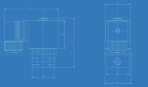

³ß´çͼ
³ß´ç
ÐͺÅ/¶©»õºÅ
A
B
C
D
E
F
G
ZC220601-A
32
40
67
77
36
32
35
ZC220602-A
ZC220803-A
46
69
ZC220804-A
ZC220805-A
ZC230601-A
32
67
ZC230602-A
ZC230801-A
75
ZC230802-A
