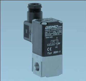

²úÆ·Ãû³Æ£º 320µç´Å·§
ÐÍ ºÅ£º 320
                  320ËÜÁϵç´Å·§
¹¤×÷½éÖÊ
»¯Ñ§¶èÐÔÆøÌå
ζȷ¶Î§
-15¡æ¡«50¡æ
¹¤×÷ѹÁ¦
0¡«10bar
Íⲿ»·¾³Î¶È
-20¡æ¡«50¡æ
ËÙÂÊ
²»¼ä¶ÏËÙÂÊ
ÏûºÄµçÁ¿
8¡«18VA
µçÆøÁ¬½Ó
±ê×¼Á¬½Ó²å×ù£¬DIN EN 175301-803
KVÖµ
³£±Õ  1.2l/min
³£¿ª   1.2l/min
ÖØÁ¿
220g
×î´ó¿ª¹ØÆµÂÊ
3600´Î/h
¿ª¹ØÊ±¼ä
20ms
ÈÝÐíµçѹÎó²î
-10/+6%
±£»¤¼¶±ð
IP 65
