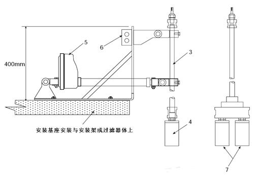

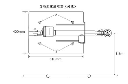

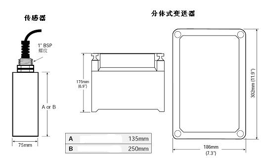

ÍâÐγߴç
1
°²×°»ù×ù£¨²»Ðâ¸Ö£© 7
2
°²×°¿× (10mm)
3
´«¸ÐÆ÷°²×°¹Ü
4
´«¸ÐÆ÷
5
µç¶¯»ú
6
´«¸ÐÆ÷Ä©¶ËÍâ¿Ç
7
¶ÀÌØµÄС²âÁ¿Ã¤Çø

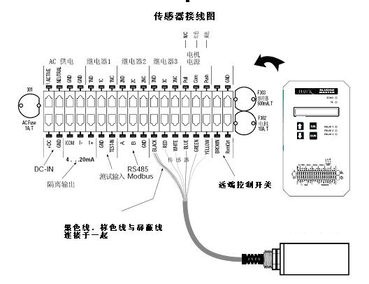

µçÆøÁ¬½Ó
