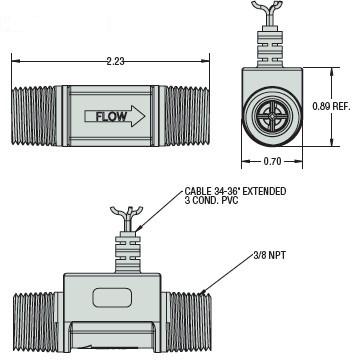

ÐÔÄܲÎÊý
Íâ¿Ç
ÄáÁú12
ÎÐÂÖ
ÄáÁú12ºÏ³ÉÎï
Öá³Ð
316²»Ðâ¸Ö
¹¤×÷ѹÁ¦
200 PSI
ÆÆÁÑѹÁ¦
1000 PSI
¹¤×÷ζÈ
-20¡æ~80¡æ
Õ³¶È
32 to 81 SSU£¨1.8 to 16 Centistokes£©
¹ýÂËÆ÷
£¼50΢Ã×

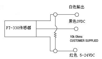

¹©µçµçѹ
5~24VDC@8mA
¾«¶È
¡À2%
ÖØ¸´ÐÔ
0.5%FS
½Ó¿Ú
3/8¡± NPTÑôÂÝÎÆ
µçÆøÁª½Ó
3Ó¢³ßPVCµçÀÂ
³ß´ç
½ÓÏß·½Ê½
