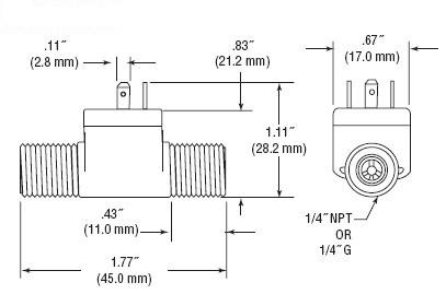

½Ó¿Ú
1/4¡± NPTÑôÂÝÎÆ£¨¿ÉÑ¡G1/4¡±ÑôÂÝÎÆ£©

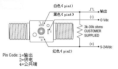

µçÆøÁª½Ó
9.4ºÁÃ×¼ä¸ô3ÕëDIN½ÓÍ·£¨1¡±¸ß£©
³ß´ç
½ÓÏß·½Ê½

1Ã׳öÏߣ¬Åä10Kµç×è
