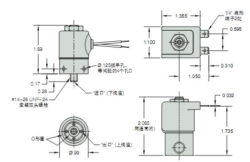

                              AϵÁв»Ðâ¸ÖÁ½Í¨¡¢Èýͨ·§
¡ôMOPD:1000PSI
¡ôCV·¶Î§£º0.019µ½0.3
¡ô6W

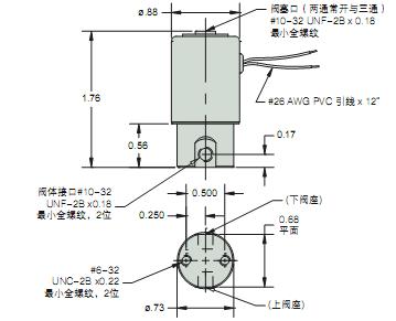

³ß´ç
ÂÝÎÆ½Ó¿Ú·§Ìå
¼¯¹Ü°²×°·§Ìå                                                  Ä£ÖÆÏßȦ
Ìæ»»1/2£¢µ¼¹Ü¿Ç
ËùÓз§ÌåÅäÖþù¿É²ÉÓÃ
·§Èû½Ó¿Ú

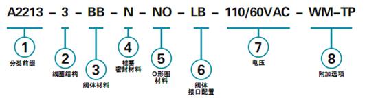

ÈçºÎ¶©¹º
ʹÓÃÏÂҳѡÏîÖеĴÖÌå×ÖÌå×é³É²úÆ·´úÂë¡£
˵Ã÷£º·ÖÀàǰ׺ºó£¬ËùÓС°¡ª´úÂëÈç¹ûÊǹ涨µÄ±ê×¼£¨¿Õ£©Ñ¡Ôñ£¬Ôò¿É±£Áô¿Õ°×¡£¡±
¾ÙÀý
A2213-3-BB-N-NO-LB-110/60VAC-WM-TP
Á½Í¨³£¿ª£¨´ø1/8£¢-27NPT·§Èû¿Ûת½ÓÍ·£©µç´Å·§£¬»ÆÍ­·§Ì壬Âȶ¡Ïð½ºÖùÈûÃÜ·âȦ£¬Âȶ¡Ïð½ºOÐÎȦ£¬1/4£¢-18FNPT·§Ìå½Ó¿Ú£¬¹¤×÷µçѹ/ƵÂÊΪ110/60VAC/Hz£¬¿ÉÑ¡Ôñ¹Ì¶¨ÍмܺÍÍ¿ÓÐPTFEÖùÈûÑ¡Åä¼þ¡£

¢ÚÏßȦ½á¹¹
£¨¿Õ°×£©=½º´ø²øÈÆ£¬B¼¶£¬ÅäÖÃÒýÏߣ¨³¤¶È18£¢£©*
  W---- =½º´ø²øÈÆÒýÏßÏßȦ£¬·Ç±ê³¤¶È£¨Ö¸¶¨³¤¶È£©
    1M=ģѹÏßȦ£¬B¼¶£¬ÅäÖÃÒýÏß
    2M=ģѹÏßȦ£¬F¼¶£¬ÅäÖÃÒýÏß
    3M=ģѹÏßȦ£¬H¼¶£¬ÅäÖÃÒýÏß
    4M=ģѹÏßȦ£¬B¼¶£¬ÅäÖÃ1/4£¢±âÐζË×Ó
    5M=ģѹÏßȦ£¬F¼¶£¬ÅäÖÃ1/4£¢±âÐζË×Ó
    6M=ģѹÏßȦ£¬H¼¶£¬ÅäÖÃ1/4£¢±âÐζË×Ó
     4=·â×°ÏßȦ¡£B¼¶£¬ÅäÖÃ3/16£¢±âÐζË×Ó
     5=·â×°ÏßȦ¡£B¼¶£¬ÅäÖÃ0.110£¢±âÐζË×Ó
     8=·â×°ÏßȦ¡£F¼¶£¬ÅäÖÃ3/16£¢±âÐζË×Ó
    10=ÍⲿÕûÁ÷ÏßȦ£¨½öÏÞÒýÏߣ©
     11=½º´ø²øÈÆÏßȦ£¬H¼¶£¬ÅäÖÃÒýÏß
    HC=Ä£ÖÆÏßȦ£¬F¼¶£¬EN175301-803 BÐÍ£¬¹¤ÒµÓã¬11mm£¬2+1¼«
   HC2=·â×°ÏßȦ£¬B¼¶£¬EN175301-803 CÐÍ£¬¹¤ÒµÓã¬9.4mm£¬2+1¼«
¢Û·§Ìå²ÄÁÏ
          £¨¿Õ°×£©=303²»Ðâ¸Ö*
            BB=»ÆÍ­
            SB=304²»Ðâ¸Ö
            SB5=316²»Ðâ¸Ö
            SBF=430F²»Ðâ¸Ö
¢ÜÖùÈûÃÜ·â²ÄÁÏ
           £¨¿Õ°×£©=¶¡ëæÏð½º*
            E=EPR
            GV=ÆûÓÍ·úÏ𽺣¨½öÏÞ˫ͨ·§£©
            N=Âȶ¡Ïð½º
            NS=¶¡ëæÏ𽺣¨NSF/FDA,½öÏÞ˫ͨ·§£©
            PF=È«·ú»¯µ¯ÐÔÌå
            R=Rulon£¨½öÏÞ˫ͨ·§£©
            T=PTFE
            V=Viton
¢ÝO ÐÎȦ²ÄÁÏ
        £¨¿Õ°×£©=¶¡ëæÏð½º
            EO=EPR
            NO=Âȶ¡Ïð½º
          NSO=¶¡ëæÏ𽺣¨NSF/FDA,½öÏÞ˫ͨ·§£©
          PFO=È«·ú»¯µ¯ÐÔÌå
           TO=PTFE
           VO=Viton
¢Þ·§Ìå½Ó¿ÚÅäÖÃ
         £¨¿Õ°×£©=1/8-27NPTÄÚÂÝÎÆ*
              LB=1/4-18NPTÄÚÂÝÎÆ
              BD=#10-32ÄÚ²¿Ö±ÂÝÎÆ£¨×î´ó¿×¾¶=1/8£¢£©
              LT=1/8-28BSPTÄÚÂÝÎÆ£¨½öÏÞ˫ͨ·§£©
              LU=1/4-19BSPTÄÚÂÝÎÆ£¨½öÏÞ˫ͨ·§£©
              MM=·§¿é½Ó¿Ú£¨1/4-28UNF-2A°²×°Ë«Í·ÂÝ˨£©
             MM3=·§¿é½Ó¿Ú£¨5/16-24UNF-2A°²×°Ë«Í·ÂÝ˨£©
              OB=Omit·§Ì壨²Ù×÷Աʽ£©
              MB=µ×²¿¼ÆÁ¿£¨×î´ó¿×¾¶=3/32£¢£©
              BI=µ×²¿ÉÏ·§×ù½Ó¿Ú£¬ÄÚÂÝÎÆ£¨×î´ó¿×¾¶1/8£¢£©
           BIM=µ×²¿ÉÏ·§×ù½Ó¿Ú£¬1/8-27NPTÍâÂÝÎÆ£¨×î´ó¿×¾¶5/64£¢£¬½öÏÞ»ÆÍ­·§Ì壩
              BO=µ×²¿Ï·§×ù½Ó¿Ú£¬ÄÚÂÝÎÆ
          BOM=µ×²¿Ï·§×ù½Ó¿Ú£¬1/8-27NPTÍâÂÝÎÆ£¨×î´ó¿×¾¶=1/8£¢,½öÏÞ»ÆÍ­·§Ì壩
              BL=90¡ã½Ó¿ÚÁ¬½Ó-×óÊÖ
                RR=90¡ã½Ó¿ÚÁ¬½Ó-ÓÒÊÖ
                BS=·§Èû½Ó¿Ú£¬#10-32ÄÚ²¿Ö±ÂÝÎÆ
¢ßµçѹ++£¨¼ûÏÂÃæµÄ˵Ã÷£©
          ----VDC=DC£¨Ö¸¶¨Ö±Á÷µçѹ£©
          ----VAC=AC£¨Ö¸¶¨½»Á÷µçѹ£¬°üÀ¨Í­ÖÆÆÁ±Î»·£©
¢à¸½¼ÓÑ¡Åä¼þ
              Y=·§Ìå
             WM=°²×°¼Ü
             TP=PTFEÍ¿²ãÖùÈû
             AD=1/8-27NPT·§Èû¿Û½ÓÍ·£¨½öÈýͨ·§£©
             QO=¾²ÒôÔËÐУ¨½ö˫ͨ·§£©
               S=ÒøÆÁ±Î»·
             OC=Çå½à´¦Àí£¬ÓÃÓÚÊäËÍÑõÆø
            VAC=ÓÃÓÚÕæ¿Õ×÷Òµ£¨0µ½29.5*Hg£©
              G1=Ò»Ìåʽ303²»Ðâ¸Ö·§¸Ëµ¼³Ð
              G5=Ò»Ìåʽ316²»Ðâ¸É·§¸Ëµ¼³Ð
*³ý·ÇÁíÓÐ˵Ã÷£¬·ñÔòʹÓñê׼ѡÔñ¡£±ê׼ѡÔñ²»»áÁÐÔÚ×îÖÕµÄÁã¼þºÅÖС£
˵Ã÷£º
1.       ÓйØËÜÁÏ·§Ìå²ÄÁÏ£¬ÇëÓëGemsÁªÏµ¡£
2.       ¿É²ÉÓò»´øÆÁ±Î»·µÄÕûÁ÷·½Ê½¡£Ê¹ÓÃÏßȦ½á¹¹´úÂë10.
3.       Teflon OÐÎȦ²»ÊÊÓÃÓÚ·§¿é½ÓÍ·¡£
