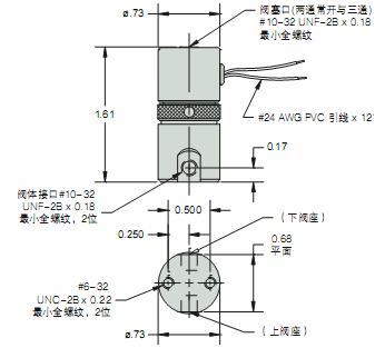

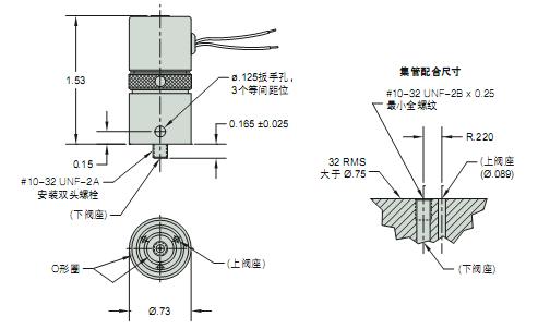

³ß´ç
ÂÝÎÆ½Ó¿Ú·§Ìå
¼¯¹Ü°²×°·§Ìå

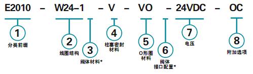

ʹÓÃÏÂҳѡÏîÖеĴÖÌå×ÖÌå×é³É²úÆ·´úÂë¡£
¿Õ°×ÊäÈë±íʾ¡°±ê×¼¡±Ñ¡Ôñ£¨ÀýÈ磬#10-32Ö±ÂÝÎÆ½Ó¿Ú£©.
¾ÙÀý
E2010-W24-1-V-VO-24VDC-OC
E-ϵÁÐÁ½Í¨³£±Õµç´Å·§£¬·â×°ÏßȦ´ø24¡±ÒýÏߣ¬¶ÆÄø»ÆÍ­·§Ì壬VitonÖùÈûÃÜ·â¼þ£¬Viton OÐÎȦ£¬#10-32Ö±ÂÝÎÆ½Ó¿Ú£¬¹¤×÷µçѹ24VDC£¬Çå½à´¦Àí£¬ÓÃÓÚÊäËÍÑõÆø¡£
¢ÙÁã¼þǰ׺Áбí

¢ÚÏßȦ½á¹¹
  £¨¿Õ°×£©=½º´ø²øÈÆ£¬B¼¶£¬ÅäÖÃÒýÏߣ¨³¤¶È12£¢£©*
         W=ÒýÏߣ¬·Ç±ê³¤¶È£¨Ö¸¶¨³¤¶È£¬µ¥Î»ÎªÓ¢´ç£©
          1=·â×°ÏßȦ
          5=·â×°ÏßȦ£¬ÅäÊÎ0.110±âÐζË×Ó
         10=ÓÃÓÚ½»Á÷µçѹµÄÕûÁ÷ÏßȦ£¨½öÏÞ2W£©
¢Û·§Ìå²ÄÁÏ
  £¨¿Õ°×£©=¶ÆÄø»ÆÍ­*
¢ÜÖùÈûÃÜ·â²ÄÁÏ
   £¨¿Õ°×£©=¶¡ëæÏð½º*
          V=Viton
          E=EPR
         MQ=¹èÏð½º
¢ÝO-Ring Material
    £¨¿Õ°×£©=¶¡ëæÏð½º*
          V=Viton
         EO=EPR
         MQO=¹èÏð½º
¢Þ·§Ìå½Ó¿ÚÅäÖÃ
     £¨¿Õ°×£©=#10-32Ö±ÂÝÎÆ½Ó¿Ú*
         BM=M5¡Á0.8½Ó¿Ú
         MM=·§¿é½Ó¿Ú£¬ÅäÖÃ#10-32˫ͷÂÝ˨
        MM2=·§¿é½Ó¿Ú£¬ÅäÖÃM5¡Á0.8ÖùÂÝ˨
          BO=µ×²¿Ï·§×ù½Ó¿Ú£¨×î´ó¿×¾¶=1/16£¢£©
¢ßµçѹ
     -----VDC=Ö±Á÷£¨Ö¸¶¨µçѹ£©
     -----VAC=½»Á÷ÕûÁ÷£¬½öÏÞ2W£¨Ö¸¶¨µçѹ£©
¢à¸½¼ÓÑ¡Åä¼þ
         OC=Çå½à´¦Àí£¬ÓÃÓÚÊäËÍÑõÆø
         QC=¾²ÒôÔËÐУ¨Á½Í¨³£±Õ£©
        VAC=ÓÃÓÚÕæ¿Õ×÷Òµ£¨0µ½29.5£¢Hg£©
*³ý·ÇÁíÓÐ˵Ã÷£¬·ñÔòʹÓñê׼ѡÔñ¡£±ê׼ѡÔñ²»»áÁÐÔÚ×îÖÕµÄÁã¼þºÅÖС£
