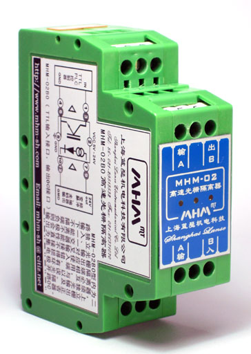

²úÆ·Ãû³Æ£º MHM-02A/B ˫·¸ßËÙ¹âµçñîºÏÆ÷
ÐÍ ºÅ£º MHM-02A/B
MHM-02A/B ˫·¸ßËÙ¹âµçñîºÏÆ÷ ¸ßËÙ¹âÕ¤¸ôÀëÆ÷
GRATING ISOLATING OF PROCESS AND CONTROL SIGNALS
ʹÓÃ˵Ã÷

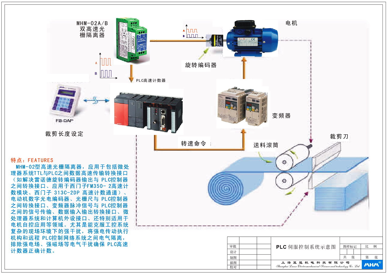

__ A. MHM-02ÐÍ Ë«Â·¸ßËÙ¹âÕ¤¸ôÀëÆ÷£¨¹âµçñîºÏÆ÷ ±àÂëÆ÷ÐźÅת»»Æ÷ ±àÂëÆ÷ÐźÅת»»Ä£¿é£©Ó¦ÓÃÓÚ°üÀ¨Î¢´¦ÀíÆ÷ϵͳTTLÓëPLCÖ®¼äÊý¾Ý¸ßËÙ´«Êäת»»½Ó¿Ú£¨Èç½â¾öÀ×ŵµÂÐýת±àÂëÆ÷Êä³öÓëPLC¿ØÖÆÆ÷Ö®¼äת»»½Ó¿Ú¡¢Ó¦ÓÃÓÚÎ÷ÃÅ×ÓFM350-2¸ßËÙ¼ÆÊýÄ£¿é¡¢Î÷ÃÅ×Ó313C-2DP¸ßËÙ¼ÆÊýͨµÀ£©¡¢µç¶¯»úÊý×Ö¹âµç±àÂëÆ÷¡¢¹âÕ¤³ßÓëPLC¿ØÖÆÆ÷Ö®¼äת»»½Ó¿Ú¡¢±äƵÆ÷Âö³åÐźÅÓëPLC¿ØÖÆÆ÷Ö®¼äµÄÐźŴ«Êä¡¢Êý¾ÝÊäÈë/Êä³öת»»½Ó¿Ú¡¢Î¢´¦ÀíÆ÷ϵͳºÍ¼ÆËã»úÍâÉè½Ó¿Ú¡¢»¹ÌرðÊÊÓÃÓÚµç»ú×Ô¿ØÓ¦ÓõÈÁìÓò¡£ÓÈÆäÊÇÄܿ˷þ¹¤¿ØÏµÍ³¸´ÔÓµÄÏÖ³¡»·¾³ÏµÄÇ¿¸ÉÈÅ£¬½«Ç¿µç´«¶¯Ö´Ðлú¹¹ºÍÔ¶³ÌPLC¿ØÖÆÍøÂçϵͳ֮¼äµçÆø¸ôÀ룬ÅųýÇ¿µç³¡¡¢Ç¿´Å³¡µÈµçÆø¸ÉÈÅ¡£MHM-02Ð͸ßËÙ¹âµçñîºÏÄ£¿é¿ÉÒÔ·Ö¸ôϵͳºÍÓÐЧ±£»¤½ÏΪÃô¸ÐµÄµç·£¬²¢ÇÒ¾ßÓÐÂö³åÕûÐι¦ÄÜ£¬ÓÐЧµØÌá¸ßÁËϵͳ֮¼äµÄ¿¹¸ÉÈÅÐÔÄÜ£¬Îª¹¤Òµ×Ô¶¯»¯¿ØÖÆÏµÍ³Öеĸߵ͵çѹ֮¼äÌṩһ¸öÍêÈ«ÎïÀí¸ôÀëµÄ°²È«½Ó¿Ú¡£ÄÚÖöþ·¶ÀÁ¢¸ôÀëÆ÷¡£
__ B. MHM-02ÐÍË«¸ßËÙ¹âÕ¤¸ôÀëÆ÷³£¹æ²úÆ·ÊäÈ룺ÓÐPLCµçƽ½Ó¿Ú02A¡¢ÓÐTTLµçƽ½Ó¿Ú02B£¬ÊäÈëÓÐÌØÊâµçƽҪÇó¿É¶¨ÖÆ¡£Êä³ö£º³£¹æÎªÍÆÍìÐͺͼ¯µç¼«¿ªÂ·Êä³öÐÍ02AO¡¢02BO£¬»¹Óй̶¨TTLµçƽÊä³ö02AT¡¢02BT£¬ÊäÈëÊä³ö¿É½»²æ×éºÏÈÎѡһÖÖ¡£
__ C. ½á¹¹ÉϲÉÓÃÁËÆ¬×´Ä£¿é¿¨¿Úʽ½á¹¹£¬¿ÉÖ±½Ó¿¨Èë±ê×¼µÀ¹ì°²×°£¬°²×°²ðжά»¤·½±ã¡£¿ÉÒÔ¶àÆ¬½ô´ÕµþºÏ°²×°ÔÚ±ê×¼µÀ¹ìÉÏDIN£¬¿É½ÚÊ¡ºÍÌæ´ú¿ØÖƹñÊäÈë¡¢Êä³ö½ÓÏß¶Ë×Ó¡£

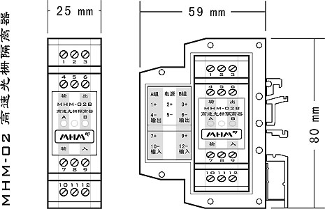

¶þ. ÍâÐγߴç THE OUTSIDE DIMENSIOS
×¢£º

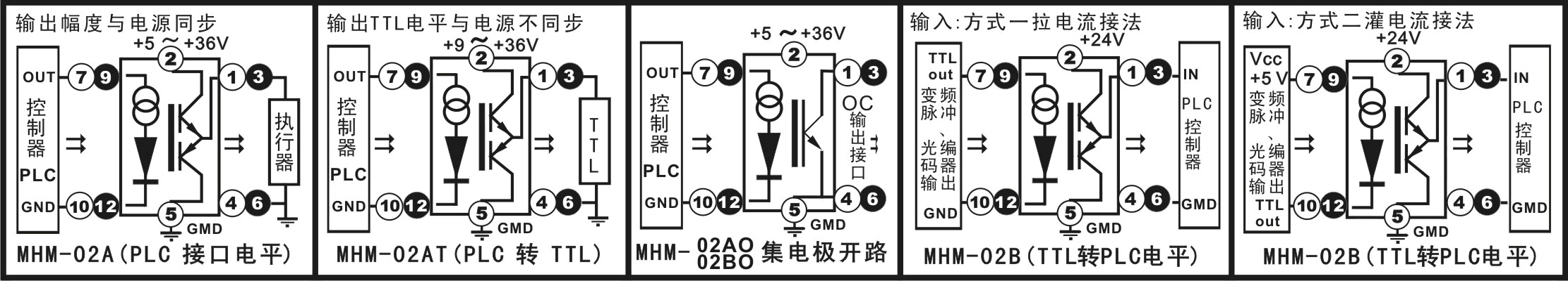

¹âÕ¤¸ôÀëÆ÷ÊäÈë¶ËÓëÊä³ö¶Ë²»ÄÜ½Ó´í£¬ÒÔ¼°Õý¡¢¸º¼«ÐÔ²»µÃÓÐÎó¡£·ñÔò»áÖ±½ÓË𻵹â¸ôÆ÷¡£
MHM-02ÐÍÄÚΪ¶þ·¶ÀÁ¢¹âÕ¤¸ôÀëÆ÷£¬ÊäÈë¡¢Êä³ö¶ËÉÏÏÂÒ»Ò»¶ÔÓ¦£¬Ï໥¶ÀÁ¢²»Äܽ»²æÊ¹Óá£
A ×é ÊäÈ룺7 +¡¢10 - £¬ Êä³ö£º1 +¡¢4 -
B ×é ÊäÈ룺9 +¡¢12 - £¬ Êä³ö£º3 +¡¢6 -
¹¤×÷µçѹֱÁ÷ £ºDC 2 + ¡¢ 5 -
MHM-02A ÐÍÊäÈëΪ PLC ½Ó¿Úµçƽ0 - 24V¡£
MHM-02B ÐÍÊäÈëΪ TTL ½Ó¿Úµçƽ0 - 5V¡£
MHM-02AT¡¢MHM-02BT Êä³öΪ¹Ì¶¨TTL½Ó¿Úµçƽ¡£
MHM-02AO¡¢MHM-02BO Êä³öΪ¼¯µç¼«¿ªÂ·£¨OCÊä³ö£©
£¨ ÈçÓû§¶Ô¿ª¹Ø·§ÖµµçƽÓÐÌØÊâÒªÇó¿É¶¨ÖÆ £©
Ä£¿éÊÊÓ¦¿íµçѹ·¶Î§¹¤×÷£¬£¨³ýMHM-02AT¡¢MHM-02BT¹Ì¶¨TTLÊä³öÐÍÍ⣩Êä³ö¸ßµçƽ¸ù¾ÝÄ£¿éÑ¡ÓõŤ×÷µçѹȷ¶¨¡£¸ôÀëÆ÷Êä³öÎªÍÆÍìÊä³ö·½Ê½£¬Êä³ö¸ßµÍµçƽ¾ùÓÐ25 mAÇý¶¯ÄÜÁ¦£¬Òò´Ë¿ÉÊÊÓ¦¸÷ÀàÐÍPLC¡£
×¢Ò⣺¶ÔÓÚTTLÊä³öÇý¶¯ÄÜÁ¦±È½ÏÈõµÄ¸ßµçƽ´ï²»µ½4.2VµÄ ±àÂëÆ÷£¬Çë°´·½Ê½¶þ¹àµçÁ÷½Ó·¨Ó뱾ģ¿éÁ¬½Ó¡£
Èý. Ó¦ÓÃʾÒâͼ

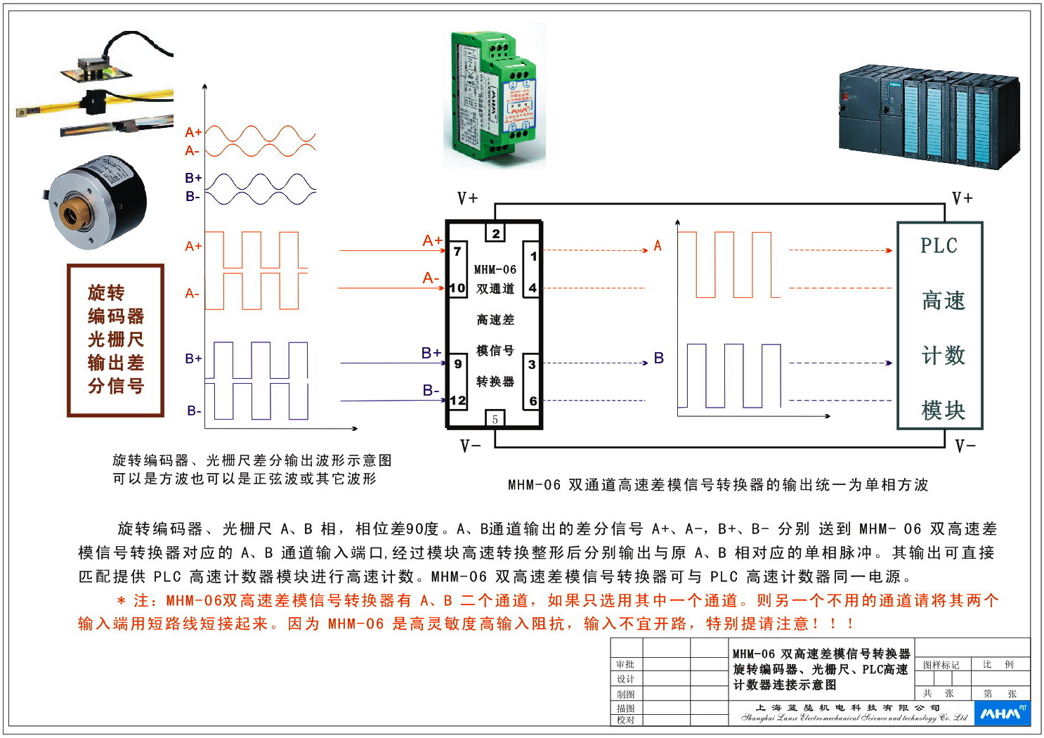

ÔõÑù½â¾ö£Ð£Ì£Ã¸ßËÙ¼ÆÊýÆ÷µÄ¼ÆÊýÎó²î·¢Éú
____ÔÚÓ¦ÓÃPLC¸ßËÙ¼ÆÊýÆ÷ʱÍùÍù»áÅöµ½ÈçÏÂһϵÁÐÎÊÌ⣬¸ßËÙ¼ÆÊýÆ÷ÓëÊäÈë¼ÆÊýÂö³åÐźŵÄÂö³åµçƽ²»Æ¥Åä¡£ÈçÐýת±àÂëÆ÷¡¢¹âÕ¤³ßÊý¾ÝÊä³öÊÇTTLµçƽ£¬¶øPLC¸ßËÙ¼ÆÊýÆ÷Ϊȷ±£¹¤ÒµÏÖ³¡µÄ¸ß¿¹¸ÉÈÅÐÔÄÜ£¬È´ÒªÇó½ÓÊܵÄÊÇ0 - 24v´«ÊäÂö³åÐźš¢ÓÖÓеıàÂëÆ÷ΪÁËÌá¸ß±àÂë¿É¿¿ÐÔ£¬ÌṩA+¡¢A-£¬B+¡¢B-£¬Z+¡¢Z- ¶Ô³Æ·´ÏàµÄ±àÂë¼ÆÊýÂö³å»òÕßÊÇÌṩA+¡¢A-£¬B+¡¢B-£¬Z+¡¢Z- ¶Ô³Æ·´ÏòµÄÕýÏÒʸÁ¿²î·Ö¡¢²îÄ£Ðźţ¬µ«PLC¸ßËÙ¼ÆÊýÆ÷ÒªÇó½ÓÊÕµÄÊǵ¥Ïà¼ÆÊýÂö³å¡£¶øÊ¹ÓÃÕßÒòΪûÓÐÑ¡Ôñµ½ºÏÊʵÄת»»½Ó¿Ú¶ø·ÅÆúÁËÆäÖÐÒ»Ïࣨ±àÂëÆ÷±¾ÒòΪҪÌá¸ßϵͳ¹¤ÒµÏÖ³¡¿¹¸ÉÈÅÄÜÁ¦£¬¶øÌṩµÄË«Ïà¼ÆÊýÂö³åÐźţ©½øÐмÆÊý¡£
____ÓÖÈçÔÚÓ¦ÓÃÐýת±àÂëÆ÷¡¢¹âÕ¤³ßµÄ³¡ºÏ²¢·Çµ¥·½ÏòÔÈËÙÔ˶¯£¬ÆäÔ˶¯ËÙ¶ÈÊÇʱ¿ìʱÂý¡¢Ê±¶¯Ê±¾²Ö¹¡¢Ê±Õýʱ·´µÄ²»È·¶¨ÐÔ¡¢»òÕßÔÚÔ˶¯Ëٶȷdz£µÍµÄ³¡ºÏ£¬Èç¹û½Ó¿ÚûÓÐÆ¥Åä´¦ÀíºÃÊǷdz£ÈÝÒ×·¢Éú¼ÆÊýÎó²îµÄ¡£»¹ÓÐÂö³åÊý¾Ý´«Êä¾àÀëÉÔ³¤Ð©£¬Âö³å´«Êä¹ý³ÌÖлá²úÉúÂö³å²¨ÐÎÆæ±ä¡£
ÓÐÐí¶àÓ¦Óó¡ºÏËäÈ»¼ÆÊýÂö³åƵÂʲ»¸ß£¬¶øºöÂÔÁËPLC¸ßËÙÂö³å¼ÆÊýÆ÷¶Ô¼ÆÊýÂö³åµÄǰºóÑØ¿ÚÊÇÓÐËÙÂÊÒªÇó£¨Âö³åÐγɵÄÉÏÉý¡¢Ï½µÑØ¿ÚÏìÓ¦ËÙ¶ÈÒª¶¸ÇÍ£©£¬ÓÈÆäÊÇÔÚÓ¦ÓÃÏßÊý±È½Ï¸ßµÄ±àÂëÆ÷ÔÚµÍËÙÔËÐÐʱ£¬ÓÉÓÚ»úеÔ˶¯±ØÈ»²úÉúϸ΢¶·¶¯»òÕß±àÂëÆ÷ǰ¼¶°²ÓбäËÙ³ÝÂÖ£¬¾ÍºÜÈÝÒ×»áÒýÆð±àÂëÂö³åǰºóÑØ¿ÚÉϳöÏÖ¾â³Ý¿Ú¡£»¹Óг¤ÆÚ»úеÔ˶¯²úÉú»úеĥËð£¬Ê¹¼ä϶±ä´óÒ²»áÒýÆð±àÂëÂö³åǰºóÑØ¿ÚÉϳöÏÖ¾â³Ý¿Ú¡£
ÔÚ¹¤ÒµÏÖ³¡µÄ¸ÉÈÅÊÇ´í×Û¸´Ôӵģ¬ÓÉÀ´×Ô¿ØÖÆÏÖ³¡Èçµç¶¯»úµÄÆô¶¯Í£Ö¹¡¢´óµçÁ÷½Ó´¥Æ÷µÄÇл»¡¢µç´Å·§¿ª¹Ø¡¢¿É¿Ø¹èµÄµ÷Ïà¸ÉÈÅ¡¢µç»¡µçÂö³å¡¢µç´Å²¨µÈµÈ¸´ÔӵĸÉÈÅȺ£¬ÄÇ×ÝÏòºÍºáÏòµç´Å¸ÉÈÅÊÇÂÞÁв»Íê¡£
____ÎÊÌâ×îÖÕ×ۺϷ´Ó³ÔÚ¼ÆÊýÂö³åÉÏ£¬²úÉúÁ˼ÄÉúë´ÌÐźŻò¼ÄÉú¸ÉÈÅÂö³å£¬¼ÄÉúë´ÌÂö³åÈç¹ûûÓеõ½ÓÐЧµÄ¶ôÖ¹ÕûÐΡ£ËùÒÔ±ØÈ»»áµ¼ÖÂPLC¸ßËÙ¼ÆÊýÆ÷µÄ¼ÆÊý¾«¶È²»Îȶ¨¡¢²»¿É¿¿¡¢²úÉúÀÛ¼ÆÎó²î¡¢¾­³£»áÅöµ½Å¼·¢ÐԵļÆÊý³ö´íµÈһϵÁÐÎÊÌâ¡£
____ËùÒÔÐí¶à²¿¼þÔÚʵÑéÊÒ×öÄ£ÄâÊÔÑéʱÊÇÍêºÃÎÞÎóµÄ£¬¶øÒ»µ©µ½Á˹¤ÒµÏÖ³¡È´³öÏÖÖÖÖÖ²»Õý³£µÄÏÖÏó¡£ÕâÍùÍùÊÇÒòΪºöÂÔÁËϵͳÉè¼ÆµÄÕûÌå¸ÅÄ¸÷¸öϵͳÓëϵͳ֮¼äµÄ²»Æ¥ÅäËù²úÉúµÄϵͳÐÔ¸ÉÈÅ¡£Ëü»áÖ±½ÓÓ°Ïìµ½PLC¿ØÖƾ«¶È£¬Ê¹µÃÔ­±¾ÎªÁËÌá¸ß¿ØÖƾ«¶È¶øÉèÖõŦÄÜ£¬È´·¢»Ó²»Á˱¾¸ÃÌá¸ß¾«¶ÈµÄЧ¹û¡£¼´ÀíÂÛÉè¼Æ¾«¶ÈÓëʵ¼ÊµÃµ½µÄЧ¹û²î¾àÉõÔ¶¡£ÓÐʱÎóÈÏΪPLC¸ßËÙ¼ÆÊýÆ÷ÖÊÁ¿ÓÐÎÊÌâ¡¢±àÂëÆ÷ÓйÊÕÏ¡¢ÂëÅÌÏßÊý»¹²»¹»¶à¡­¡­¡£ÇÒûÓÐÕÒµ½ÎÊÌâµÄÕæ¼£Ô´Í·ÔÚÄÄÀï¶øÎÞ´Ó×ÅÊÖ£¬Ò²Ã»ÓвÉÈ¡ÓÐЧ¿Ë·þ´ëÊ©»òÕßûÓÐÕÒµ½ÓÐЧµÄ¿Ë·þ¸ÉÈŵķ½·¨¡£
____Ϊ´ËÎÒÃÇÕë¶ÔÕâЩÔÚ¹úÄÚµçÆøÏµÍ³¡¢¹¤Òµ×Ô¶¯»¯¿ØÖÆÏµÍ³ÆÕ±é´æÔÚ¶øÓÖ³£¼ûµÄÓй²ÐԵļ¼ÊõÎÊÌ⣬רÞ«ÐıÈÕÕ·ÖÎö£¬Ñо¿ÁËÐí¶à¹úÍâÒý½øµÄ´óϵͳ¼¯³ÉÏîÄ¿£¬×Ô¶¯»¯¿ØÖƳ̶ȱȽϸߵıȽϾ­µäµÄ¿ØÖÆÏµÍ³Ê±¡£·¢ÏÖÓÐÐí¶àÊdz£±»ÎÒÃÇÉè¼ÆÊ¦ËùºöÂÔµÄϸ½Ú£¬ÍùÍùÈÏΪÊÇ¡°¶àÓࡱµÄ»òÕßÊÇÈÏΪ¿ÉÒÔ¡°½ÚÊ¡¡±¿ªÏúµÄ²¿¼þ£¬ËƺõÄÇЩ½Ó¿Ú¼þÈ¥µôÕÕÑù¿ÉÒÔ¹¤×÷¡£ÓÈÆäÊÇÔÚµ±Ç°Êг¡¾ºÕù°×ÈÕ»¯£¬±È¼Û¾ºÕùΪ¾º±êÊ×Ñ¡¡£ËùÒÔ³£³£ÊÇÔÚÉè¼ÆÊ±´Ó³É±¾½Ç¶È¿¼ÂDZ»¡°¾«¼ò¡±µôÁË¡£ÍùÍù»áÐγɹú²ú»¯ÏµÍ³²»ÄÍÓÃÊǵ±È»µÄ£¬ÆäʵÖÊÔ­Òò£¬ÎÊÌ⻹ÊÇÔÚ×ÔÉí¡£
____ÎÒÃǶÔÄÇЩ¿É¡°¾«¼ò¶àÓࡱ½Ó¿Ú²¿¼þ½øÐзÖÎöÑо¿ºóÓÖÔÚ¹¤ÒµÏÖ³¡ÊµµØÊÔÑéºó·½Öª,ËüÔÚ¹¹³ÉϵͳÕûÌ弯ºÏʱ´æÔڵıØÒªÐÔ£¬ºÍÑ¡ºÃ¶ÔӦƥÅäµÄ½Ó¿Ú,ÊǶÔϵͳ³¤ÆÚÎȶ¨ÔËÐеĿɿ¿±£ÕÏ¡£ÓÈÆäÊǾ«È·¶ÈÒªÇó±È½Ï¸ßµÄ»úеµçÆøºÏÒ»µÄÊý¿ØÏîÄ¿ÖÐÓÈÎªÖØÒª¡£
____Ϊ´ËÎÒÃÇÒý½øÁËÏȽø¶øÓÖ³ÉÊìµÄ½Ó¿Ú¼¼Êõ£¬ÎüÊÕÏû»¯ÁËÐí¶àÕë¶ÔÐÔϸ½ÚµÄ´¦Àí·½·¨¡£×¨ÃÅÉè¼ÆÁ˰ë¹ú²ú»¯µÄMHM-02A/BÐÍË«¸ßËÙ¹âÕ¤¸ôÀëñîºÏÆ÷½Ó¿ÚÄ£¿éºÍMHM-06Ë«¸ßËÙ²îÄ£ÐźÅת»»Æ÷½Ó¿ÚÄ£¿é£¬¶øÇÒ·Ö±ð»¹ÓжàÖÖÊäÈë¡¢Êä³ö·½Ê½½Ó¿ÚÄ£¿é£¬¿ÉÒÔÂú×ã¹úÄÚÍâÏÖÓи÷ÖÖÐÎʽµÄPLC¿ØÖÆÆ÷µÄÒªÇó¡£ËüÒѾ­ÔÚÐí¶àPLCÊý¿ØÏµÍ³ÉÏ£¬ÓÈÆäÊÇÔÚÄÇЩ¡°ÎÊÌâϵͳ¡±ÉÏ¡¢ÔÚÀÏϵͳ½øÐÐÊý¿Ø¸ÄÔìÏîÄ¿ÉÏ£¬Êµ¼ÊÓ¦ÓÃÖеõ½ÁËÑéÖ¤¡£Ê¹¿ØÖƾ«¶ÈÓзdz£ÏÔÖøÌá¸ß£¬Ê¹ÀíÂÛÉè¼Æ¾«¶ÈÓëʵ¼ÊµÃµ½µÄЧ¹ûÍêÈ«ÎǺϡ£µÄÈ·ÊÇ¡°¶à¡±¶ø²»¡°Óࡱ£¬×ÅʵÄܽâ¾öµôÎÊÌ⣬Æðµ½Ê°빦±¶Á¢¸Í¼ûÓ°µÄЧ¹û¡£´Ó¶øÔÙ»ØÊ×·¢ÏÖ¹ú¼ÊÉÏÐí¶àÖøÃûÆ·ÅÆµÄ²úƷΪʲôºÍÎÒÃǵÄͬÀà²úÆ·Ïà±È»áÓÐÏ൱µÄ²î¾àÄØ£¿Ï¸Ï¸±È½ÏÎÒÃǵÄÈ·ÊǰÑÖªÆäËùÒÔ£¬¶ø²»ÖªÆäËùÒÔÈ»µÄ¾«»ª¸øºöÂÔµôÁË¡£
