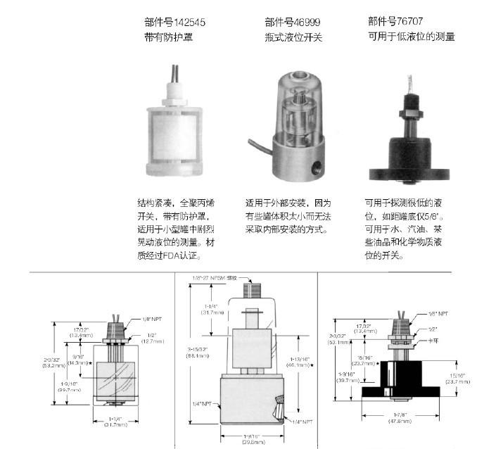

                  LS-3Һλ¿ª¹Ø
LS-3Ìṩ¸ß¿É¿¿ÐÔ¡¢½ô´ÕÐ͵ͳɱ¾µÄNPTÂÝÎÆ¡¢Ö±ÂÝÎÆºÍ¹«ÖÆÂÝÎÆ¿ª¹Ø
¶ÔÓÚdz¹Þ»ò¿Õ¼äÏÞÖÆµÄ£¬»òÈκεͳɱ¾¡¢´óÅúÁ¿µÄÓ¦ÓÃÊ®·ÖÀíÏë¡£
LS-3ϵÁпÉÒÔÌṩFDAÈÏÖ¤µÄ²ÄÖÊ£¬ÏêÇéÇëÏòGEMS²éѯ¡£

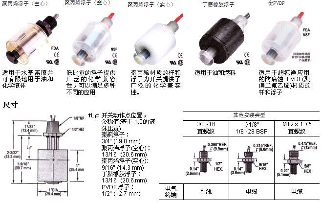

ͨÓùæ¸ñ
µçÆøÁ¬½Ó
No.22 AWG£¬24" L.£¬PVCÒýÏß¡£BSPºÍ¹«Öư²×°£ºPVC»¤Ì×2оNo.22 AWGµçÀ¡£
PVDF²ÄÖʲúÆ·
No.22AWG£¬FEPÌØ·ú¡»¤Ì×£¬24"¡«26"
ÈÏÖ¤
U.L.ÈÏÖ¤-ÎļþºÅE45168£»CSAÈÏÖ¤-ÎļþºÅ30200¡£ÈçÐèÒª£¬¿ÉÌáCEÈÏÖ¤
SPST¿ª¹Ø
20VA£¬120-240 VAC¡£³ý·ÇÁí×÷˵Ã÷£¬·ñÔò·¢»õʱ¿ª¹Ø×´Ì¬Îª³£¿ª¡£¿Éͨ¹ý¸Ä±ä¸¡×ÓÔÚ¸ËÉϵÄλÖÃÔÚN.O.£¨³£¿ª£©ºÍN.C.£¨³£±Õ£©Ö®¼ä½øÐÐÑ¡Ôñ

²ÄÖÊ
×îСҺÌå±ÈÖØ
ѹÁ¦psi/bar
¹¤×÷ζÈ
°²×°ÀàÐÍ
²¿¼þºÅ
¸ËºÍ°²×°¼þ
¸¡×Ó
¾Û·¯
¾Û·¯
0.75
50/3
-40¡«107¡æ
£¨-40¡«225¨H£©
1/8¡åNPT
42295
¾Û±ûÏ©
¾Û±ûÏ©£¨¿ÕÐÄ£©
0.60
50/3
-40¡«107¡æ
£¨-40¡«225¨H£©
1/8¡åNPT
142505
3/8¡å-16
171517
-40¡«80¡æ
£¨-40¡«176¨H£©
G1/8¡å-28
171518
M12¡Á1.75
189739
¾Û±ûÏ©£¨ÊµÐÄ£©
0.90
150/10
-40¡«66¡æ
£¨-40¡«150¨H£©
1/8¡åNPT
116826
3/8¡å-16
171514
-40¡«80¡æ
£¨-40¡«176¨H£©
M12¡Á1.75
189787
ÄáÁú
¶¨ëæÏð½º
0.45
150/10
-40¡«121¡æÓÍ
£¨-40¡«250¨HÓÍ£©
1/8¡åNPT
162745
-40¡«80¡æ
£¨-40¡«176¨H£©
M12¡Á1.75
189786
PVDF
PVDF
0.86
50/3
-40¡«121¡æ
£¨-40¡«250¨H£©
1/8¡åNPT
173250
 ÌØÊⳡºÏÓ¦ÓõÄLS-3ϵÁвúÆ·
ÌØÊâLS-3²úÆ·¶©¹ºÖ¸ÄÏ
²ÄÖÊ
È«¾Û±ûÏ©£¨°üÀ¨±£»¤ÕÖ£©
¾Û·¯
È«¾Û·¯£¨°üÀ¨¿¨»·£©
 Ö÷ÌåºÍµ××ù
 ¸¡×Ó
¾Û±ûÏ©£¨¹Ì̬£©
¾Û·¯
¶¨ëæÏð½º
ÆäËû½ÓÒº²¿¼þ
»ÆÍ­¡¢ÂÁ¾Û̼Ëáõ¥¡¢ÂÁ¡¢Viton A
»·Ñõ²ÄÁÏ
×îСҺÌå±ÈÖØ
0.9
0.75
¹¤×÷ζÈ
-40¡«121¡æ
£¨-40¡«250¨H£©
-40¡«121¡æ
£¨-40¡«250¨H£©
-40¡«121¡æ
£¨-40¡«250¨H£©
×î´óѹÁ¦£¬PSI
150
¿ª¹Ø£¬SPST
20VA,N.C/N.O ¸É**
20VA,N.C ¸É
µçÆøÁ¬½Ó
NO.22AWG,22¡åL,
PVCÒýÏß
NO.22AWG,72¡åL,¾ÛºÏÎïÒýÏß
NO.22AWG,72¡åL,PVCÒýÏß
Ñ¡ÐÍÐͺÅ
142545
´ø·À»¤ÕÖ
46999
ƿʽҺλ¿ª¹Ø
76707
µÍҺλ²âÁ¿
£ª£ªNO»òNCÁ½ÖÖ¿ª¹Ø¹¤×÷·½Ê½¿ÉÑ¡£¬Ö»Ðèת»»Ò»ÏÂÄÚ²¿µÄ¸¡×Ó¼´¿É¡£
