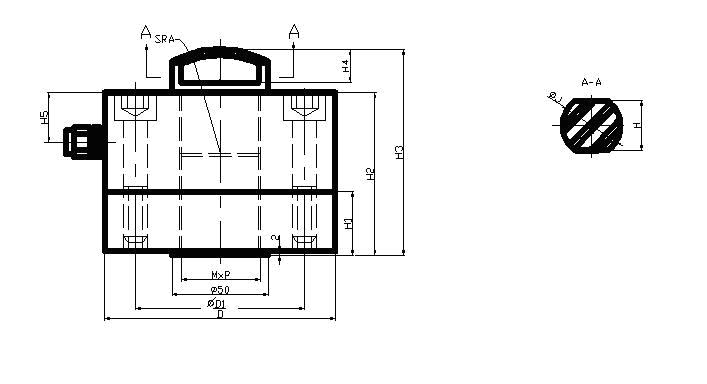

             LFSCÂÖ·øÊ½³ÆÖØ´«¸ÐÆ÷
²úƷ˵Ã÷:
1.ÍâÐεͣ¬¿ÉÒÔ³ÐÊܴܺóµÄ²àÏòÁ¦
2.½á¹¹¼òµ¥£¬°²×°·½±ã£¬ »¥»»ÐÔºÃ
3 ÔÚÔØºÉ×÷ÓÃϵ¯ÐÔÌåµÄÌå»ý±ä»¯Ð¡£¬¹Ê¾ßÓÐÓÅÁ¼µÄ×ÔÈ»ÏßÐÔ¶È
4  ¿É·½±ãµÄÉè¼ÆÎªÀ­¡¢Ñ¹Á½Óô«¸ÐÆ÷
ÍâÐͳߴ磺
Á¿³Ì£¨t£©
D
M¡ÁP
H1
H2
H3
H4
H5
H
¦µJ
D1
2,3
¦µ105
M14¡Á2
25
70
85
10
22.5
20
¦µ25
90
5
¦µ120
M20¡Á1.5
30
80
95
10
25
25
¦µ30
140.5
10,20
¦µ155
M32¡Á2
35
90
115
15
27.5
35
¦µ45
133
ÐÔÄܲÎÊý
¶î¶¨ÔغÉ
2,3,5,10 ,20t
ÁéÃô¶È
2.0¡À0.002 mV/V
×ÛºÏÐÔÎó²î
¡À0.03£¨2,5t£©,¡À0.10£¨10t£©%FS
Èä±ä£¨30·ÖÖÓ£©
¡À0.03%FS
Áãµãƽºâ
¡À1%FS
ÁãµãζÈÓ°Ïì
¡À0.02%FS/10¡æ
Êä³öζÈÓ°Ïì
¡À0.02%FS/10¡æ
ÊäÈë×迹
400¡À10¦¸£¨ohms£©
Êä³ö×迹
352¡À2¦¸£¨ohms£©
¾øÔµµç×è
¡Ý5000M¦¸
¹¤×÷ζȷ¶Î§
-30~70¡æ
°²È«¹ýÔØ
150%FS
¼«ÏÞ¹ýÔØ
300%FS
ÍÆ¼ö¼¤Àøµçѹ
10~12VDC
×î´ó¼¤Àøµçѹ
15VDC
ÃÜ·âµÈ¼¶
IP67
²ÄÖÊ
ºÏ½ð¸Ö
µçÀÂ
Length:12m Diameter:¦Õ6mm
½ÓÏß·½Ê½£º
       Exc+£¨Red,ºì£©
         Exc-£¨Black,ºÚ£©
         Sig+£¨green,ÂÌ£©
         Sig-£¨White,°×£©
