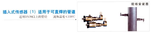

¸Ö¡¢²»Ðâ¸Ö¡¢ÖýÌú¡¢Ë®Äà¹Ü¡¢Í­¡¢PVC¡¢ÂÁ¡¢²£Á§¸Ö¡¢Ó²ÖʽðÊôËÜÁϵȡ¢ÔÊÐíÓгÄÀï
Ö±¹Ü¶Î
´«¸ÐÆ÷°²×°µã×îºÃÂú×㣺ÉÏÓÎ10D£¬ÏÂÓÎ5D£¬¾à±Ã³ö¿Ú30D£¨DÊÇÖ¸¹Ü¾¶£©
