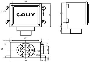

ÌØµã
1.ÄÍÓÃÐÍѹÁ¦¡¢Õæ¿Õ¡¢Ñ¹²î¿ª¹Ø
2.1/4" or 1/2" NPTÁ¬½Ó
3. Ä͸ßÎÂÉè¼Æ£¬×î¸ß¿É´ï400¡æ
4. »·Ñõ»ùÊ÷Ö¬ÖýÂÁÍâ¿Ç,Éè¼ÆÂú×ãNEMA 4 X/IP 65µÄÒªÇó
Ó¦ÓÃ
Ë®±Ã¡¢Ñ¹Ëõ»ú£»»¯¹¤³§ºÍÁ¶Óͳ§£»¹©Ë®¼°ÎÛË®´¦Àí£»¸ÖÌú³§¡¢µç³§¡¢ÂÁ³§£»ÊäÓ͹ܵÀ£»ÆøÌ建³åϵͳ£»´¢¹Þ¼°Ñ¹Á¦±Ã£»Ñ¹Ëõ»úºÍÆûÂÖ»ú£»ÆäËûÖڶ๤ҵ¹ý³ÌºÍÉ豸µÄÀíÏë±£»¤¡£
¼¼Êõ²ÎÊý
»·¾³Î¶È
-40¡æ to 75¡æ
»·¾³Êª¶È
5% - 95%
ѹÁ¦½Ó¿ÚÄÍÎÂ
ÆÕͨ£¨Ð¡ÓÚ80¡æ£© ÖÐΣ¨Ð¡ÓÚ150¡æ£© ¸ßγä¹èÓÍ£¨Ð¡ÓÚ400¡æ£©
ÖØ¸´¾«¶È
¡À 1%
Íâ¿Ç
È«ÖýÂÁÍâ¿Ç£¬Íâ±íÅçÍ¿»·ÑõÊ÷Ö¬
·À±¬ÐÍ
·À±¬µÈ¼¶DIICT6
ѹÁ¦½Ó¿ÚÖʲÄ
²»Ðâ¸Ö
ѹÁ¦½Ó¿Ú³ß´ç
1/2" NPT(female)»ò1/4" NPT(female)
µçÆø½Ó¿Ú³ß´ç
G3/4"(female)
½ÓµãÈÝÁ¿
15A 125/250/480 VAC£»0.5A 125DC£»0.25A 250DC
