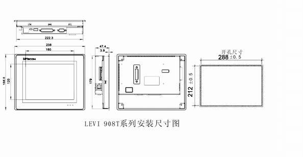

ÍâÐγߴç
299¡Á222¡Á54mm
°²×°¿ª¿×³ß´ç
288¡Á212mm
