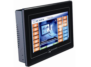

²úÆ·Ãû³Æ£º TK6070iH
ÐÍ ºÅ£º TK6070iH
  ²ú Æ· ÖÐ ÐÄ
TK6070iH
·¢²¼Ê±¼ä£º2011-1-18 10:00:55 ·ÃÎÊ´ÎÊý£º327
ÐͺÅ
TK6070iH
ÏÔʾҺ¾§Ãæ°å
7" TFT LCD
ÁÁ¶È
350 cd/m2
É«²Ê
65,536 colors
¶Ô±È¶È
500:1
·Ö±æÂÊ (WxH dots)
800 x 480
±³¹âµÆ
LED
´¥ÃþÃæ°å
4ÏßÄ£Äâµç×èʽ
I/OͨѶ¿Ú
COM1 RS232, COM2 RS485 2W/4W
USB
USB Client port x 1
´¦ÀíÆ÷
32bit RISC CPU 400MHz
Flash ´æ´¢Æ÷
128MB
RAM
64MB DDR2 RAM
ʵʱʱÖÓ
ÄÚ½¨
ͨÓùæ¸ñ
ÊäÈëµçÔ´
24¡À20% VDC  (ÄÚ½¨µçÔ´¸ôÀëÆ÷)
´¢´æ»·¾³Î¶È
-20~60¡ãC (-4 ~ 140¡ãF)
ʹÓû·¾³Î¶È
0~45¡ãC (32 ~ 113¡ãF)

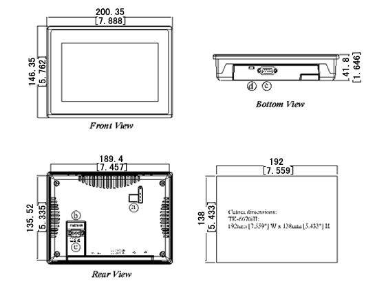

ÍâÐγߴç WxHxD
200 x 146 x 41.8mm
¿ª¿×³ß´ç WxH
192 x 138 mm (7.5"x5.4")
ÖØÁ¿
Approx. 0.8 kg (1.76 lbs)
±à³ÌÈí¼þ
±à³ÌÈí¼þ
EB8000 V4.3.4 »òÕ߸üÐÂ
