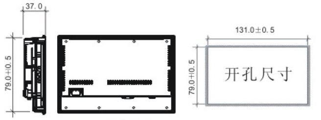

ÍâÐγߴç
138.0¡Á86.0¡Á37.0mm
°²×°¿ª¿×³ß´ç
131¡Á79mm
